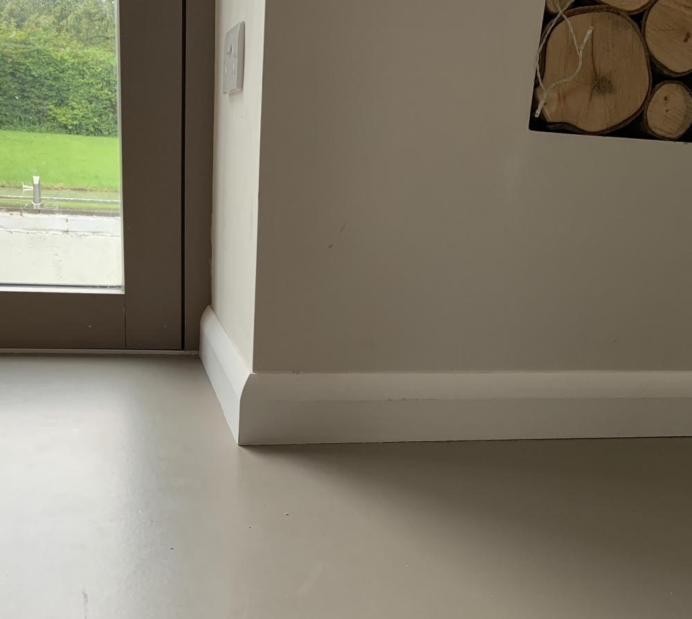

Bitpipe Posted August 16, 2019 Posted August 16, 2019 We toyed with shadow gaps but they come with a surprising cost due to the time taken to get the detailing correct. Also not a fan of skirting boards but we went with a tapered profile thats only a few mm wide at the top so they look neat and collect minimal dust. http://skirtingonline.co.uk/epages/www_skirtingonline_co_uk.sf/en_GB/?ObjectPath=/Shops/www_skirtingonline_co_uk/Products/rou-18-4200-33/SubProducts/rou-18-4200-33-0001 Ours have a water based matt gloss finish and 3 years on look pretty much as they did new.

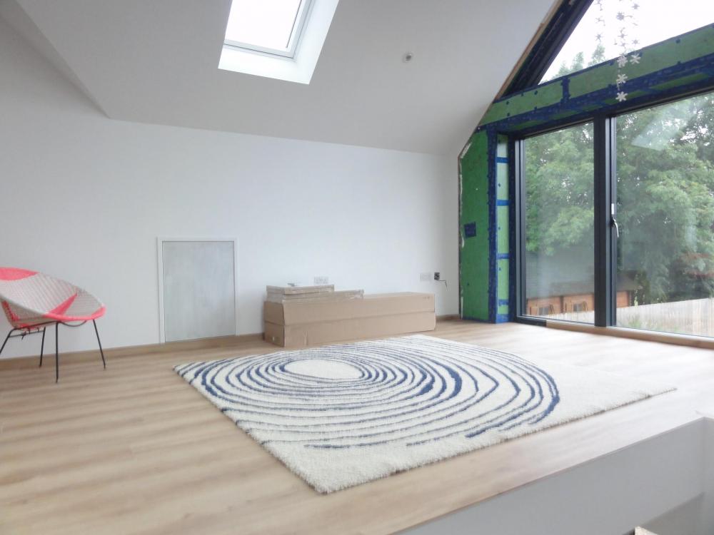

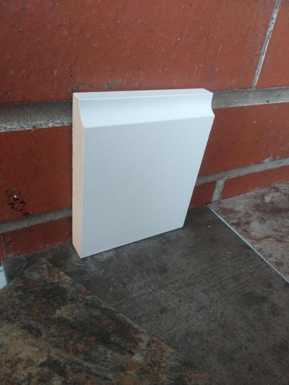

ultramods Posted August 16, 2019 Posted August 16, 2019 I went for a 12mm thick mdf skirting with pencil profile painting in eggshell white like this: https://skirtingboardsdirect.com/products/mdf-pencil-round-skirting-boards-12mm-thick/ Speak to your joiner but you could maybe go for 60-90 mm in height which wouldn't be very noticeable. I find the white eggshell helps the skirtings blend into the white walls. I will add a photo later on today. 1

Ralph Posted August 16, 2019 Posted August 16, 2019 On 16/08/2019 at 10:16, canalsiderenovation said: Bigger skirting just equals more painting and IMO actually drawing attention too it! ? Have you gone for a maintenance free option? Any suggestions? Expand Apparently the pre-finished MDF is pretty maintenance free and it's quite cheap and simple so I can see us going for that.

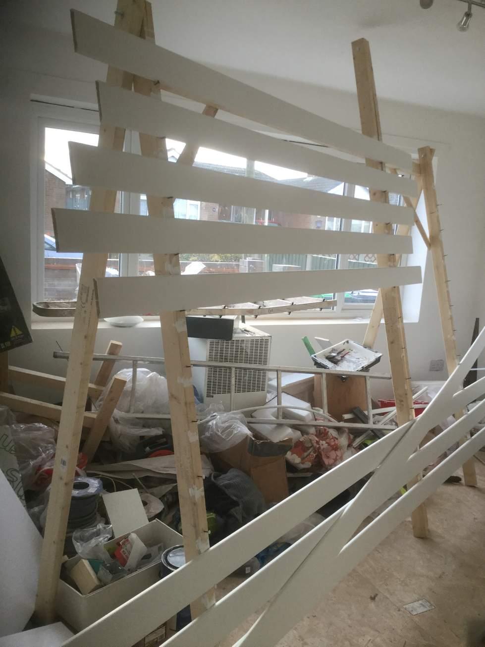

Barney12 Posted August 16, 2019 Posted August 16, 2019 I went for a 60mm high pencil profile. Its the same for the architraves as the skirting which IMHO gives a nice contemporary look. I bought primed MDF and then site sprayed it all with precat lacquer in the same white (RAL9016) as the Internorm windows. This was incredibly labour intensive! It took me a week to prep (every nail hole, nick and mitre filled and sanded), masking up another week and probably another week to prime and apply 3 top coats. It should be pretty much maintenance free for a good number of years. If you had to pay a company to spray I suspect it would be prohibitively expensive.

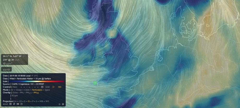

SteamyTea Posted August 16, 2019 Posted August 16, 2019 On 16/08/2019 at 12:06, canalsiderenovation said: I think the wood burner makes dust worse and as it's our current only form of heating as the oil heating knackered last year we are using it a lot Expand Are you not concerned about the health risks. A 10 quid panel heater would be better, and probably cheaper to run.
j_s Posted August 16, 2019 Posted August 16, 2019 We used matt endurance paint on the latest renovated rooms skirting (made out of tulip/poplar) Before the endurance we used a paint made by ecopaints (now called something else) and it has a sheen to it even though it's a matt paint, washable too. Dustier looking but I hate painting on anything else other than your typical wall/ceiling paint
canalsiderenovation Posted August 16, 2019 Author Posted August 16, 2019 (edited) On 16/08/2019 at 12:19, SteamyTea said: Are you not concerned about the health risks. A 10 quid panel heater would be better, and probably cheaper to run. Expand Nope, we have an endless supply of seasoned wood currently as when we moved in bunkers were full and we have a wood too and a there were numerous felled trees. On the canal the cottages opposite are on solid fuel too (though again seasoned wood mainly, it's always available on the canal) and that's without the narrowboats going past so if I was worried on health risks I've picked the wrong house!. We will keep the wood burner but our main heating will be ASHP when the renovation is done. Edited August 16, 2019 by canalsiderenovation
