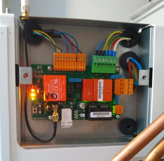

TerryE Posted August 3, 2019 Share Posted August 3, 2019 The back story here is that I was one of the SunAmp early adopter buying and self-installing 2×SunAmp PVs rigged in parallel and heated by mains E7 electricity. I have been very happy with the product and I did not see the need to change to the UniQ range as I expected at least a 10-year operating life. A couple of day ago, Jan noticed that the HW isn't running too hot at the mo. Checking through my HA data logs, one of the SunAmps failed about 10 days ago, and cooled down over a couple of days. So we were mixing roughly 50:50 60°C:20°C into our HW manifold -- which is at about the temp we shower at in our warm climate, hence our not noticing. So I opened up the unit and did some diagnostics. The line through the inline heater and thermal cut out is reading 18Ω which is nominal for 240V 3 kW heater, so this isn't a heater failure. The two thermistors register the same resistance; I don't know what the part no is but since they are within 1% of each other, I suspect that they are fine. Power is arriving correctly to the control board, but and it seems to be sequencing the pump fine. It just that the 12A 240V heater O/P isn't turning on. So I suspect that the power relay has died and since this a soldered-on component then it is time for a controller board change, IMO. So Q for @Nickfromwales, @JeremyR etc. do you have a SunAmp contact that I can discuss getting a now controller board from. Overall I am impressed by the internals of the unit apart from a few quibbles and one more serious concern. The quibbles are about the layout of the pipe runs in the head -- for example replacing the inline heating element would be a pig to do -- but this is the sort of issue that could be expected from early iterations of the product. My greater concern is the controller board design. There seems to be what I would regard as inadequate isolation between the 240V and low voltage areas on the board. Not good. They've also seemed to have use the same budget relay for switching the pump and the heater. Even though many of these units are nominally rated to switch up to 12A at 240V, this is at the limit of their operating range. Switching AC at the power is really hard on the relay contacts and so these tend not to have a good operating life. Whilst this might be acceptable in a low cost easily replaceable unit, it is not in the critical control board of an expensive piece of kit. Jeremy and I have discussed off-the-self vs. self-built trade-offs but my concerns here are: What is the realistic life of such a board? How long will they be obtainable given that the product is past end-of-life? Will SA require some price prohibitive replacement cost / installation cost? I am loath to go to the hassle of replacing what seems to be excellent units because of design flaws in a controller board. My fallback would be to swap out the controller entirely and do my own control implementation but using a CE certified unit for the 240V switching, and that way I can get my local electrician to check over the 240V installation. Not my preferred route, but easily doable. Link to comment Share on other sites More sharing options...
Jeremy Harris Posted August 3, 2019 Share Posted August 3, 2019 @TerryEHave you checked the thermal switch on the heater block? This was a common failure point on early Sunamp PVs, mine failed and I had to replace it. The usual symptom is that the thing trips (can be reset by depressing the button in the centre of it, with the power off). If it keeps tripping then it probably needs replacing. Link to comment Share on other sites More sharing options...
TerryE Posted August 3, 2019 Author Share Posted August 3, 2019 (edited) 6 minutes ago, JSHarris said: Have you checked the thermal switch on the heater block? Yup I thought about that which is why I measured the resistance across the switch and the heater -- which gave 18Ω rather than open circuit, which would have been the case if the switch had tripped. Edited August 3, 2019 by TerryE 1 Link to comment Share on other sites More sharing options...
Jeremy Harris Posted August 3, 2019 Share Posted August 3, 2019 6 minutes ago, TerryE said: Yup I thought about that which is why I measured the resistance across the switch and the heater -- which gave 18Ω rather than open circuit, which would have been the case if the switch had tripped. Bugger, thought that might have been a quick win. The relay on the circuit board always seemed to arc a bit as it switched, so, as you suggest, that could be the failure. There's a diagnostic mode available on the circuit board, that sequences the four LEDs and does a self-test on the logic side, plus tests things like the ultrasonic flow sensor output. I'll try and see if I still have a copy of the instructions for entering the self-test mode. IIRC, the power relay is a standard part, so replacing it should be fairly straightforward. I have a feeling that the relays are all soldered to the control PCB though, rather than in sockets. Link to comment Share on other sites More sharing options...
TerryE Posted August 3, 2019 Author Share Posted August 3, 2019 1 minute ago, JSHarris said: I have a feeling that the relays are all soldered to the control PCB though, rather than in sockets. which why I prefer socketed or Din-mounted contactors. Line replaceable parts. As far as BITE goes, I see that the board has a couple of UART jacks as well as the SMS interface, so something should be possible, though I am not sure how it could self diagnose a relay failure. . Even having a test point to allow you to probe the relay demand inputs would be nice. Link to comment Share on other sites More sharing options...
TerryE Posted August 3, 2019 Author Share Posted August 3, 2019 (edited) I am not really comfortable poking around a PCB blind when it has 240V tracks on it Edited August 3, 2019 by TerryE Link to comment Share on other sites More sharing options...
Jeremy Harris Posted August 3, 2019 Share Posted August 3, 2019 17 minutes ago, TerryE said: I am not really comfortable poking around a PCB blind when it has 240V tracks on it I'd be inclined to just buy and fit a couple of new relays and see if that fixes it. Perhaps worth buying several spares, given that the postage is probably going to be a fairly significant part of the total price. FWIW, I tend to stick to well-known brand names when it comes to relays. Omron are generally pretty good. Link to comment Share on other sites More sharing options...

Jeremy Harris Posted August 3, 2019 Share Posted August 3, 2019 With luck they may still have our old Sunamp PV PCB, as when I sent it back I'm pretty sure they only wanted to examine the internals of the heat cells. Our Sunamp PV was still working perfectly when I sent it back, although I had replaced the thermal cut-out. Link to comment Share on other sites More sharing options...

Jeremy Harris Posted August 4, 2019 Share Posted August 4, 2019 Probably no reason why the PCB mounted relays in the Sunamp PV control board couldn't be replaced with remotely mounted SSRs. Most SSRs accept a wide range of input voltages, so there's a pretty good chance that they would switch OK with the signal that normally drives the electromechanical relays on the PCB. 1 Link to comment Share on other sites More sharing options...
