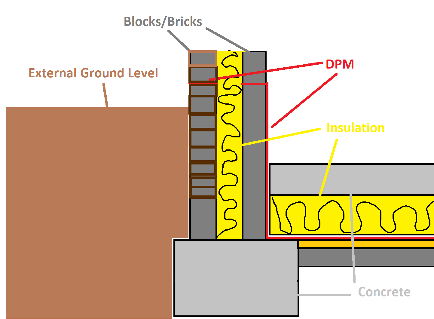

Ben100 Posted July 29, 2019 Author Posted July 29, 2019 For the time being I don't want to drop the entire site down 375mm and I'm not very keen on having a 375 trench around the extension either. My plan is to run the two rows of blocks and DPM up >150mm past the external ground level with cavity insulation, and just have the external ground level by the door dropped with some stairs. I'll add some french drains too for ground water, but it is a dry site with plenty of natural drainage already. Also, I'll increase the insulation in the slab. Something like this (not to scale).
Russell griffiths Posted July 30, 2019 Posted July 30, 2019 19 hours ago, Ben100 said: For the time being I don't want to drop the entire site down 375mm and I'm not very keen on having a 375 trench around the extension either. My plan is to run the two rows of blocks and DPM up >150mm past the external ground level with cavity insulation, and just have the external ground level by the door dropped with some stairs. I'll add some french drains too for ground water, but it is a dry site with plenty of natural drainage already. Also, I'll increase the insulation in the slab. Something like this (not to scale). That looks completely arse about face to me, so the outer leaf of brickwork is wet leading to the insulation being wet, nope, I would treat that like a mini basement, needs waterproofing on the outside, lapped down onto the footing. I personally would rather prevent water coming in than let it in partly and tank on the inside like you are proposing. 1
Jeremy Harris Posted July 30, 2019 Posted July 30, 2019 +1 ^^ Designing it as a mini-basement seems a good way to tackle this. Shouldn't be that complex a design, as the low perimeter walls of the "basement" section aren't seeing much inward force from the surrounding soil.
Mr Punter Posted July 30, 2019 Posted July 30, 2019 Where does the timber frame start? Looks like a fair amount of brick and block so far, so you may do better sticking with that. Maybe you could do timber frame kit for upper floor(s) and roof if you are keen on it. You may need to build solid below ground as this is retaining a reasonable amount. The small below ground bit makes this very awkward as you have extra issues with moisture, retaining soil and insulation bridging.
Onoff Posted July 30, 2019 Posted July 30, 2019 Your insulation isn't continuous between wall and floor. I think that will give potential cold bridging issues. Cleverer people will confirm.
Ben100 Posted August 1, 2019 Author Posted August 1, 2019 On 30/07/2019 at 08:09, Russell griffiths said: That looks completely arse about face to me, so the outer leaf of brickwork is wet leading to the insulation being wet, nope, I would treat that like a mini basement, needs waterproofing on the outside, lapped down onto the footing. I personally would rather prevent water coming in than let it in partly and tank on the inside like you are proposing. The insulation vendor states they have no issue with the insulation getting wet, but I understand your thoughts on that. I was thinking the same. If I was to run the DPM on the outside of the external brick facing wall can I just run it down to lap over the footings or would I need to run a continuous DMP through the footings and back under the slab? I've seen both examples when doing some research. My preference would be to run a DMP down from the external facing brickwork and lap the footings, then another DMP under the slab and into the internal blockwork.
Ben100 Posted August 1, 2019 Author Posted August 1, 2019 On 30/07/2019 at 11:52, Onoff said: Your insulation isn't continuous between wall and floor. I think that will give potential cold bridging issues. Cleverer people will confirm. Good point. A line of insulation between the slab and internal blackwork should resolve this.
Russell griffiths Posted August 1, 2019 Posted August 1, 2019 Your external dpc isn’t just a sheet against the building this just wouldn’t work, is a fully stuck on system, or painted on. Then a dimple mat against that to allow any moisture to run down to a drain rather than gather against the wall.
Ben100 Posted August 1, 2019 Author Posted August 1, 2019 1 hour ago, Russell griffiths said: Your external dpc isn’t just a sheet against the building this just wouldn’t work, is a fully stuck on system, or painted on. Then a dimple mat against that to allow any moisture to run down to a drain rather than gather against the wall. aha, ok, so tanking for example?
Russell griffiths Posted August 1, 2019 Posted August 1, 2019 34 minutes ago, Ben100 said: aha, ok, so tanking for example? Tanking is normally associated with internal, the same just a slightly different context. 1
Onoff Posted August 1, 2019 Posted August 1, 2019 2 hours ago, Ben100 said: Good point. A line of insulation between the slab and internal blackwork should resolve this. Don't think so. The "yellow" needs to be continuous with no break.
