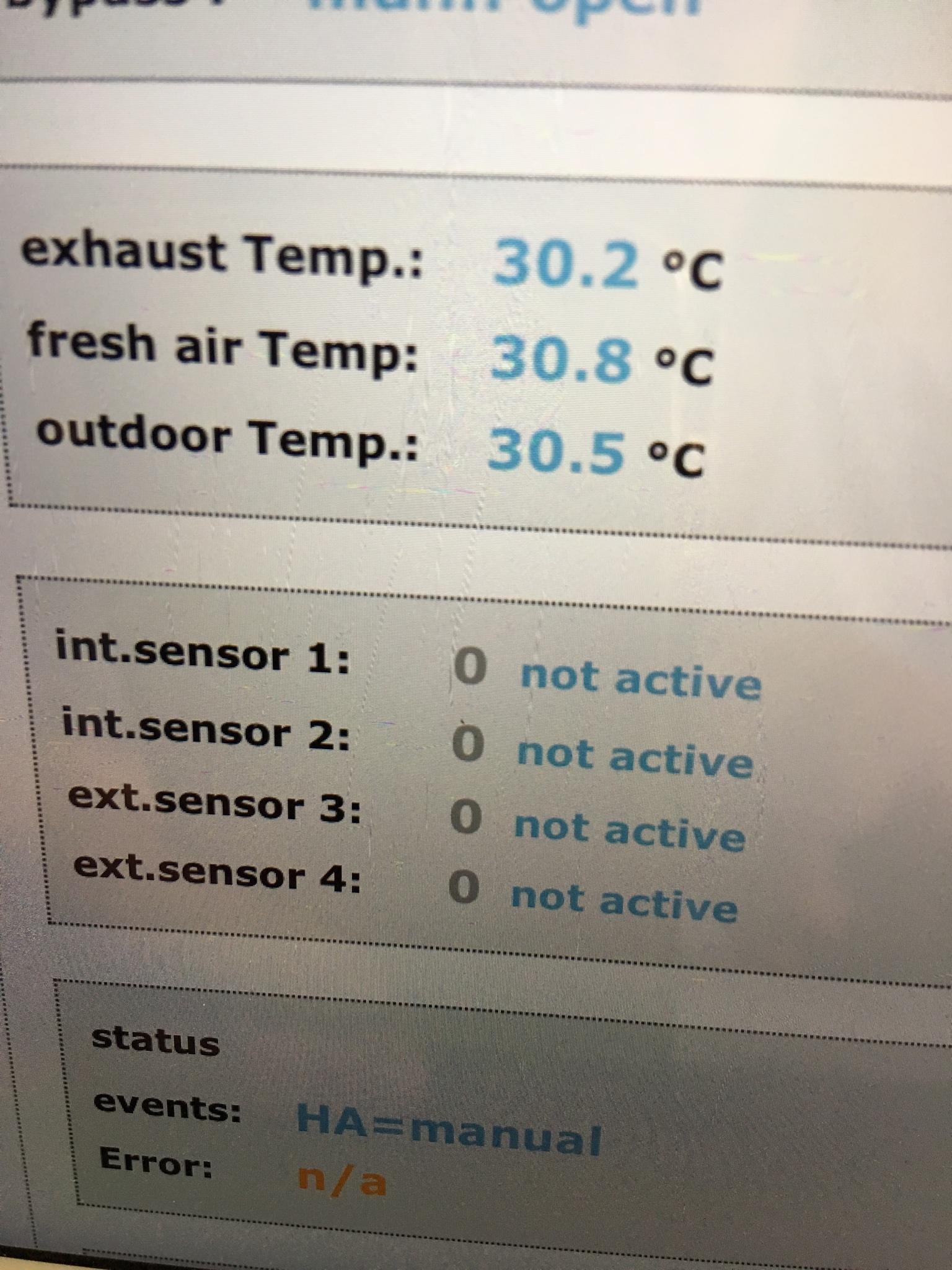

Temp Posted July 26, 2019 Share Posted July 26, 2019 (edited) I'm in Cambridgeshire where the weather men said it was 38c yesterday. Bedroom was 29C at 10pm. Felt cooler outside so i opened window and put a big oscillating fan on the sill. At midnight it was down to 27C. Fan ran all night blowing air in. Woke up about 6:30 to thunder and rain and stat says its 28C! We have mains pressure cold water at all taps. For last few days its been warm no matter how long you run it for. Edited July 26, 2019 by Temp Link to comment Share on other sites More sharing options...

lizzie Posted July 26, 2019 Share Posted July 26, 2019 From my photo memories, taken at 6.15pm on 26 July 2018. Going forward and with climate change I really think cooling/aircon should be something that gets as much consideration in the build as keeping warm. If I ever (bring on the white coats) do another I will have whole house aircon as well as mvhr etc. 1 Link to comment Share on other sites More sharing options...
Jeremy Harris Posted July 26, 2019 Share Posted July 26, 2019 7 minutes ago, lizzie said: Going forward and with climate change I really think cooling/aircon should be something that gets as much consideration in the build as keeping warm. I agree wholeheartedly. I know I bang on a bit here about the risk of overheating, and how solar gain is a significant problem for a well-insulated and airtight house, but that's because I've spent far, far more time and money trying to resolve overheating than I have on heating. Heating is a complete non-issue for us, if push came to shove a small fan heater in the hall would keep the whole house more than warm enough in cold weather. The reality is that we have to cool the house, either by passive means, like the solar reflective film and window overhangs, or by active means like floor cooling and air conditioning, for a far greater proportion of the year than we spend heating the house. Every time I see a new house design that has acres of glass, the thing that immediately springs to mind is the overheating risk that may pose. 1 Link to comment Share on other sites More sharing options...
ProDave Posted July 26, 2019 Share Posted July 26, 2019 Last night was probably the first in the 17 years we have been in the Highlands that it never really cooled down enough overnight for the night purge not to work very well. Bedroom was still 22.5 this morning. Downstairs, with the floor cooling been on all night, was down to 21 degrees. The ASHP has used 3KWh in the last 12 hours cooling, so has probably extracted about 9KWh of heat from the house. I did try reducing the water flow temperature to 16 degrees but then noticed a bit of condensation forming in the circulation pump, so put it back up to 18 degrees. This little spell has confirmed we need to fit fan coil units to the bedrooms for cooling, something I never thought we would need up here, though I may not get those done for this year. Link to comment Share on other sites More sharing options...
