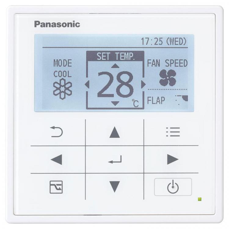

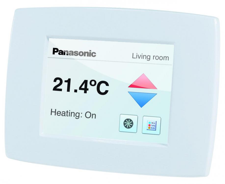

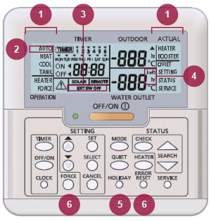

jack Posted August 3, 2019 Posted August 3, 2019 Simplicity of controls would be a big one. @ProDave, for example, has found his controls to be really user unfriendly. Ours are pretty poor too. Some brands have more expensive controllers available, which are allegedly easier to use. You could look at the pricing of those and report on what additional functionality they provide. Some recent ASHPs can be controlled via an app. If yours is one of those, that'd be worth reporting on.
H F Posted August 3, 2019 Posted August 3, 2019 Fab ideas guys. Awesome! Our controls are not easy too.
