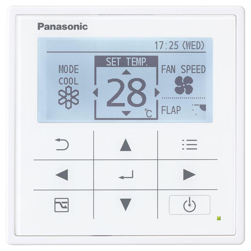

For example, our Panasonic Aquarea came with a controller like this in the box:
It has an unlit LCD screen and is an utter pig to use.

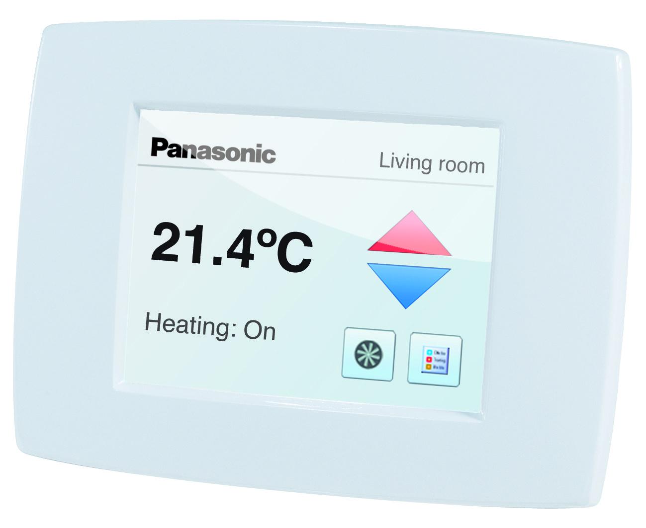

You can also buy more advanced controllers, like these (not sure which is available for current models):
Much easier to use, by all accounts.
There're also app-based controls available with many models, which adds another layer of flexibility(/potential problems!)

i have just had a panasonic system installed and have a controller that looks similar to this, it seems relatively easy to use although i have an old school rotary thermostat that does the call for heat. i am still at a stage where my system needs balanced and the plumber needs to change some settings, it is possible to have up to 6 heating programs and it looks quite simple to input the settings for that
Thanks.
I think this is perhaps the newer version of the first version I posted above.
