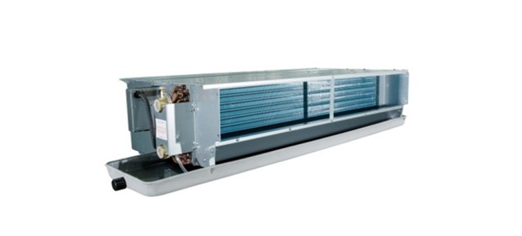

MikeSharp01 Posted July 19, 2022 Share Posted July 19, 2022 Just posted this on another thread thought it had better be here as well: We have the passive slab, will have the ASHP, so now if I can find some small fan coil units, we have only vaulted ceilings with a small flat spot at the top which has limited room but I found this fan coil unit: Image: https://www.hitachiaircon.com/hk/en/ranges/airside-systems/fan-coil-unit but I cannot find this on any Hitachi / Johnson controls UK site but scaling from the inlet/outlet pipes we might get it into the ceilings. Anybody recognise it? Link to comment Share on other sites More sharing options...
SteamyTea Posted July 19, 2022 Share Posted July 19, 2022 32 minutes ago, MikeSharp01 said: Anybody recognise it? Can you do a Google image search and see what comes up? Link to comment Share on other sites More sharing options...
Nickfromwales Posted July 19, 2022 Share Posted July 19, 2022 1 hour ago, MikeSharp01 said: Just posted this on another thread thought it had better be here as well: We have the passive slab, will have the ASHP, so now if I can find some small fan coil units, we have only vaulted ceilings with a small flat spot at the top which has limited room but I found this fan coil unit: Image: https://www.hitachiaircon.com/hk/en/ranges/airside-systems/fan-coil-unit but I cannot find this on any Hitachi / Johnson controls UK site but scaling from the inlet/outlet pipes we might get it into the ceilings. Anybody recognise it? Can you not mount this remotely and run multiples of insulated ducts to the space it needs to service? Did this on one project where I installed 2x 92mm ducts for return air, low down at the far ends of the room, and then another 2x 92mm ducts for supply of fresh / cool air. 4 ducts at the source and then you could just use a centrifugal fan and 3 row heat cool units from ( for eg ) BPC. Link to comment Share on other sites More sharing options...
joth Posted July 19, 2022 Share Posted July 19, 2022 1 hour ago, MikeSharp01 said: Just posted this on another thread thought it had better be here as well: We have the passive slab, will have the ASHP, so now if I can find some small fan coil units, we have only vaulted ceilings with a small flat spot at the top which has limited room but I found this fan coil unit: Image: https://www.hitachiaircon.com/hk/en/ranges/airside-systems/fan-coil-unit but I cannot find this on any Hitachi / Johnson controls UK site but scaling from the inlet/outlet pipes we might get it into the ceilings. Anybody recognise it? Yeah this is pretty typical, you can find images of all sorts of FCUs online, but finding a distributor/reseller for any of them is a real struggle. e.g. I have this one, rebranded as panasonic https://shop.systemair.com/en/scc202plg2/p402066 And back up thread puntaloos found this Carrier slimline unit (specs) that would fit in a ceiling void. But, unless you're building a block of flats or a large office, the suppliers really aren't interested to talk to you. Link to comment Share on other sites More sharing options...
Ommm Posted July 19, 2022 Share Posted July 19, 2022 52 minutes ago, joth said: Yeah this is pretty typical, you can find images of all sorts of FCUs online, but finding a distributor/reseller for any of them is a real struggle. Judging by this pic of the innards from Hitachi Singapore: it looks extremely similar to my Aliexpress special upthread. I assume this is a rebrand of some generic FCU, possibly Chinese. From an image search, it is notable that it shows up on the website of Hitachi Hong Kong, Singapore and Thailand, but no European websites. I'd expect it's a bit like buying cylinders from boiler manufacturers: they don't make them, they just subcontract somebody else (perhaps to special order) and rebrand. It's quite possible every country or region has their own local supplier, to save transport costs. Here's a brochure from the Philippines which has some part numbers, although looks different: http://www.jci-hitachi.ph/uploads/download_catalog/163_2.pdf My general experience is the Italians (and their UK agents) are easier to deal with, because it's not infeasible to ship stock over from Italy, whereas delivery from Asia is going to involve a container ship. However every quote I got was in the region of £500 per (radiator-style) unit, so not cheap. Link to comment Share on other sites More sharing options...
joth Posted July 19, 2022 Share Posted July 19, 2022 11 minutes ago, Ommm said: My general experience is the Italians (and their UK agents) are easier to deal with, because it's not infeasible to ship stock over from Italy, whereas delivery from Asia is going to involve a container ship. However every quote I got was in the region of £500 per (radiator-style) unit, so not cheap. Yeah mine was shipped from italy fine (well, some serious box damage, but works fine). but they have nothing in stock anymore https://www.shopclima.it/it/panasonic-paw-fc-d15-1-ventilconvettore-compatto-aquarea-con-attacco-lato-sx-1-5-kw.html Link to comment Share on other sites More sharing options...
MikeSharp01 Posted July 19, 2022 Share Posted July 19, 2022 (edited) 1 hour ago, joth said: e.g. I have this one, rebranded as panasonic https://shop.systemair.com/en/scc202plg2/p402066 And back up thread puntaloos found this Carrier slimline unit (specs) that would fit in a ceiling void. But, unless you're building a block of flats or a large office, the suppliers really aren't interested to talk to you. Thanks - that's all interesting but I don't think any of them will fit in our void, I also would need to plumb the condensate out and, because we don't want to bring outside air in, other than via the MVHR, we would need to recirculate which looks like it adds to complexity somewhat! I think I am going to look harder at getting the MVHR boost to deliver a modicum of cooling - if I get ahead of it I feel, just gut feel, we might achieve it so I need to get back to the sums. See this thread: Edited July 19, 2022 by MikeSharp01 Added link to secondary thread. Link to comment Share on other sites More sharing options...
