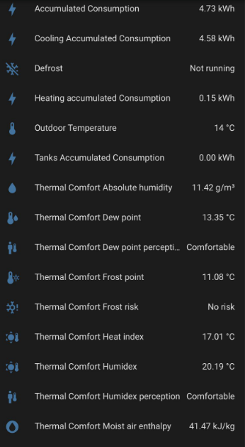

Buffers kill efficiecny so no to that, have a LOT of ufh like 1.5km as its 100mm spaced which they tell me is more than enough so buffer not needed.
Just cooling the slab makes a massive difference downstairs, basically any solar accumulation is negated. We have big bifolds which catch the sun all day, the  floor would be very warm without it.
Here is home assistant app, it pulls the date direct from the aquaera heat pump.
The fancoils are not aircon by any means but cost virtually nothing to run as its only spinning a tiny fan through a plate heat exchanger. I left them on 24x7 with 16c flow and the bedrooms were very comfortable.
MVHR we commissioning tomorrow, not expecting anything from the heat battery really but anything helps right. More for winter use.

Thanks Dave, this is fantastic to see and very interesting.
What period is that cooling accumulated consumption over?
Or do you have a measure for how much heat you've been able to extract over a day? And could you share your approx. floor space?
Do you have data for your dew point in the summer? I presume when it's hotter, with incoming air being cooled as it passes through the MVHR, you'll have a high relative humidity and a higher dew point, so the flow temp to the underfloor heating will have to be substantially higher than the 13.3+2 celsius dew point offset above?

we have 220m2 slab, this is new build so no historical data!
