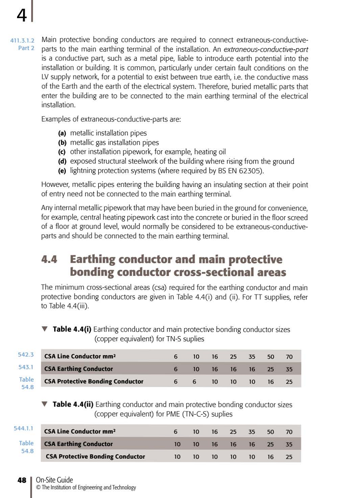

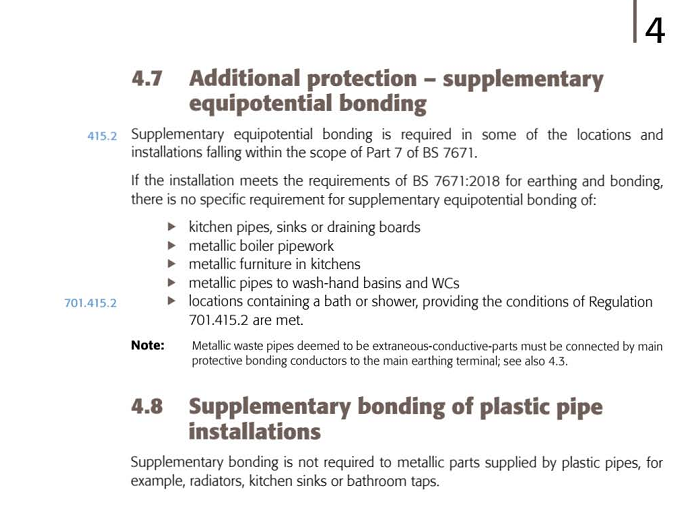

There are two separate issues here, one is main protective bonding plus supplementary bonding and the other is supplementary equipotential bonding.
Main protective bonding is still required for all metal service pipes coming into a house, even if some of the piping in the house is plastic.  Water (including metallic waste pipes), gas, oil etc, plus lightning conductors and structural steel frames have to be protectively bonded.  The minimum size of protective bonding wire has changed over the years, but for a TN-C-S/PME installation (which is what most will have) it is now 10mm² (used to be 6mm²).   There is no requirement to protectively bond incoming plastic water or gas pipes.  Supplementary bonding is used to bond  extraneous exposed conductive parts to the incoming PE (usually when an adequate disconnection time cannot be achieved on test, as a way to ensure touch potentials remain below 50 VAC under earth fault conditions).
Supplementary equipotential bonding (i.e. earth bonding by an additional conductor, other than one in the supply cable) is only required for a very few special locations now, like electric showers and electric water heaters (if this is mandated in the MIs).  There is no requirement to run equipotential bonding wires to metallic sinks, baths, basins, taps, metallic pipework, boilers, etc.
It's worth noting that earthing exposed metal parts that are not associated with the electrical installation may significantly increase the risk of serious electric shock, by providing a highly conductive path to earth that may be easily touched.  It definitely is not safer to do as @scottishjohn suggests, best to follow the regulations, which have been amended specifically because this risk was recognised.

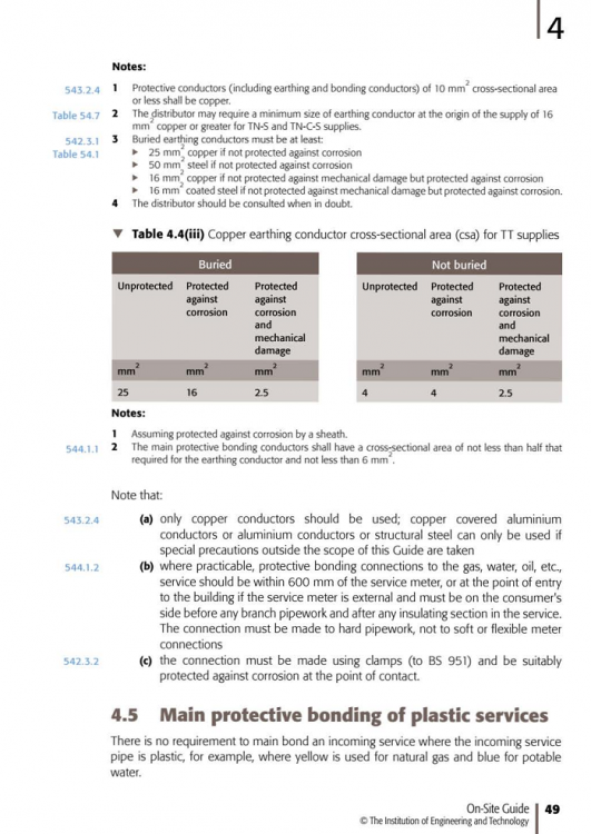

You must have a 10mm² main protective bond from the incoming copper water main back to the main earth block where the PEN is connected.
There is no need to equipotential bond extraneous metal, like taps, sinks baths etc, and it's safer not to have them bonded.
This is the relevant section from the current (18th Ed) OSG for reference (excerpt posted here under the "fair use" provision):

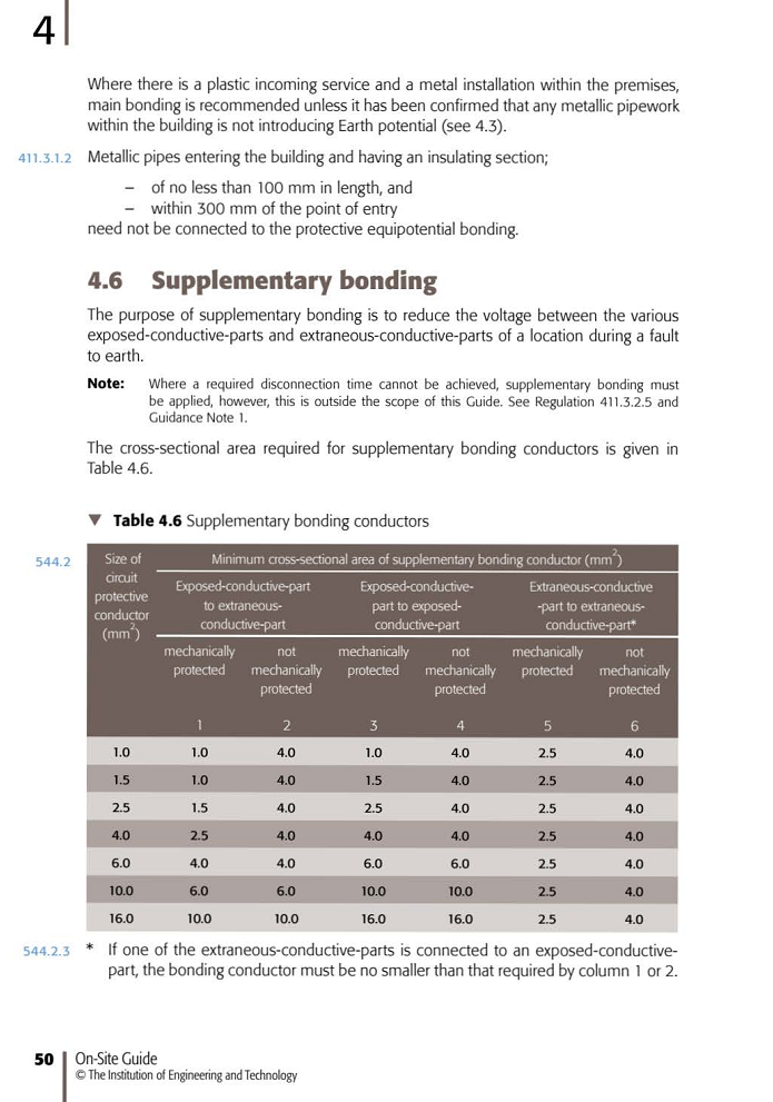

Thanks, so reading the sentence
in the regs....attached
If it has an insulated section at point of entry it doesn’t need to be connected to the main earthing terminal.

As that has a metal pipe coming out of the ground to a metal stop cock, I'd bond and tag it.
The idea behind main protective bonding isn't primarily to ensure that all metal pipes in the house are at earth potential, it's to both lower Ze (the external earth loop impedance) and to provide an additional path to earth for the CPC for the whole installation if, for any reason, the PE connection at the incomer fails or has a high resistance.
This bit dates back to the time when incoming metal water pipes were often used as the primary protective earth for the whole installation, something that's not permitted now, but used to be commonplace years ago.  Nothing wrong with this as a means of earthing the installation, either, the main reason it was discontinued as normal practice was the introduction of alkathene pipe around 40 years or so ago, as there was no longer a guarantee that the incoming metal pipe to the house had good connectivity to the ground outside, as there could be a length of plastic pipe just outside the wall.
