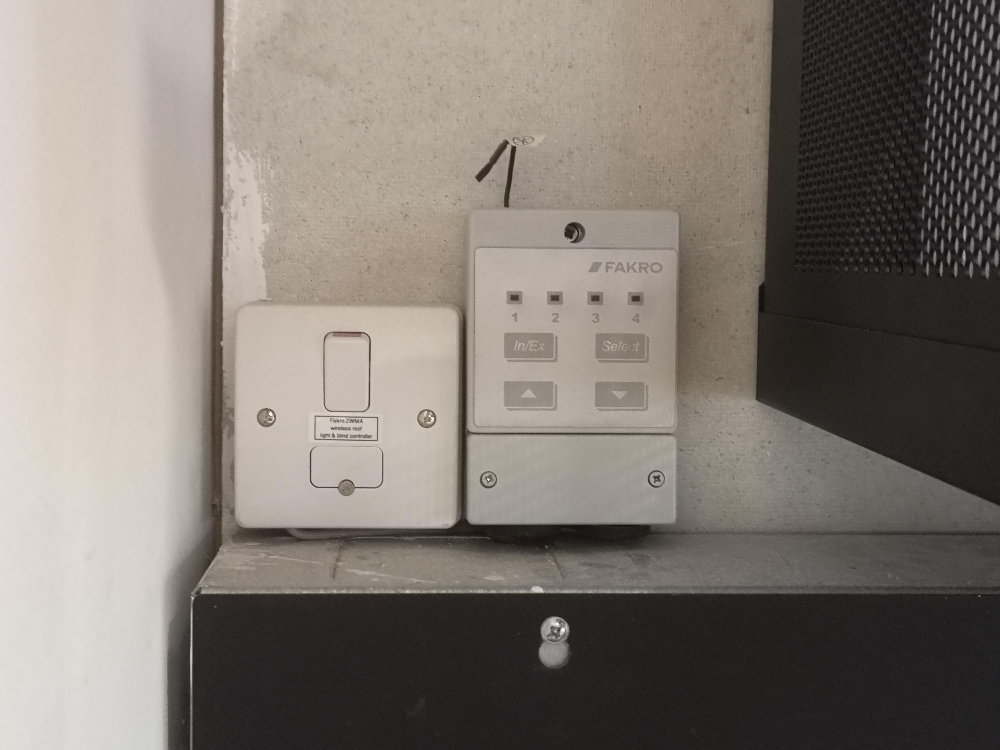

Jimbouk Posted July 14, 2019 Posted July 14, 2019 I’ve got the Fakro z-wave roof windows and would advise you approach with caution. They have been a nightmare to get working with z-wave (there is no Wi-fi option), only got one to work from a Vera platform controller and that meant not being able to use the supplied remote controller with it anymore. The instructions are dire, they should be great but user experience is terrible. If someone can help me make them work properly then I would be a convert, as there is a strangely satisfying feeling being a 100 miles away from the house and getting an alert on my phone that as the room has reached 23 degrees the window has opened. Fly screens are a good idea though, I have a fear that a bird or bat will get in and the window will then shut, trapping it in the house. 1
jack Posted July 14, 2019 Posted July 14, 2019 I haven't got around to trying again, but we were never able to get our Fakro z-wave rooflight to work after installation the years ago. I couldn't figure out at the time whether it was how we integrated it to our home automation system that was the problem, or I'd have been onto Fakro for help. Interesting you've had issues too.
joth Posted July 14, 2019 Posted July 14, 2019 Ugh that's exactly what I didn't want to hear, but thanks for the heads up anyway @Jimbouk and @jack ! I'd also been informed the Velux automation interface is dire, and they've more or less stopped making their Passive house grade skylight anyway it seems, so I was very happy when Fakro said they can make the FFT U8 with z-wave by special order. God knows it's going to be a bugger to get to if we ever need to maintain it. But it's much easier to order with electronic opening even if we end up never using it, than attempt to retrofit it.
joth Posted July 14, 2019 Posted July 14, 2019 Honestly all I want is a wired interface with dry switch contacts for "open" and "close"....
jack Posted July 14, 2019 Posted July 14, 2019 11 minutes ago, joth said: Honestly all I want is a wired interface with dry switch contacts for "open" and "close".... That's exactly what we were after. In the end, we went with the Fakro wireless unit (which from memory has internal dry contacts), connected to our Loxone home automation setup. 1

jack Posted July 17, 2019 Posted July 17, 2019 30 minutes ago, puntloos said: @jack, @Jimbouk - any chance you’re able to try this again for us aspiring smarthomers? ? - or anyone else have an actually working setup, perhaps with smartthings or some other hub? I need to book my electrician back in for this, as he's the one who wired it all up and spoke to Fakro about how it would (/should!) work. Can't see that happening in the next few weeks as I have some other things I need to get ready for him so he can do it all in one visit. That said, it could well be something I or my electrician did back during setup that's causing the problem. I know there was some sort of "learning" mode you needed to access via the remote, which may not have been done properly at the time, despite us having Fakro's tech department walk him through it. If I'd had more time when this all happened I'd have pushed harder to get it sorted then, but too much time has passed for me to go back with a straight face and demand they fix it!
