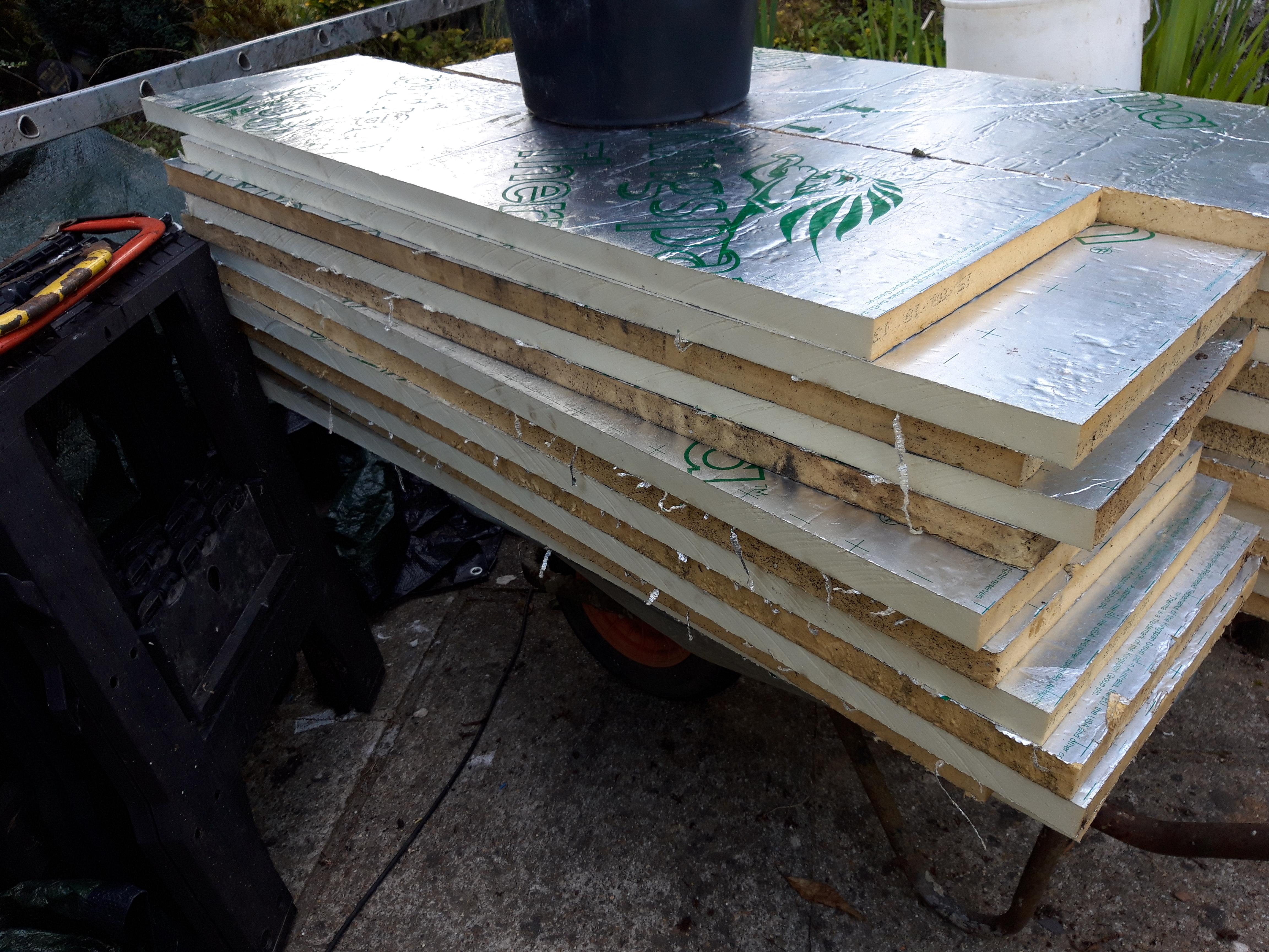

Carrerahill Posted July 4, 2019 Posted July 4, 2019 All the insulation arrived today, does it need to be under cover? It would take a lot of effort and a lot more effort to clear a space to put it indoors so it wasn't in the way and the garage is full of timber and tiles and cement just now. I don't want to double handle the PIR boards, so, can it just stay put outside until I use it? Probably a couple of weeks tops - it's just it does have a symbol showing a umbrella with rain which is the keep dry symbol. It's closed cell so I cannot see how rain would upset it. Thanks

A_L Posted July 4, 2019 Posted July 4, 2019 Ideally should at least be covered to keep rain off. Under permanently damp conditions PIR can undergo hydrolysis (breakdown into constituent parts). It is why when used as under slab insulation it has a dpm below as well as above. http://blog.celotex.co.uk/technical/what-celotex-insulation-can-be-used-in-floor-applications/ 1
nod Posted July 4, 2019 Posted July 4, 2019 Just now, A_L said: Ideally should at least be covered to keep rain off. Under permanently damp conditions PIR can undergo hydrolysis (breakdown into constituent parts). It is why when used as under slab insulation it has a dpm below as well as above. http://blog.celotex.co.uk/technical/what-celotex-insulation-can-be-used-in-floor-applications/ I don’t think two weeks this time of year will do it much harm 1
Bitpipe Posted July 4, 2019 Posted July 4, 2019 Onv we wary 1 minute ago, nod said: I don’t think two weeks this time of year will do it much harm We had a month's rainfall in an hour only a few weeks ago Be wary of wind as much as rain unless you want to go on a PIR treasure hunt... 1

ProDave Posted July 4, 2019 Posted July 4, 2019 Tie or weight it down, or it will all go awol next time the wind blows.

Conor Posted July 4, 2019 Posted July 4, 2019 1 hour ago, Carrerahill said: OK thanks guys. It all makes sense, all of the stuff outside is in it's wrapping - they are just a bit torn up. I'll look out tarps later. I might even start installing some! Couple sheets of cheap DPM and a few concrete blocks and your sorted.
Temp Posted July 4, 2019 Posted July 4, 2019 PIR is left exposed in cavity walls while they are built. I'd just buy a large cheap tarp off ebay. Stick some blocks on it. I'd be more worried about it being stolen . 2
Onoff Posted July 5, 2019 Posted July 5, 2019 Edges go a bit yellow and manky if it lives outside for too long. I've just gotten round to cutting this stack of freebie sheets up on the table saw. No mask , could explain why I'm coughing up green + blood. It's either the pir fibres, when I cleaned all the cr@p off the tiles last weekend or when I de-ratted the car the other day. Mask then eh?
