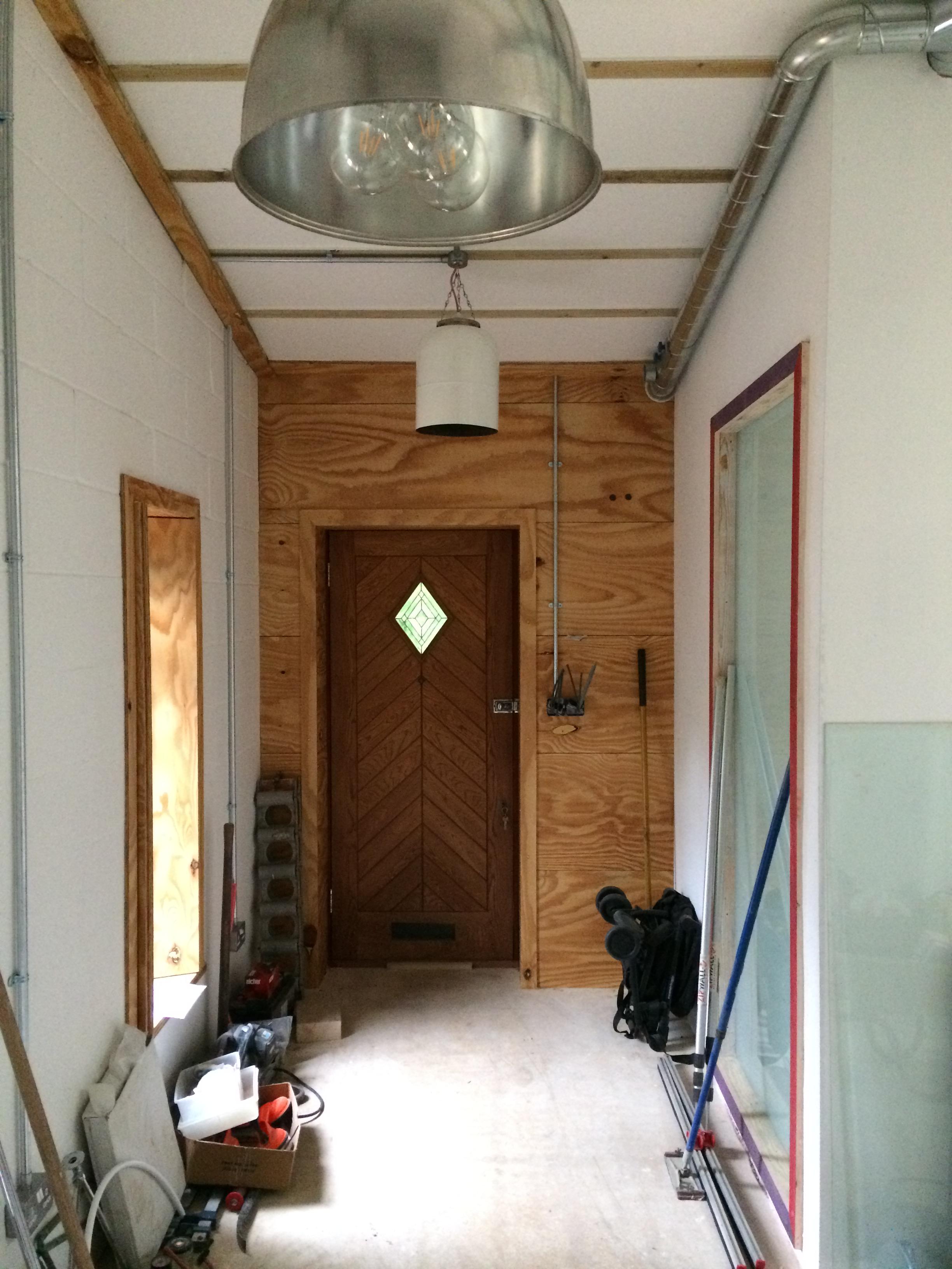

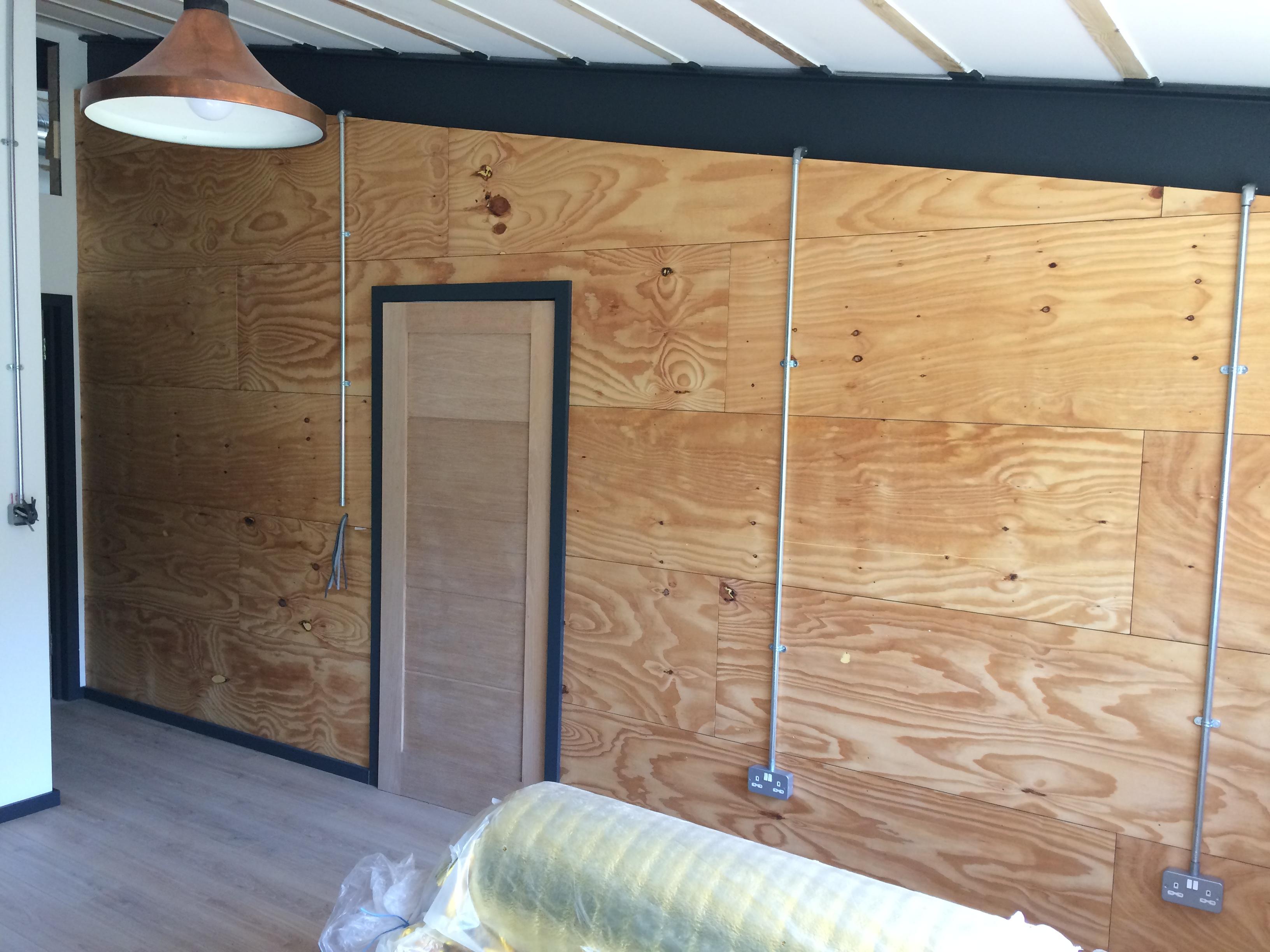

Alfow Posted June 29, 2019 Posted June 29, 2019 On 28/06/2019 at 09:51, AnonymousBosch said: Lining a wall with plywood isn't as easy as it looks, I'm sure. But then nothing else in house building is either. We are considering lining some walls with ply. The substrate for the ply will be battens fixed on concrete - perfectly rigid, therefore. Question is, how thick should the ply be? Thanks, Ian Expand We used 12mm sanded then danish oiled. We’re pleased with the effect. 2

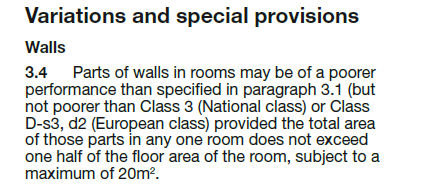

Alfow Posted June 29, 2019 Posted June 29, 2019 On 28/06/2019 at 12:29, Mr Punter said: As long as it is less than 50% of floor area it is OK, so a feature wall, not the whole room. Expand Is this 50% of the floor area of the room it is in or 50% of the whole house? I am having this ‘discussion ‘ about flame spread with BCO at the moment.

Mr Punter Posted June 29, 2019 Posted June 29, 2019 On 29/06/2019 at 08:38, Alfow said: Is this 50% of the floor area of the room it is in or 50% of the whole house? I am having this ‘discussion ‘ about flame spread with BCO at the moment. Expand The room.

Alfow Posted June 29, 2019 Posted June 29, 2019 On 29/06/2019 at 09:29, Mr Punter said: The room. Expand Thank you for sharing that. Most helpful. That’ll get me out of jail in our open area but not the bedroom I think. Is that taken from Part F?
Mr Punter Posted June 29, 2019 Posted June 29, 2019 On 29/06/2019 at 17:01, Alfow said: Thank you for sharing that. Most helpful. That’ll get me out of jail in our open area but not the bedroom I think. Is that taken from Part F? Expand Part B fire safety
Patrick Posted June 29, 2019 Posted June 29, 2019 On 29/06/2019 at 08:34, Alfow said: Expand What's the finish on the ceiling there? I can't quite tell from the photos but looks good as well.
Alfow Posted June 29, 2019 Posted June 29, 2019 On 29/06/2019 at 17:49, Patrick said: What's the finish on the ceiling there? I can't quite tell from the photos but looks good as well. Expand That’s the faces of the 7x3 timbers with painted plasterboard in between.

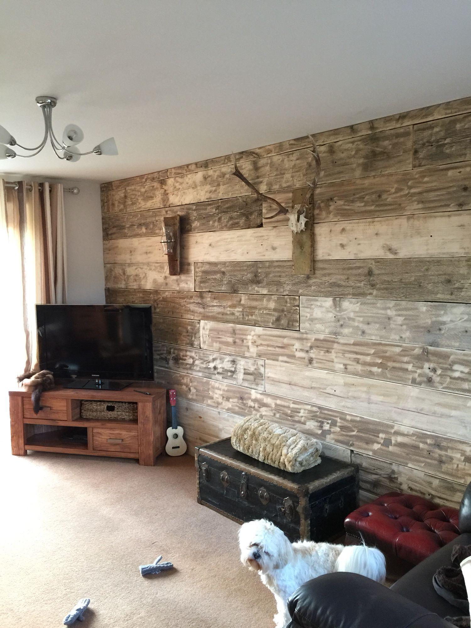

Ferdinand Posted July 1, 2019 Posted July 1, 2019 (edited) On 30/06/2019 at 13:59, joth said: This thread inspired a conversation about having a ply feature wall. (We are planning kitchen units with some exposed ply, so it would all tie together nicely). Immediate reply from my wife was "won't that be a nightmare for hanging pictures / shelves etc?" -- we'd fear to drilling into it as it's much harder to polyfilla it over if making a mistake or future change of needs. How do others deal with this? I guess could go full-industrial with some sort of wall racking system. Or totally pegboard it. Expand I would try a different type of fixing. You could perhaps rout a "picture rail" groove into it, or attach something industrial-looking to do the same job? I posted a piccie recently of a scaffold plank feature wall being used by my Lettings Agent in a decor scheme from a professional HMO in Nottingham. I am still undecided, but it is an attractive option as the surface is not pure. Now seems to have vanished as presumably the room is rented, but like this: For hanging things or posters etc, I have never done better than the cork tiles I used for a whole wall once. They included partially black cork, so it was a texture. Ferdinand Edited July 1, 2019 by Ferdinand

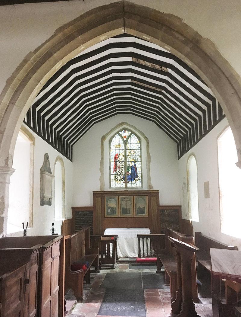

Ferdinand Posted July 1, 2019 Posted July 1, 2019 (edited) On 29/06/2019 at 08:34, Alfow said: We used 12mm sanded then danish oiled. We’re pleased with the effect. Expand Interesting - that does not chime with me personally, despite one of my favourite themes being simple modern styles with exposed materials. I think that for me it is neither one thing nor tother. That is too many materials all trying to be themselves such that none of them get the space to be their best, so it comes across to *me* as a bit too "smorgasboard", almost "tartan". If I was to live with the busy grain from the ply, I would want the rest to be very quiet. So I might have gone eg for simple black doors. Not a criticism; more a different perspective. I have perhaps been conditioned by medieval church interiors in England stripped to stone and plaster having visited so many; if you put me somewhere like the Pugin Gothic Revival Roman Catholic church in Cheadle I find it impossibly busy: Ferdinand Edited July 1, 2019 by Ferdinand

Onoff Posted January 1, 2023 Posted January 1, 2023 On 01/07/2019 at 05:37, Ferdinand said: I posted a piccie recently of a scaffold plank feature Expand I reckon those boards are wider than normal scaffold boards. 1
Ferdinand Posted January 3, 2023 Posted January 3, 2023 On 01/01/2023 at 19:44, Onoff said: I reckon those boards are wider than normal scaffold boards. Expand Oooh. My old post has matured like an English Sparkling Wine from Nyetimber. I make it 10 and a bit planks in that piccie, so at 225mm each for a 9" board I make it just on a 2.4m ceiling height. F
