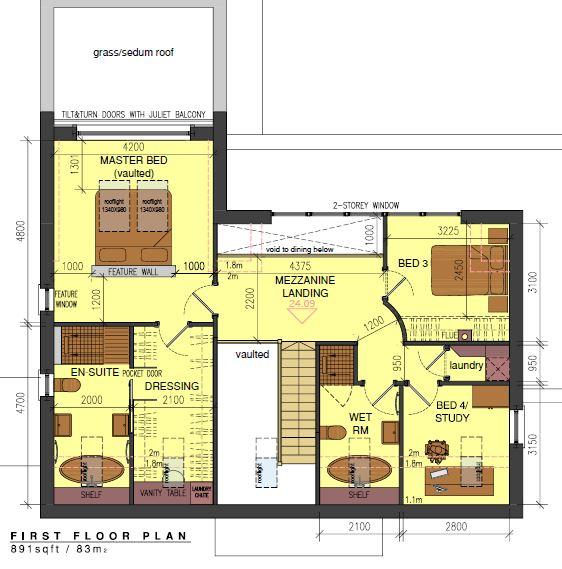

Conor Posted June 19, 2019 Posted June 19, 2019 (edited) Hi. We have a dilemma. Currently our design has three bedrooms on our top floor (1.5 story house with basement). It's not quite working as two of the rooms are quite small. We're thinking of having just two bedrooms on top floor (master and a large second room), and the other two on the lower ground floor. We've no issues with this as we've no kids... but concerned about resale. For those with kids, would having a floor separating you and two kids rooms be a turn off for buying a property? We'd prefer to keep the main ground floor living space only. Reason for this rethink is I'm toying with the idea of making the mezzanine full width across the back of the house, so we'd lose 1.5m off the back bedroom. We really have no need for 4 bedrooms, but we kinda do for valuation and resale. Don't want to make the house my bigger than it is and we're already pushing limits with the planning Edited June 19, 2019 by Conor

Ferdinand Posted June 19, 2019 Posted June 19, 2019 (edited) I thank your idea could work OK. However, looking at the plans, I would say that you can get bigger bedrooms where they are. At present Bed3 and Bed4 are approx 10sqm and 9sqm, plus the roofs are into the roof. Your wet room is 8sqm and your laundry is 3sqm. Plus there is all that whatever it is around the flue. I would suggest a look at replacing the wet room with a pair of en-suite shower rooms between the 2 beds. 2 sqm or so will be ample for each of those with a nice big shower say 1.2*0.8. Then take the laundry out of where the wet room is now if you need it up there, and that leaves you at least 4sqm to boost each of 3 and 4 by 20-25%. Is that enough? You might even be able to nick a little from the 2.2m wide mezzanine. You would get 2 larger, similar but interestingly different, rooms, with equivalent facilities. If that staircase is steeper than 40 degrees, I would nick a foot or two of space and make it less than forty. That is my hobby horse, but you will not regret a relaxed staircase. Edited June 19, 2019 by Ferdinand

AliG Posted June 19, 2019 Posted June 19, 2019 I do like the design of the house. I don't think that bedrooms the ground floor are a problem. If you had a young child they could be next to you up stairs and older children could be downstairs. When I was a teenager this was a big positive to the layout of the house my parents bought. I would, however, be worried about losing the TV room downstairs which is a nice feature. I would also be concerned re having the mezzanine all the way across the upper floor. Between this and the vaulted area around the stair, you have already lost around 25 square metres, taking this up to over 30 square metres is a lot of space to waste if it is limited. A big hall is nice, but this may be too much relative to the house. One thing that could work I guess is moving the bedrooms downstairs and making the mezzanine so large that it becomes the TV room, this may or may not work for how you live, it would be noisy and have people travelling through it. As @Ferdinand says though you probably could do better on the upper floor. Bed 3 is shown as 2.45m wide ex the wardrobe. This is just unusable as a double bedroom. By the time a duvet hangs over the side of the bed you would not have much more than a foot down each side. I like the idea of an upstairs laundry, we have one, but personally I would look to move it and put the Bed 3 wardrobe there. Then you have a 3.1m wide room. This would require moving the flue, can it not be horizontal and go out the side rather than up through the house? I have 2 gas fires with horizontal flues, but tbh by the time I had spent money getting the gas supply to them, getting the flues installed etc they were a lot more bother than they were worth. That flue will be very expensive and will need unsightly inspection hatches along its height. I think you could either put the washing machine in the boot room or steal some space off the dressing room if you really want it up the stairs. It also looks like there is a laundry chute down to the boot room so I am a little confused. I like the large bathrooms and would keep them, but the dressing room seems unnecessarily large to me if you need space for an upstairs laundry. Of course you may have a lot more clothes than I do! Out of curiosity why the feature wall and corridor in the master bedroom? I sometimes see this design when there is a dressing room or ensuite behind it, but this just seems to create a wasted space as these areas are separated by a door.
Ferdinand Posted June 20, 2019 Posted June 20, 2019 (edited) Only brief as I am just about to swan off to interact with the savages of Timbucthree, ie Manchester. Looking a bit more widely at the plan, which I really like the feel of - esp. the basement and courtyard which reminds of that very early UK passivehaus under the barn in the Cotswolds from GD, I would perhaps consider some element of interchangeability between top floor beds, guest bed/study, and TV room - such as to support: 1 - Kids upstairs now and potentially in the basement later when they start playing trombones or drums needing a bit more freedom. That would be divide up basement, give kids more space, and create parent-snug elsewhere say on GF, but that undermines my point 2 a little. 2 - I like studies to be on the ground floor. I think they (and the TV room) are semi-public spaces and need to be available for visitors rather than locked away. Plus be near the door for callers should there be a home based business. Perhaps studios and writing nooks or craft rooms are different. 3 - Future granny flats etc - which would to my eye naturally fit in the basement. That all depends on which extra items make a TV room for you, and how you will live. Just thoughts. Ferdinand Edited June 20, 2019 by Ferdinand 1

Conor Posted June 20, 2019 Author Posted June 20, 2019 Thanks everybody, very helpful. A few things that will be changing from that version of the plans: 1. Laundry room is gone, space then available for either bedroom. Chute gone. 2. Fitting washer and drier in to the main bathroom and losing the bath. 3. Stairs being moved over to other side. 4. The downstairs guest bedroom will be a dark, quiet TV room, but with the accessible bathroom staying for future proofing. 5. Considering a full size basement - the cinema room would be a large guest bedroom, we'd fit in another spare room, then rest of footprint would be storage and gym) games area. We won't be building the garage. Rather put that money in to a full sized basement. Because of the area and size of plot, 4 useable bedrooms are essential. Wish we could build a smaller house!
