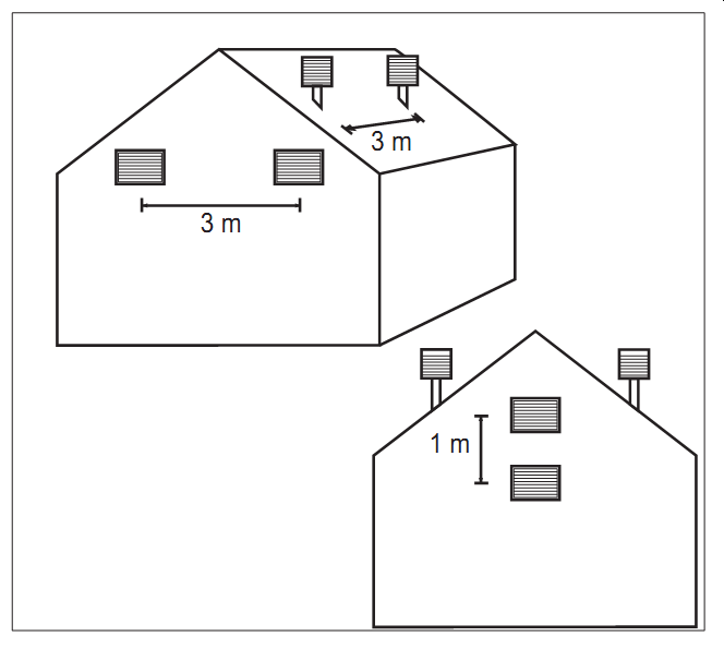

Pocster Posted July 2, 2019 Author Posted July 2, 2019 More thoughts ... The in/out air pipes . I want to mount them on the external wall as roof would be a pita . Is it not unreasonable to cut out a slot in the insulation between the rafters and run the pipe either down into the cavity wall or to the eaves ? ( assuming it will fit )
Jeremy Harris Posted July 2, 2019 Posted July 2, 2019 2 hours ago, pocster said: More thoughts ... The in/out air pipes . I want to mount them on the external wall as roof would be a pita . Is it not unreasonable to cut out a slot in the insulation between the rafters and run the pipe either down into the cavity wall or to the eaves ? ( assuming it will fit ) The inlet and exhaust ducts will be at least 150mm in diameter, and need to be spaced apart on the wall by a couple of metres, so that may have a bearing on where you fit them. Best have both of them on the same wall, as I didn't take heed of this and as a consequence our MVHR gets unbalanced if we get a strong wind from the West or East.
Pocster Posted July 2, 2019 Author Posted July 2, 2019 5 minutes ago, JSHarris said: The inlet and exhaust ducts will be at least 150mm in diameter, and need to be spaced apart on the wall by a couple of metres, so that may have a bearing on where you fit them. Best have both of them on the same wall, as I didn't take heed of this and as a consequence our MVHR gets unbalanced if we get a strong wind from the West or East. 150 ? Oh ! I thought they’d be the same as the ducting I.e 75mm Wall then - going to be tricky getting them in a TF and ( as my trusses are high ) in the wall section ?

Jeremy Harris Posted July 13, 2019 Posted July 13, 2019 2 hours ago, joth said: If space is really limited you can put the ducts much closer together using a combined grille like the Maico KWH 16 R http://www.heatspaceandlight.com/space-mvhr-ducts-tight-combined-intake-exhaust-grille-solution/maico-combined-exhaust-intake-grille-for-mvhr-ventilation-systems/ Only know this because our system designer has suggested this. He's also recommended the enthalpy exchanger too (partly because we may add some active heating via the ducts, which can push humidity even lower) I'd only consider that in a really extreme set of circumstances, as there will inevitably be some degree of mixing between the intake and exhaust, plus it may well invalidate some performance elements of the MVHR unit warranty, or be considered non-compliant by building control if they chose to be pedantic. It's a compromise solution, for circumstances where it would be impossible to fit two well-separated external terminals, rather than something to be used routinely. There is guidance in Part F and in the associated Domestic Ventilation Compliance Guide on the placement of fresh air intakes and exhaust terminals and it states that the exhaust terminal should be positioned down wind (relative to the prevailing wind conditions) from the intake, and sufficiently far away from it to ensure that exhaust air is not drawn in to the intake. Additionally, MVHR manufacturers often stipulate in their MIs the spacing, and MIs always overrule building regs when it comes to compliance demonstration. For example, the MIs for our MVHR stipulate the following separation criteria between intake and exhaust: 2
