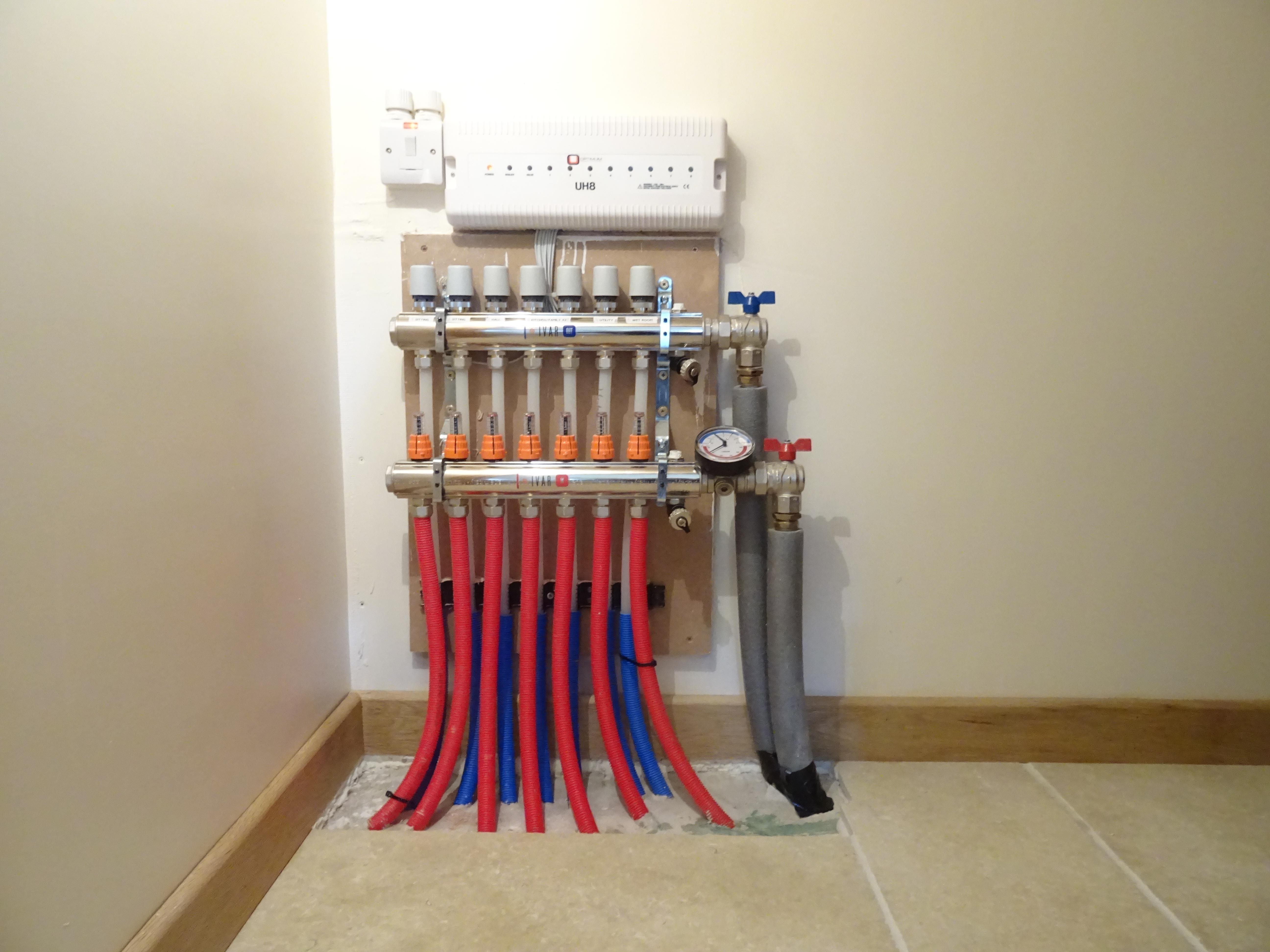

Wagas Posted June 8, 2019 Author Posted June 8, 2019 I guess the downside of doing it before plastering walls is the manifold is installed onto a section of bare block wall?
nod Posted June 8, 2019 Posted June 8, 2019 2 hours ago, Wagas said: Hi, is there a view on whether it's better to install UFH and screed before or after plastering the walls or is there no benefit to doing it in a certain order? Thanks 11 minutes ago, Wagas said: I guess the downside of doing it before plastering walls is the manifold is installed onto a section of bare block wall? 11 minutes ago, Wagas said: I guess the downside of doing it before plastering walls is the manifold is installed onto a section of bare block wall? Doesn’t make any difference But as below screed shouldn’t come in contact with plaster
ragg987 Posted June 8, 2019 Posted June 8, 2019 38 minutes ago, Wagas said: I guess the downside of doing it before plastering walls is the manifold is installed onto a section of bare block wall? Ours was not properly fixed to the wall, essentially just hanging, until plastered and painted.

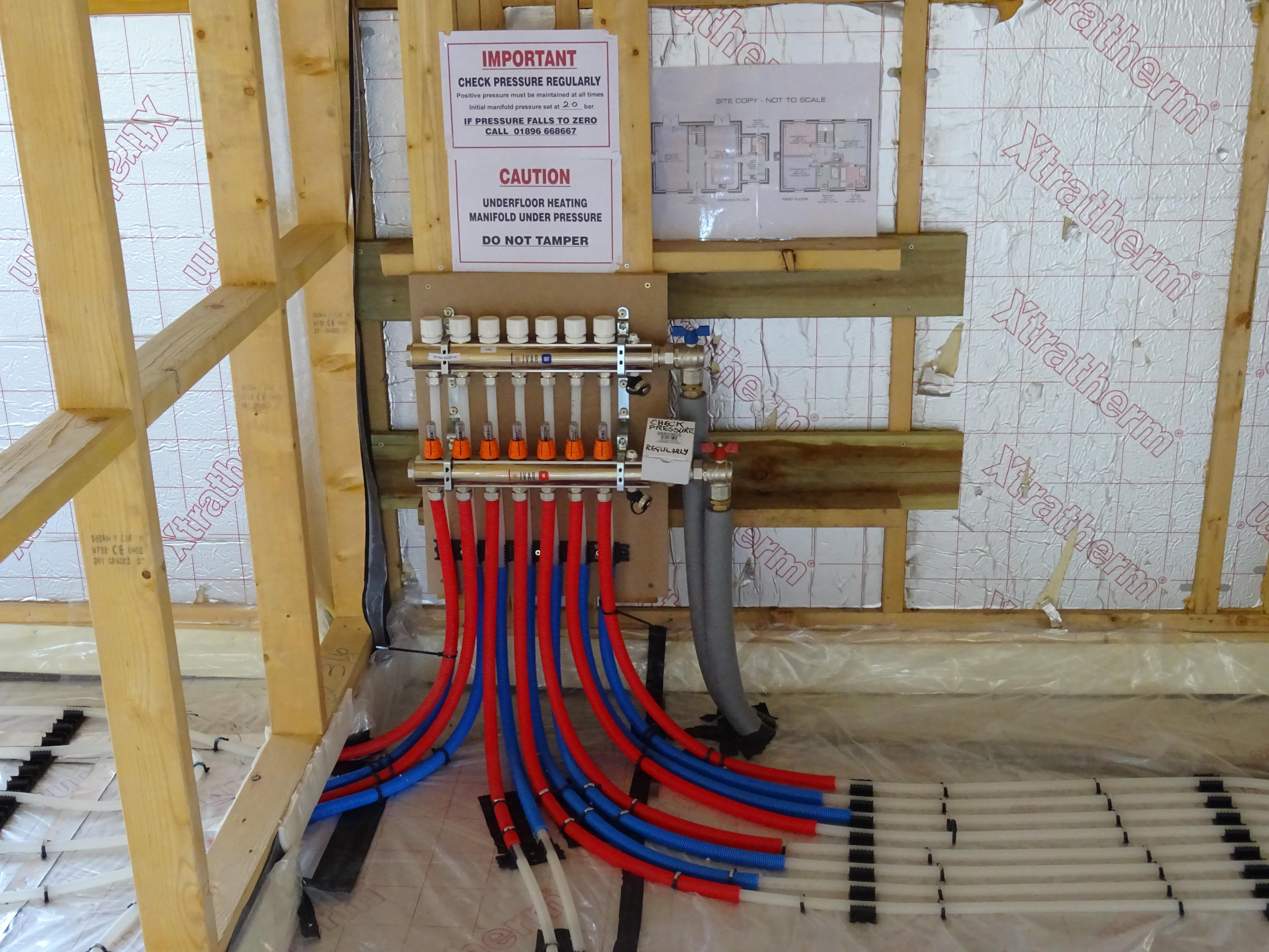

Redoctober Posted June 8, 2019 Posted June 8, 2019 3 hours ago, ragg987 said: Ours was not properly fixed to the wall, essentially just hanging, until plastered and painted. @Wagas - Like @ragg987 We put the screed down over the UFH first as to allow plenty of time for it to dry out prior to the tiles going down. Sometimes an image or two helps. The two images show how the manifold was fixed to a wall, in the under stairs cupboard, prior to the walls being plastered and how it ended up afterwards. 2

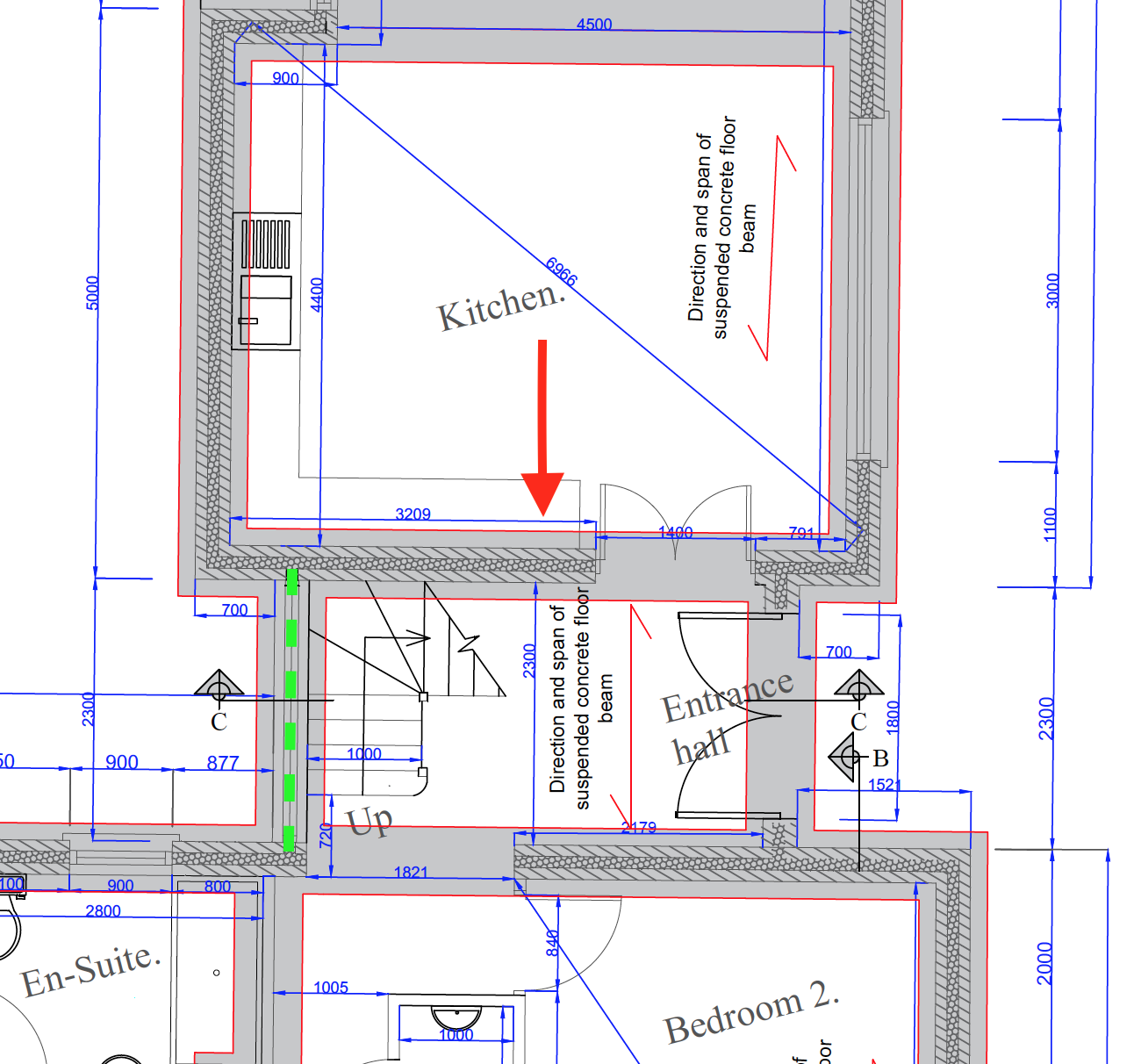

Wagas Posted June 15, 2019 Author Posted June 15, 2019 (edited) @RedoctoberThanks for the pics Where would you guys put the manifolds if you don't have a utility room? The UFH designer suggested under the stairs but the stair area is small and will have a large glass window so I'm thinking not to congest/clutter this area. I was thinking about having some large cupboards where the red arrow is in the kitchen and putting boiler/UFH there. Any thoughts appreciated Edited June 15, 2019 by Wagas layout
Nickfromwales Posted June 15, 2019 Posted June 15, 2019 Nothing wrong with that, as long as that cupboard doesn't house perishables. Dont fix to the unit, fix to the wall so the cupboard doesn't turn into a drum
