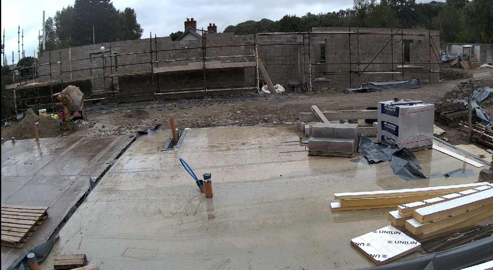

Hiya, so joists are going in next week, joiner said to use cabershield. I have been ringing around local suppliers to see whats available given the short timespan, I think we can get both cabershield and egger, getting told its 'similar' by the merchants. Is it? Also should we cover it with plastic anyway for added protection? The fecking rain would break your heart. As for tradies not turning up, don't talk to me.

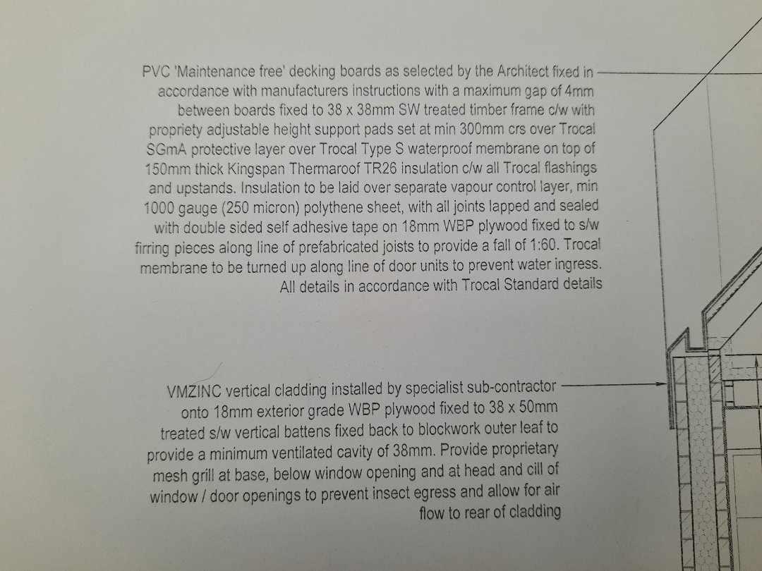

Hello, again - my apologies, agin am here to pick your brains. So our posi joist and posi rafters are due to arrive Friday - yay/phew, equal measure. So the design has a small terrace between our part of the house and mums granny flat. The design was spposed to have a zinc roof (lol, unless we won the lottery that was never happening) and the guttering wiithin the cavity (again, cost led the change) . So trying to get stuff ordered to do the 2 pitched roof's and the flat terrace roof. It's hard for me to understand the architects notes. This trocal Type S waterproof membraneand the trocal sgma protective layer - are there eqivalents you could use? Cheers.

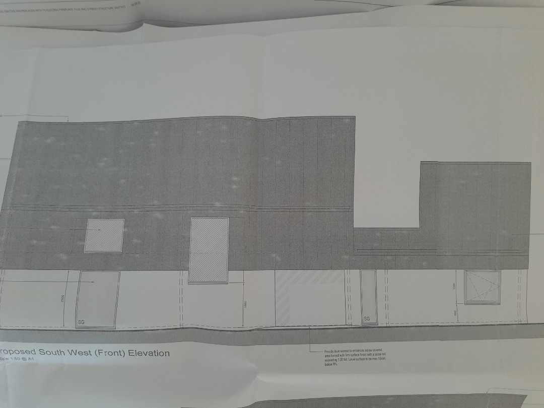

Sorry looking at the plans and see this 'Door Leaf 2040 x 826' does that mean that is the size of the door we need to buy? Started looking, jeez the glass ones are dear. I take it the solid ones are best re sound insulation? Anywhere in particular is good to use? Obviously are on a tight budget so swanky is out.
