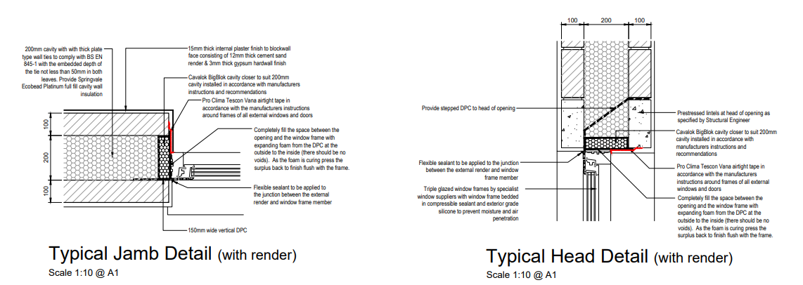

Help (wee voice). So we were supposed to be having the brickies back tomorrow but I am thinking of putting them off because I don't think we have enough stuff. We have the slab poured and next stage is mannock bricks and dpm. So attached is the Typical Jam Detail and Typical Head detail. 1)When will I need the Pro Clima Tescon Varna tape? At what stage? 2)Is there an equivalent performing substitute that is a better price? 3)What width & length ishould I order? (I was going to order 50 rolls but don't know which). I have read where you order from Germany and will do that. 4)Can I order roof membrane the same way to make a saving, will rooofers allow me to supply the membrane? Input gratefully received!!

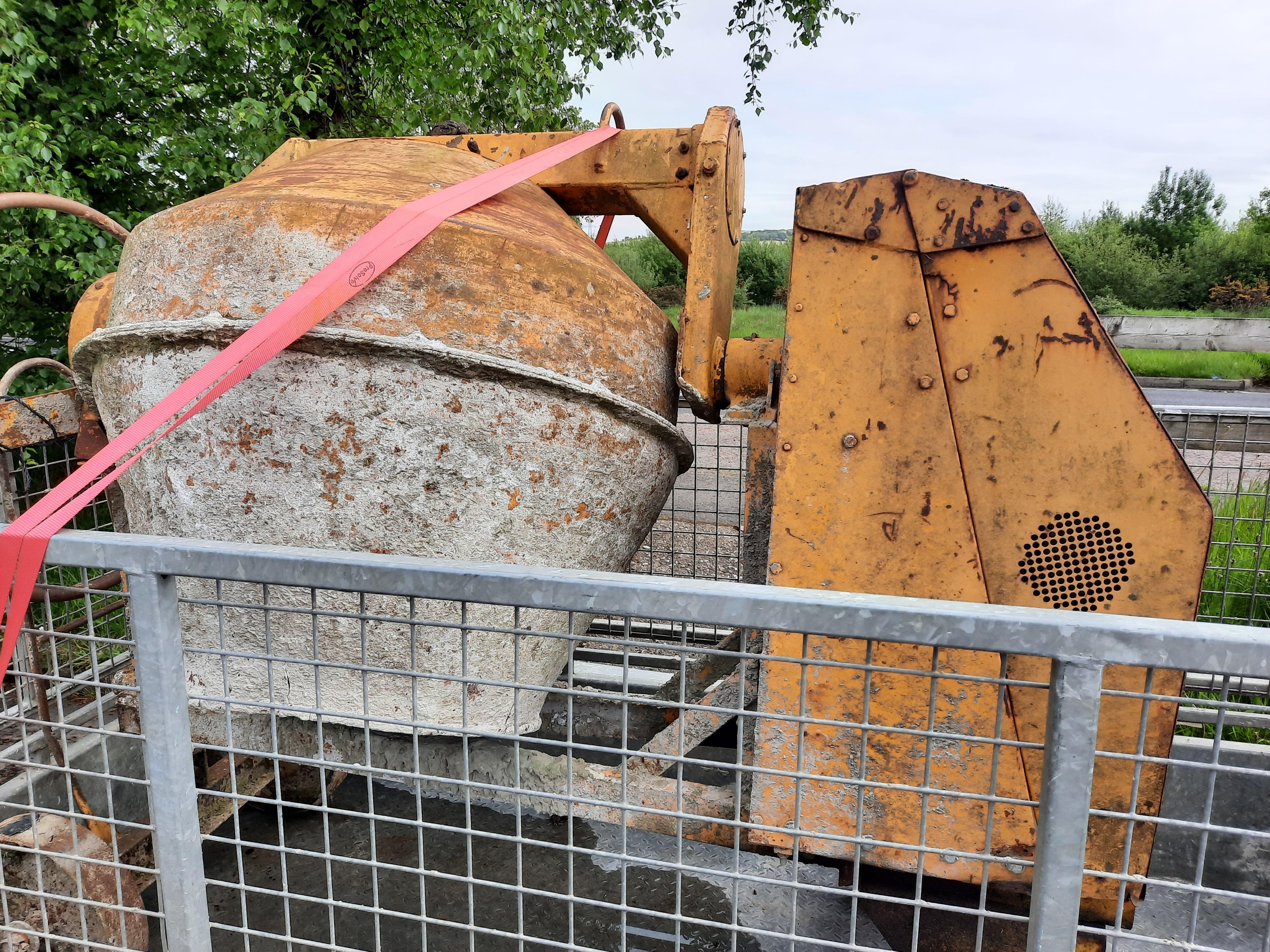

Digger ran over generator lead

Thankfully we have a no b/s groundman who I really do have total faith in. Tbf the digger driver is very good too, I keep getting told it by contractors. I fessed up immediately to the hire shop. Right will do as you say and will save the spare bit. Much appreciated. -
Sheesh so the digger ran over the cable so the hire company will invoice me for it. I will keep the damaged one, I take it the safest thing is to just lose the part that was severed and move the plug to the new end? Like joining it even covering with heat shrink tubes would be a bit crap?

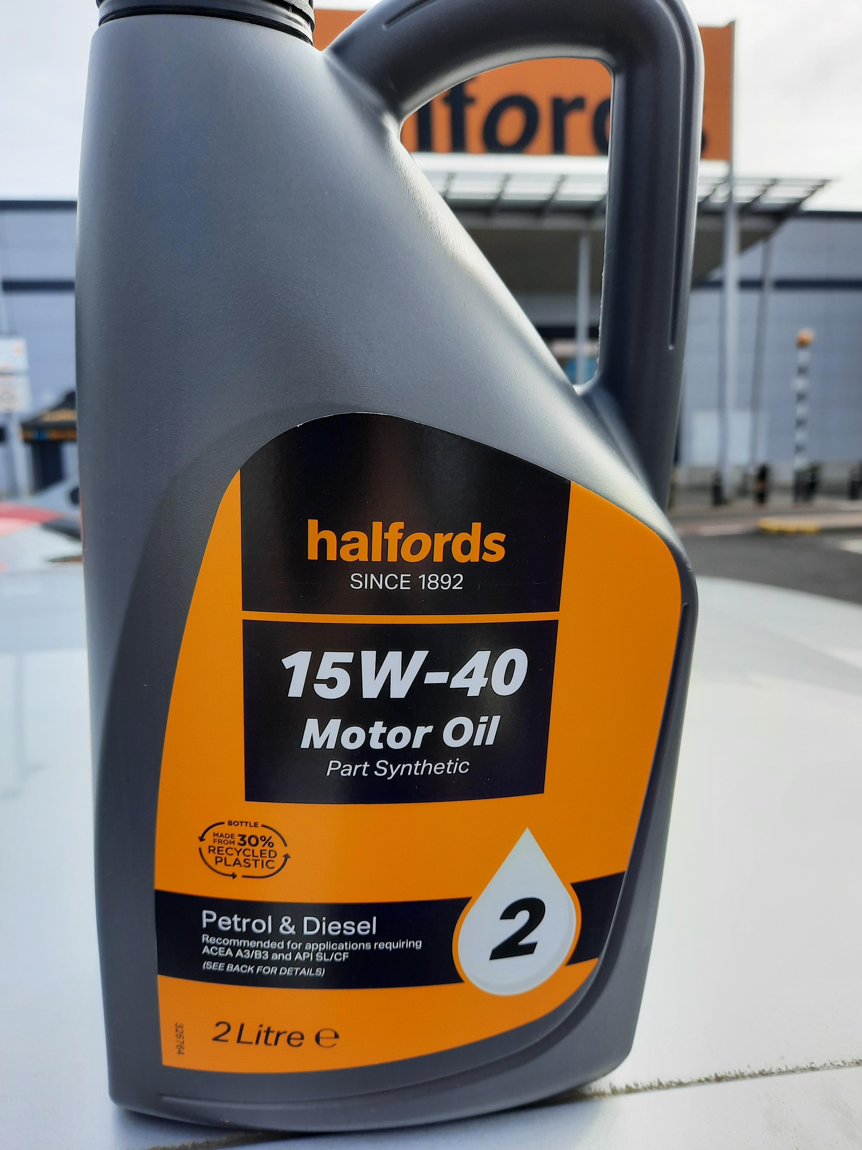

We saw it working, it has a handle start. The guy said to get oil (showed us the level for the dipstick) and leave it beside it. I know its engine oil but was about to go to halfords to get some, any particular kind? Thanks. Yup I need to get diesel too, they will be there at 8, the digger will position it. How much diesel should I get, tomorrow is only 2 men 1 day then a lull for 2 weeks till bison slabs arrive. Guy also said at end to call him after we are done with it and he would likely buy it back. (He was refused planning for a self build and they are fighting it). Ssssh don't ask me how much we paid because you will say we could have done better lol.
