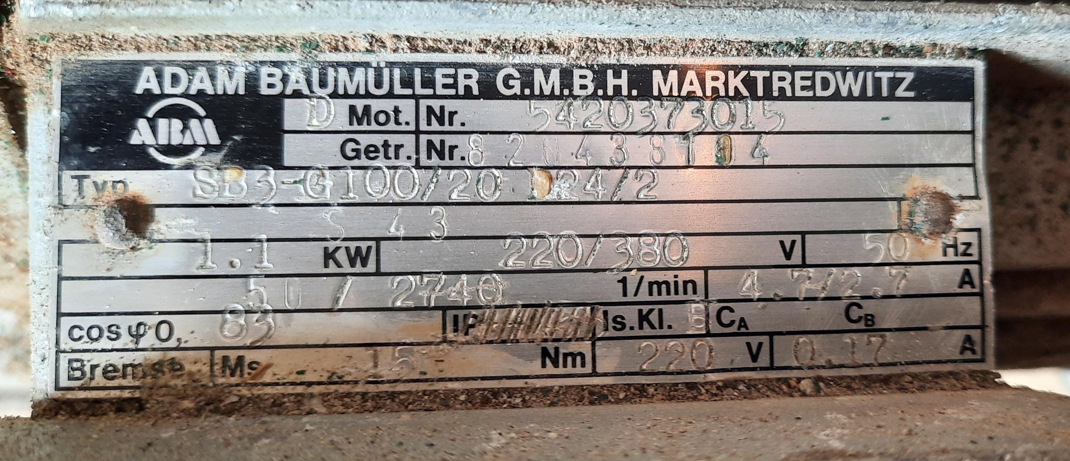

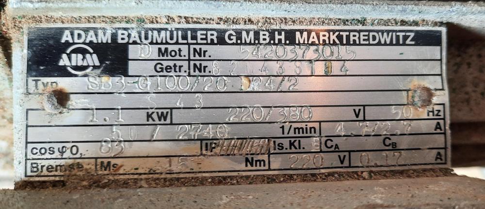

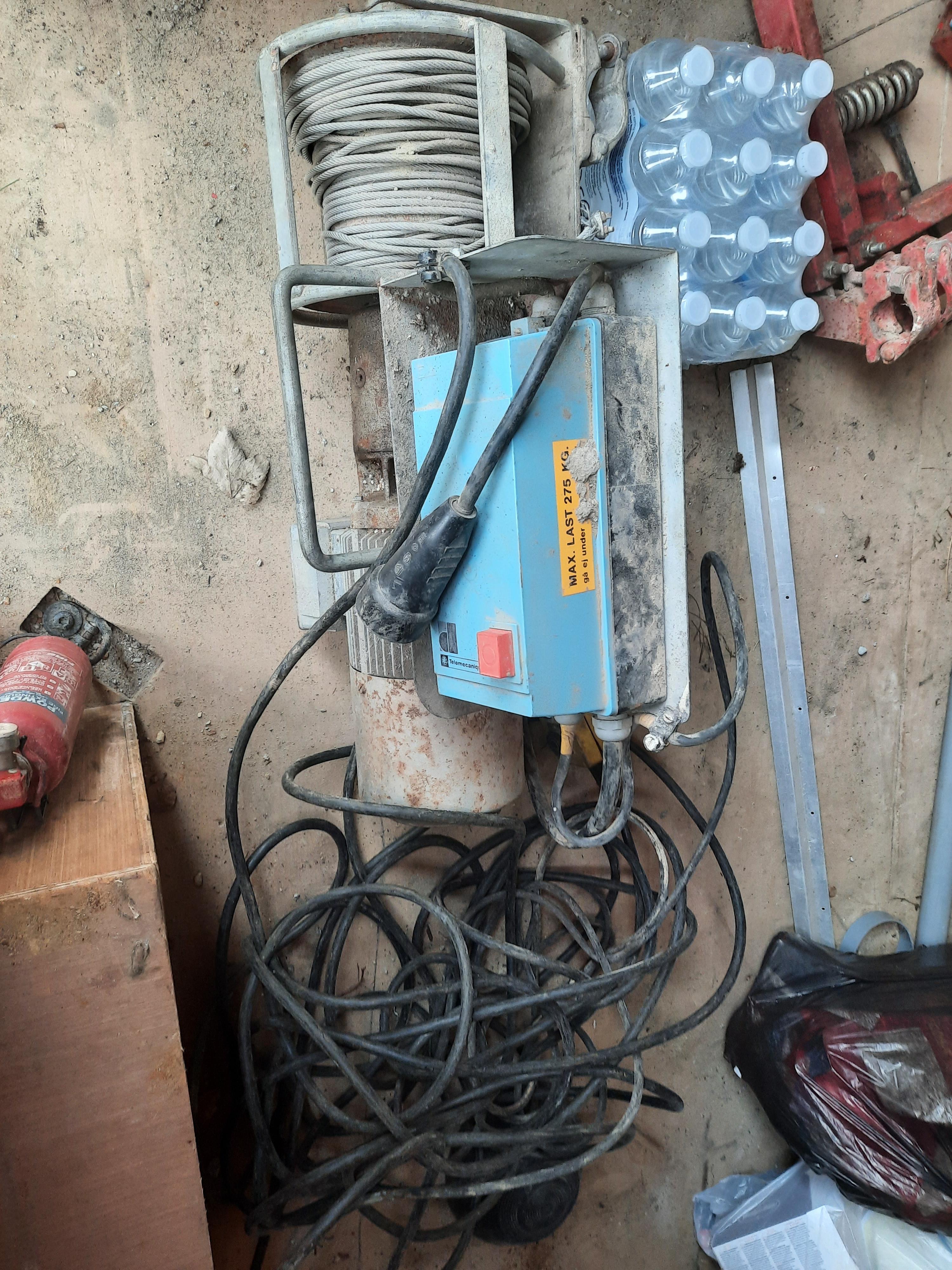

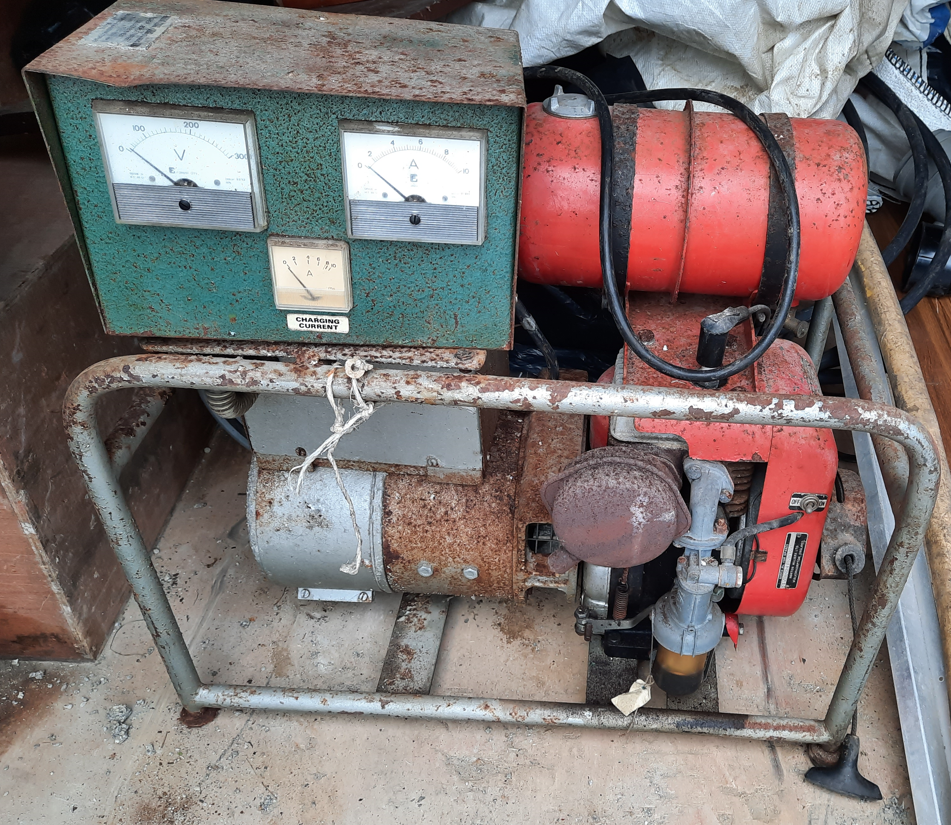

  2. Waiting for the equally antique generator to be serviced (villiers engine) and wondered could I put on a standard 13 amp plug on this wonch and test it? The only thing is there are 3 brown wires and one yellow/green. How do I wire it?

  6. Hi, I was going through my dad's old stuff and found these. It needs a plug, does it have to be a round one to go into a generator or could it be a standard one that we could power via a temporary consumer unit? We will need to get material up to 1st floor.

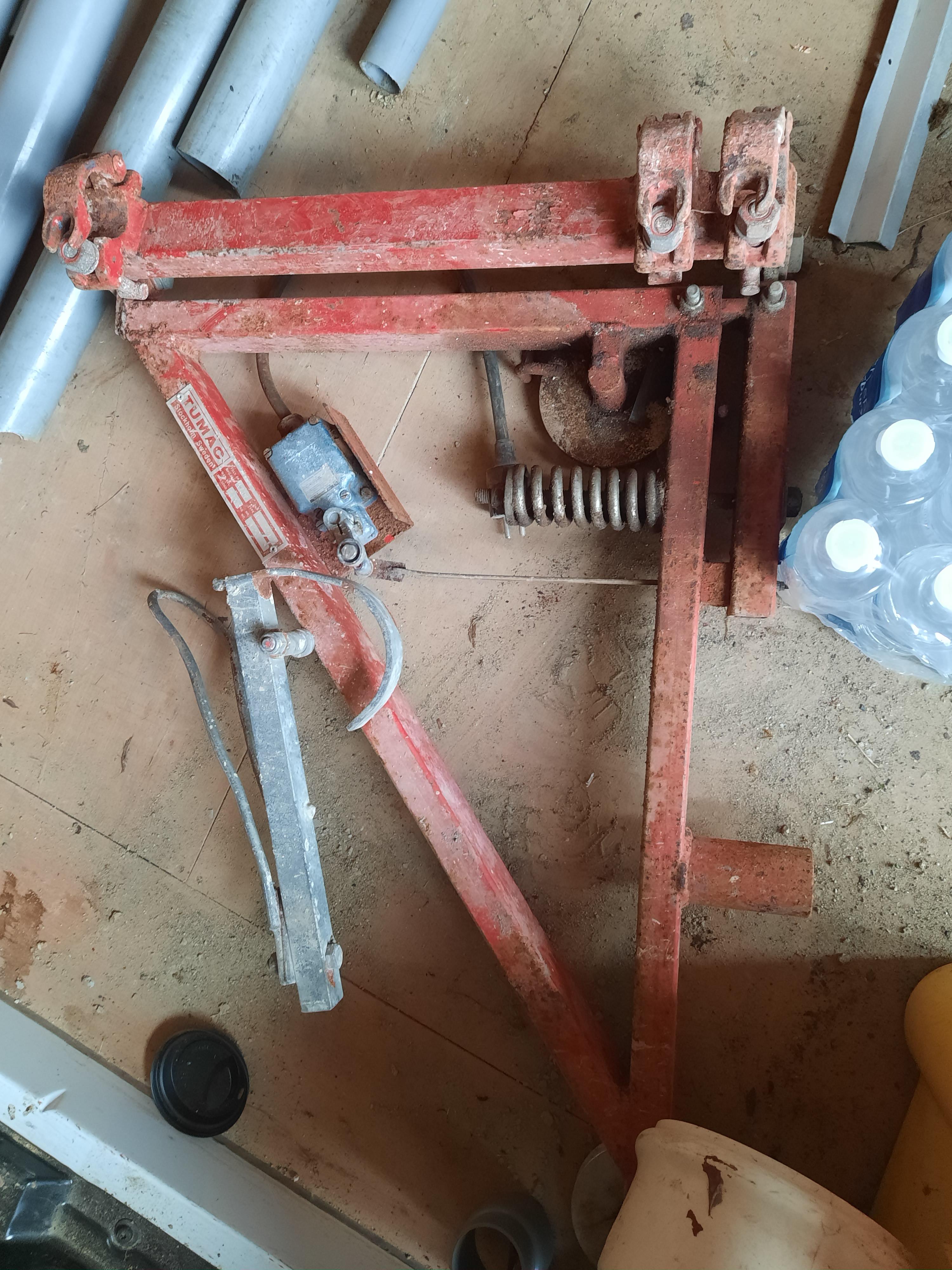

  17. What are the methods to lift blocks up on a site? Looking at the most cost effective options. What about a winch? My dad (deceased) left one in a container. I know he used it years ago on a site.
