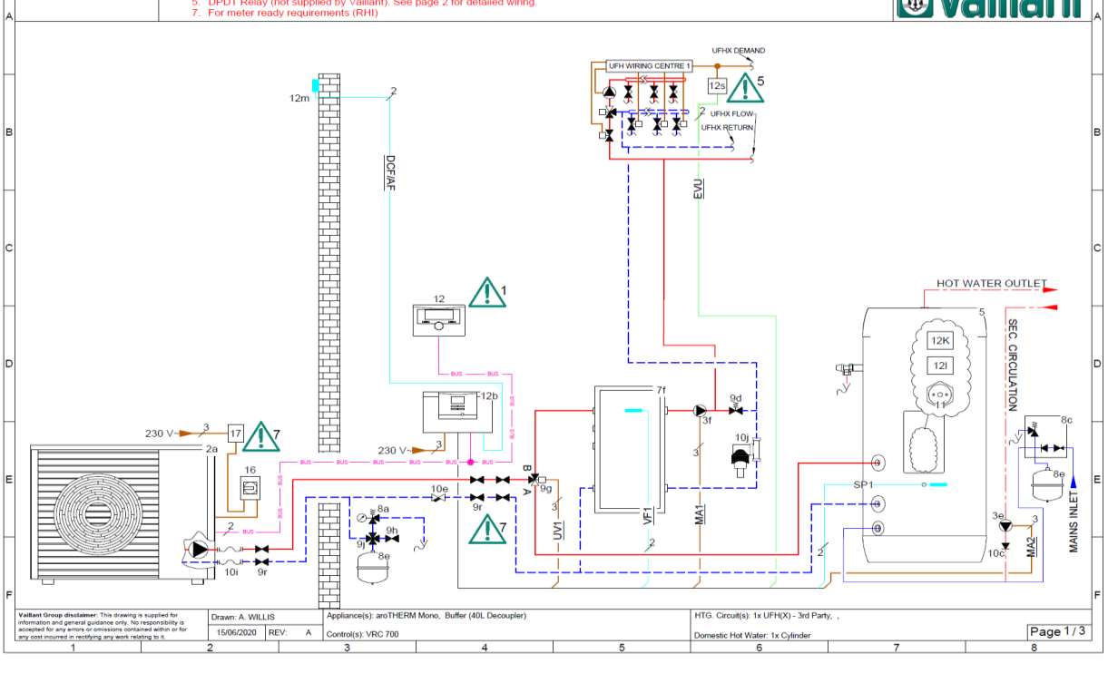

  4. Hello, which refrigerant would you opt for and are there any brands/models of ASHP that you would stay clear of?

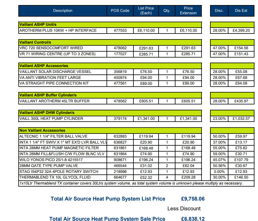

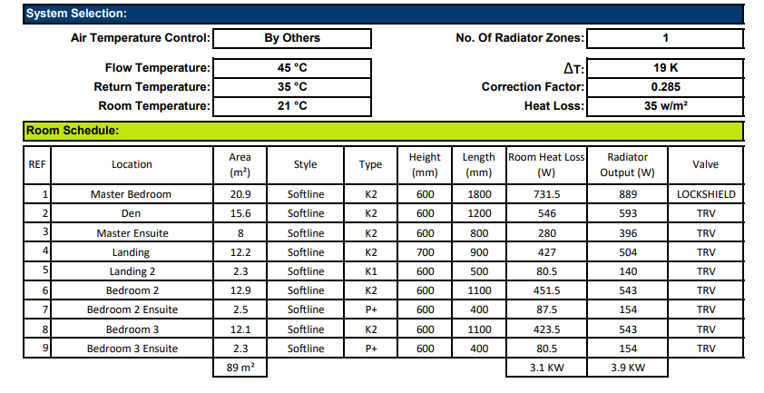

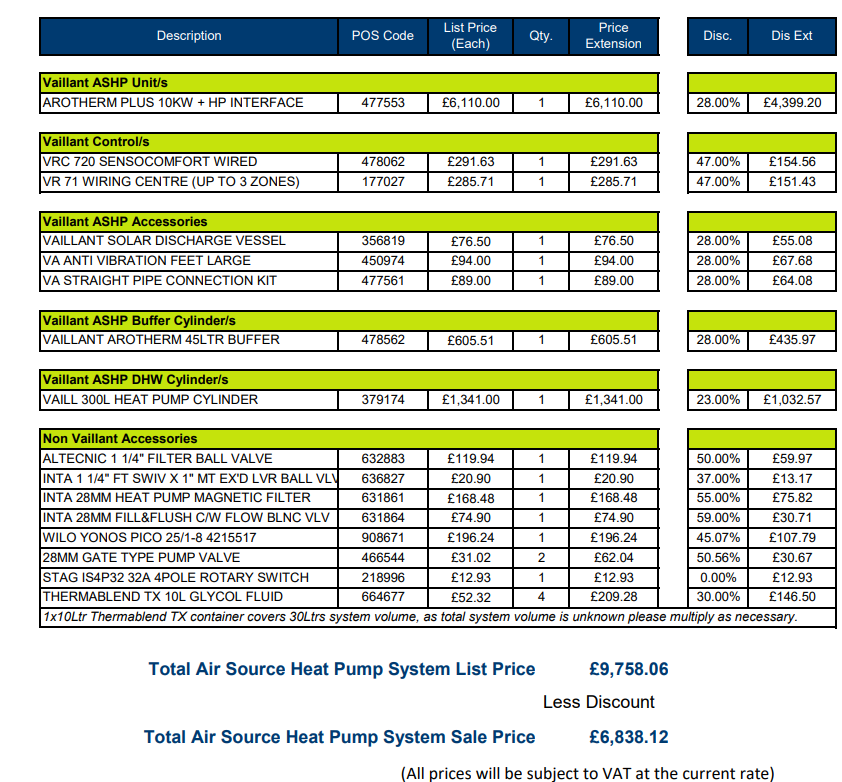

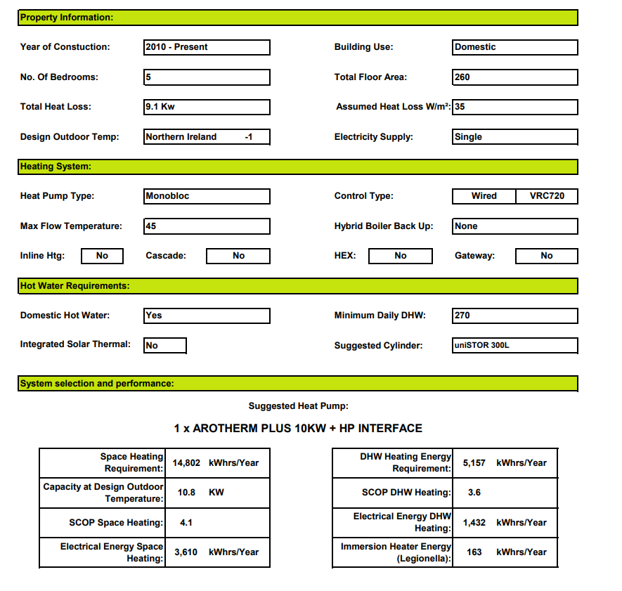

  16. So 2nd quote in and it gave quite a lot of info. Only thing is they missed that it's 3 phase. Is there anything you think I should ask? Also I thought we had to get aluminium rads upstairs?
  17. The plumbers merchants has a special dept that sells them and specs the radiators etc. Ok thanks will try and use the midsummer option and maybe look for a mechanical services person

  19. Who could I send my plans to so we can get the plumbing done to suit the ASHP so pipe sizes and radiators, ground floor is correctly sized and we can get on with it while shopping around for the actual pump or even go 2nd hand? A lot are ripping them out I hear due to crazy electric bills. Ni hasn't got its grants in place yet, nor sufficient trained installers. The plumbers merchants told us we would need a 10kw ashp so looking on eBay just to see!
