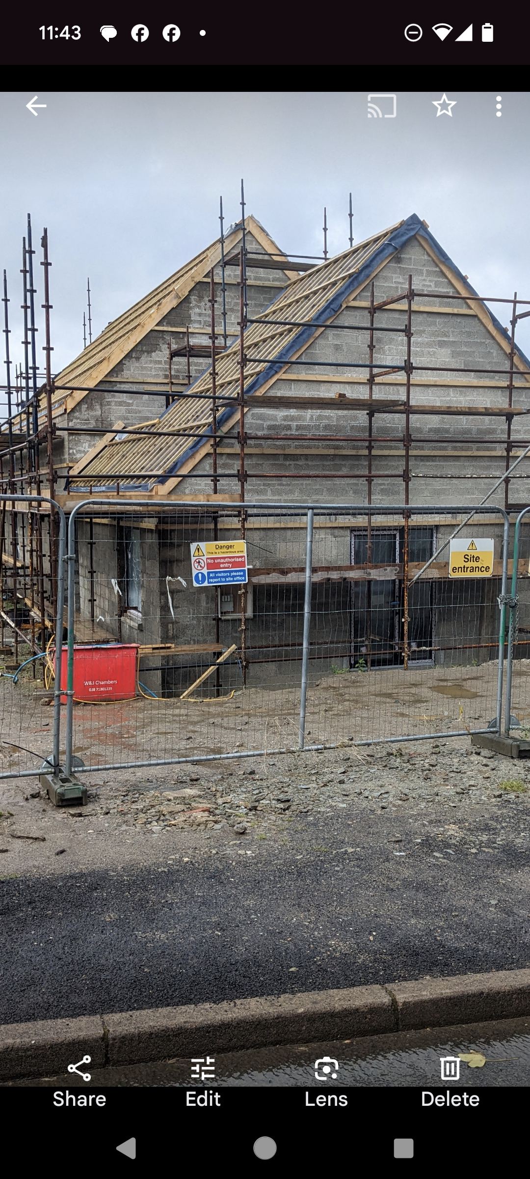

So joiners are coming back to put extra battens on the smaller of the 2 roofs so we can put up solar panels at some stage. Then they are fitting the metal roof. We might put the panels up while the scaffolding is up but I don't know whether to hold off because pv news is full of incredible percentages of solar efficiency to come. Oh and we are doing the pir in the floor and using an ashp. My question is what distance should we have the battens to suit whatever panels that may be available in the future? Also am I stupid for not putting extra battens on main roof too to allow it to be used for solar in the future especially as we have a 3 phase connection?

Right, gonna get some at these prices and with scaffold up I would be daft not to. Please tell me which, minimum 5kw and we will have a corrugated roof. Saw these, any use? https://www.ebay.co.uk/itm/375313125698?mkevt=1&mkcid=1&mkrid=710-53481-19255-0&campid=5338365712&toolid=20006&customid=EB208005756&
