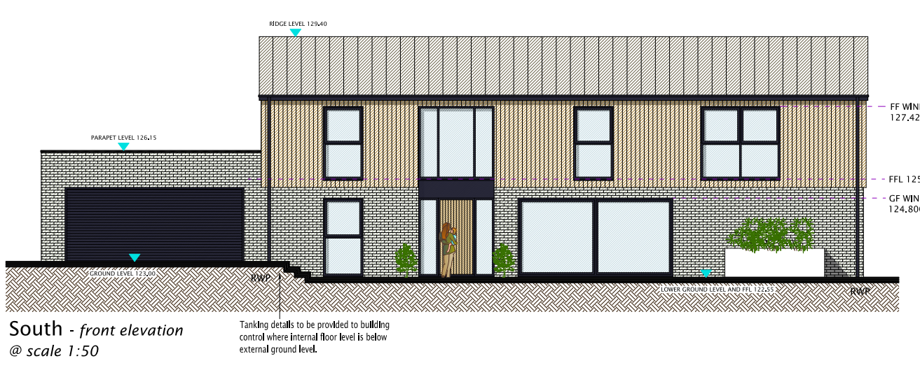

  23. Thanks nod. That looks perfectly adequate. I think the architect thought he was designing an entrance to a HGV yard.
  24. The driveway that has been specified on our granted planning application is 7.7m wide. I personally think this is too large and wonder what is a more suitable width. The plan is to have a single leaf electric sliding gate.
