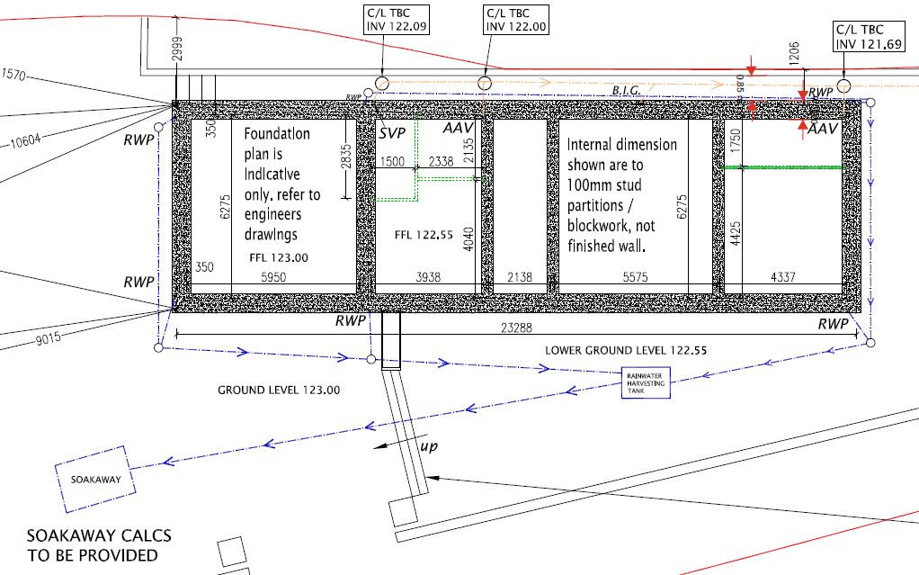

We have a level threshold around the whole house and therefore we need to install ACO drainage. As space is tight down the back of the property, I was wondering whether the downpipes from the guttering can feed into the ACO drain, instead of having to have a separate pipe system for the guttering downpipe. The tech architect who did our drawings has drawn an ACO on one drawing, but then seems to have drawn standard underground 110mm pipe for the guttering.
So that is quite straightforward should I need / decide to go down that path?

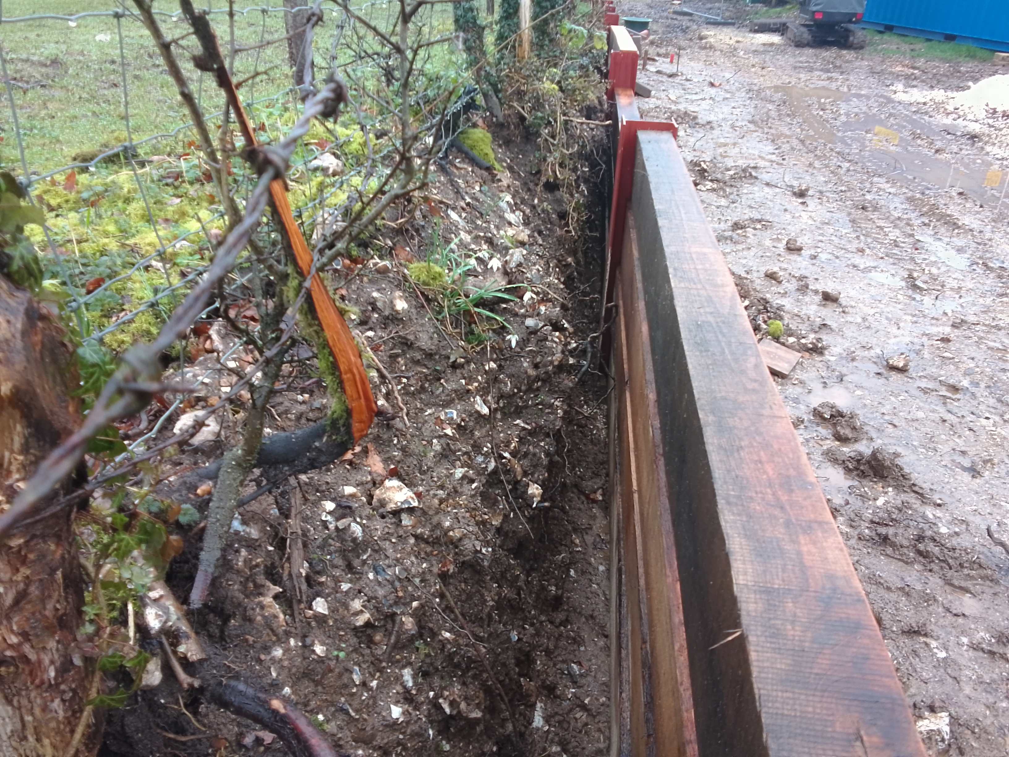

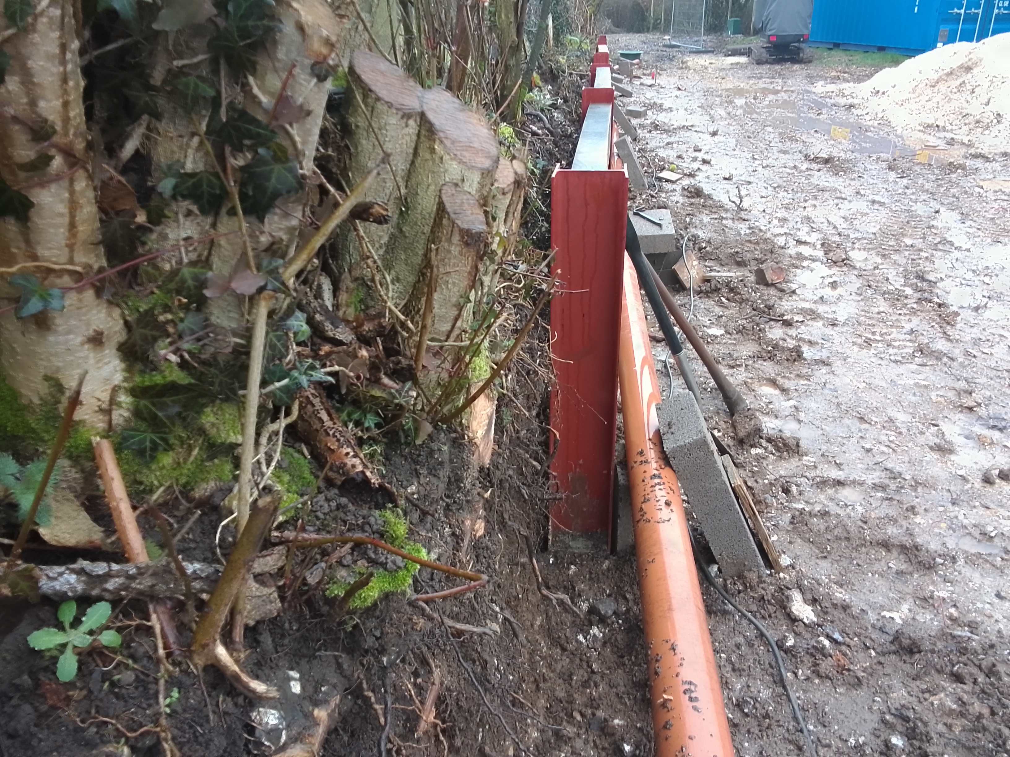

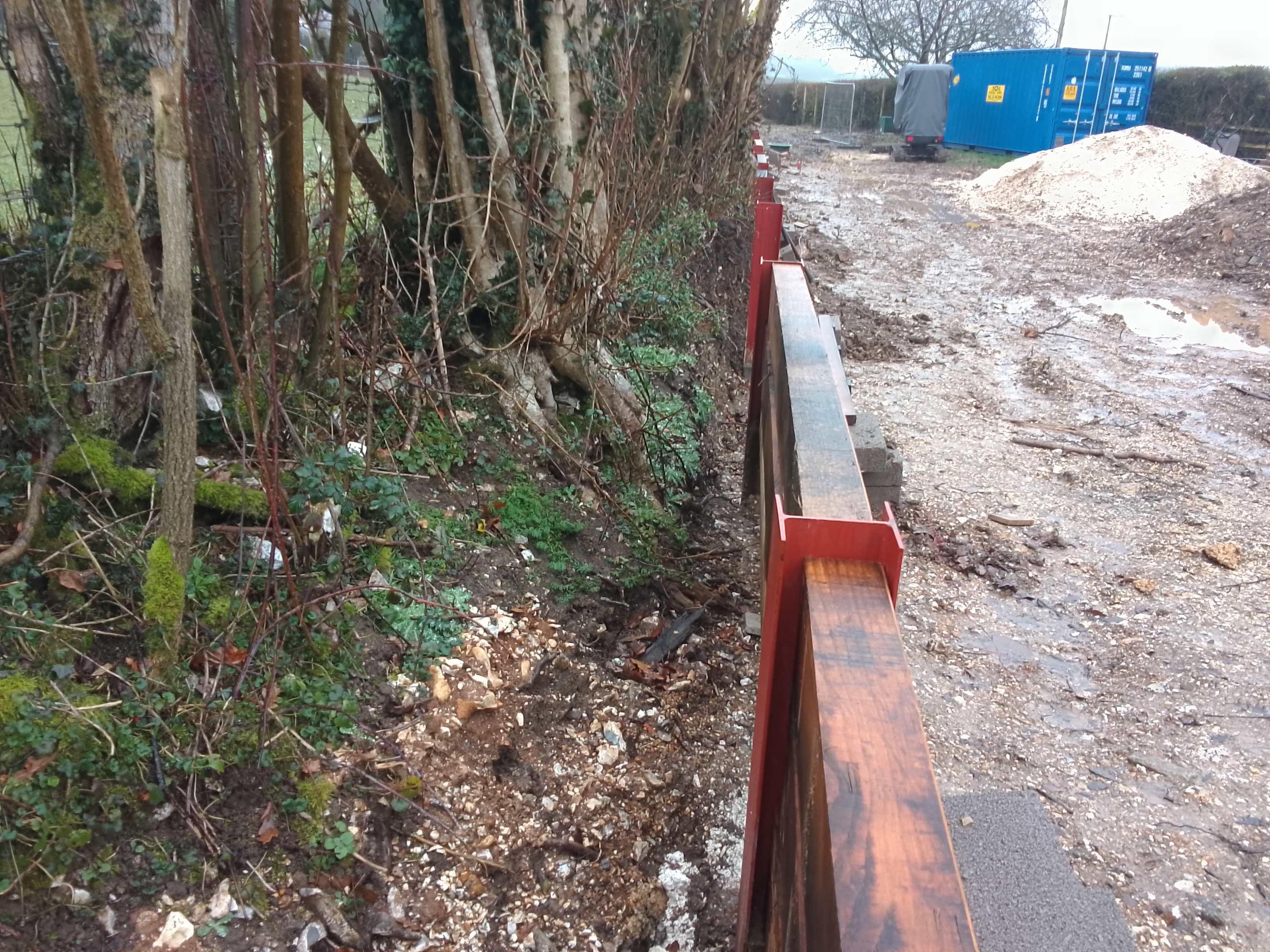

I've put in a oak sleeper retaining wall. The sleepers are installed so that they'll slightly below the gravel path. The will allow me to put hardcore / gravel underneath them so they are not sitting in soil. I keep hearing that I should install a french drain behind the sleeper, but as you can see from the images below, that is nigh on impossible due to the boundary and hedging. If I was to excavate a trench between the steels and fill that with rubble, would that suffice? I was also contemplating putting a 6mm steel plate behind the sleepers so I could bolt (stainless) each sleeper to it to help keep them inline and reduce the possibility of bowing. I wasn't sure whether the centre plate should also be concreted into the ground? The was is not very high, but just don't want it looking a mess. In hindsight, I wish I'd just ripped the neighbors 'hedge' out and had a block wall installed, especially given it's down the back of the house and future access with an excavator will be nigh on impossible.
