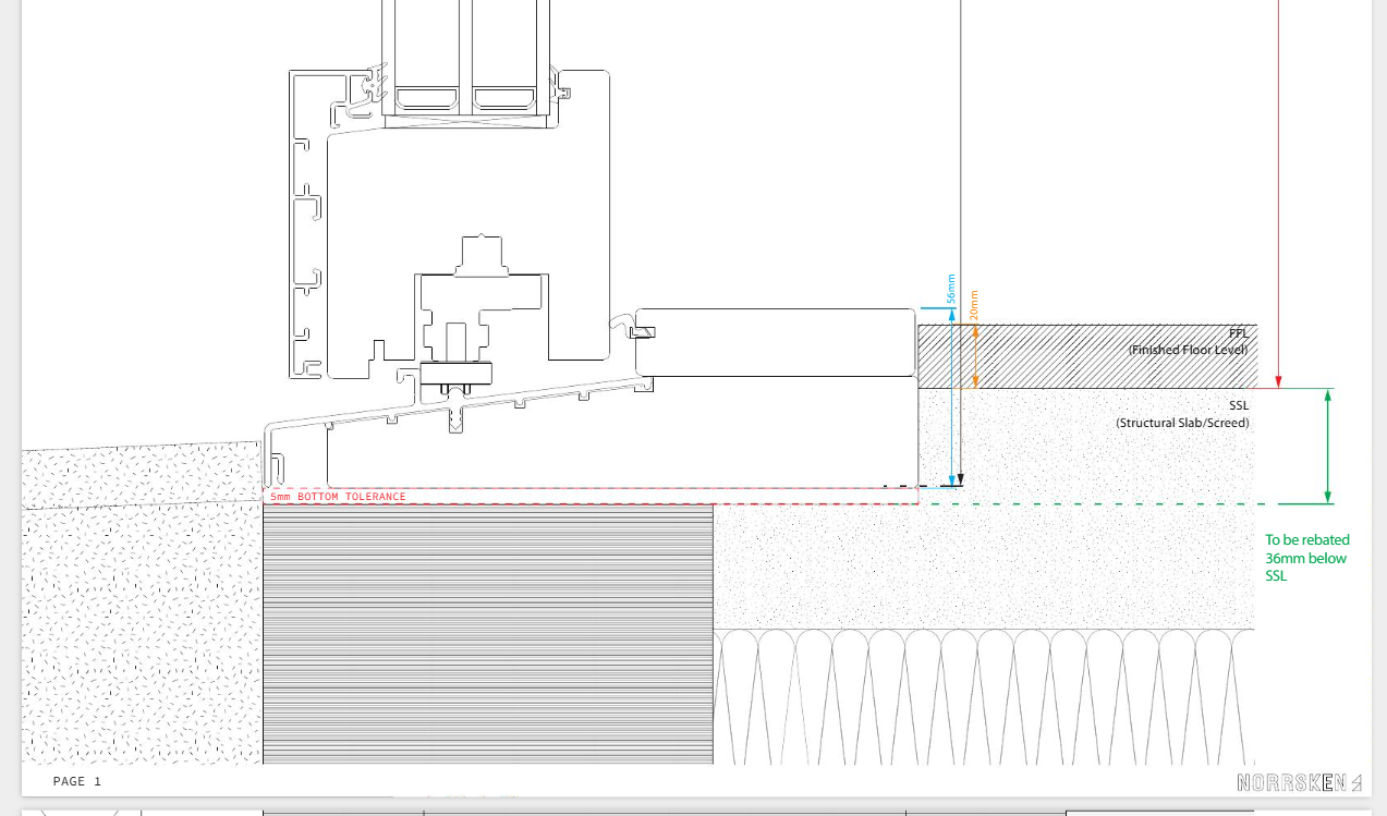

  21. So I receive the below from Norrsken as I am trying to understand the required build up for the sliding doors. Front edge to back edge dimensions of the cill is 204mm. This will therefore mean, that the back edge of the door will sit directly over the 150mm cavity. I am not sure whether the detailing below is for the European market, but the outer leaf is clearly not brick as it is > 1/2 the width of 204mm. Does anyone have a cross section detail. I am keen to understand how the insulation / screed and inner leaf brick / block course is adapted to get a 'level' threshold.
  22. I wrongly assumed that regs drawings and construction drawings are the same thing. This is because my brother in law used the same chap for his drawings. Just for my own understanding, how do construction details differ from building reg drawings? when I gave our drawings to an SE, he just did calcs for the steels. He didn’t make any mention of what concrete blocks …
  23. But isn't that what the technical architect is supposed to do? Building control have signed off the drawings, but still so many questions. Now I'm beginning to understand why the original architects wanted 10k and this guy only charged 2k
