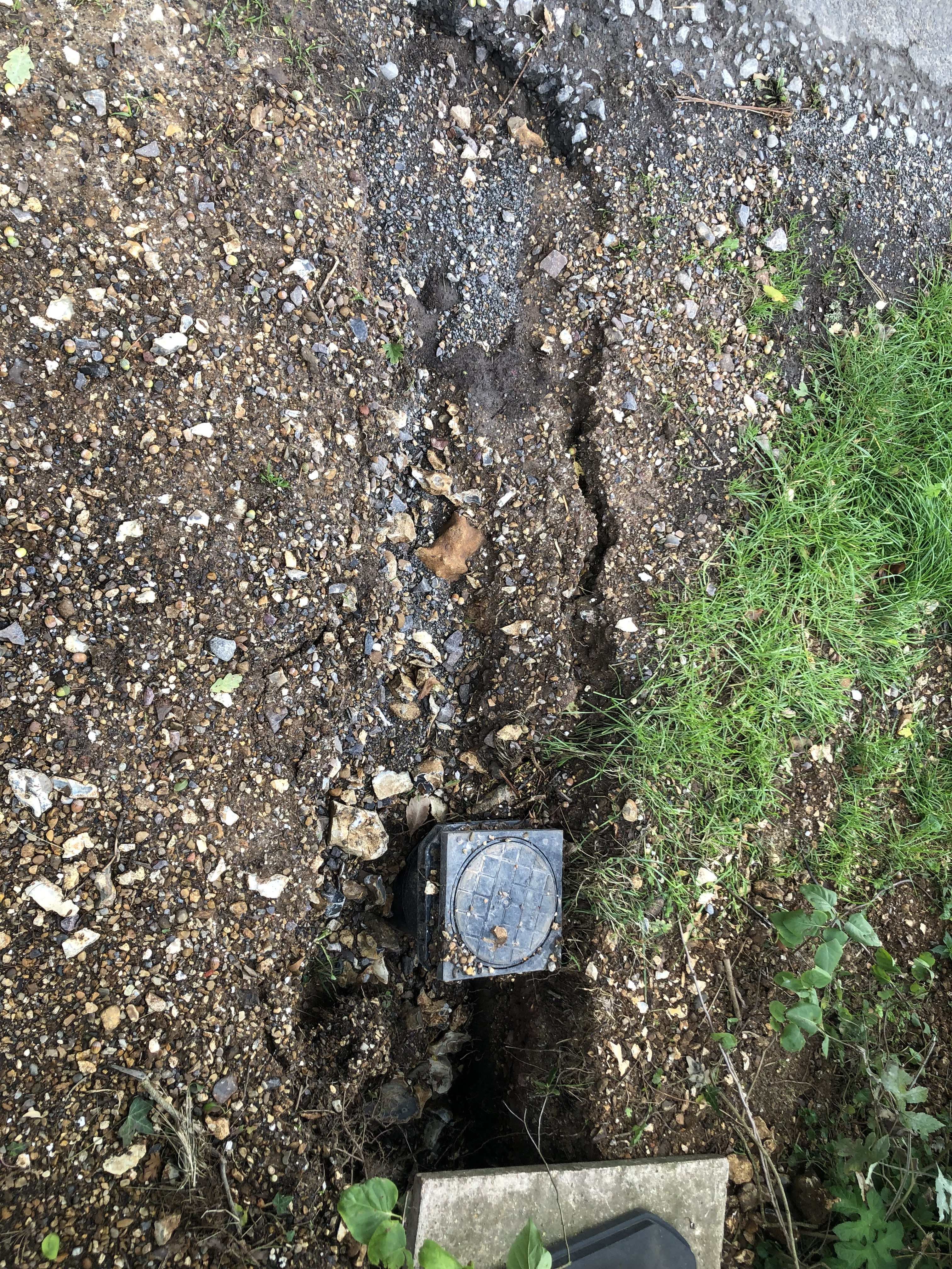

  8. I am terrible for overthinking things and am really struggling with the best way to install the water connection to the static caravan and also to the yet to be started house. The image below shows what I have done so far. I have pulled a trench to the boundary and also then a trench to where the static caravan will go. The issue I have, is that the water board want to inspect the pipe before they will connect us. My original plan was to just put the pipe in for the TBS, but pull the trench slightly further into the plot so that I could have a tee feeding the TBS and a capped off length of pipe. Once the trench was filled and we had water, I could then pull the trench for the static caravan when I need to and the pull the trench to the house. These would obviously be done at different times, as the site has not been cleared and cannot be started until we have our conditions discharged. The LPA have confirmed that we can put the water in for the static as this does not constitute development. I don't like doing jobs twice and burying a pipe, only to dig it up later and connect to it seems a pain. I also don't like having joints underground, but given I need to have water to a static and a temporary standpipe, I am not sure how I can avoid it. It would be fine if the water company didn't want to inspect the TBS before connection as I could simply leave a coil of pipe above ground, but they want the pipe buried. I don't understand why they simply don't just install a double check valve at the meter and then any risk to contamination is handled. The circle on the roof is the plant room and where I will feed the mains supply to. Note. The driveway entrance shown is a new driveway and the shown patio ... does not exist. It's currently a wasteland.
