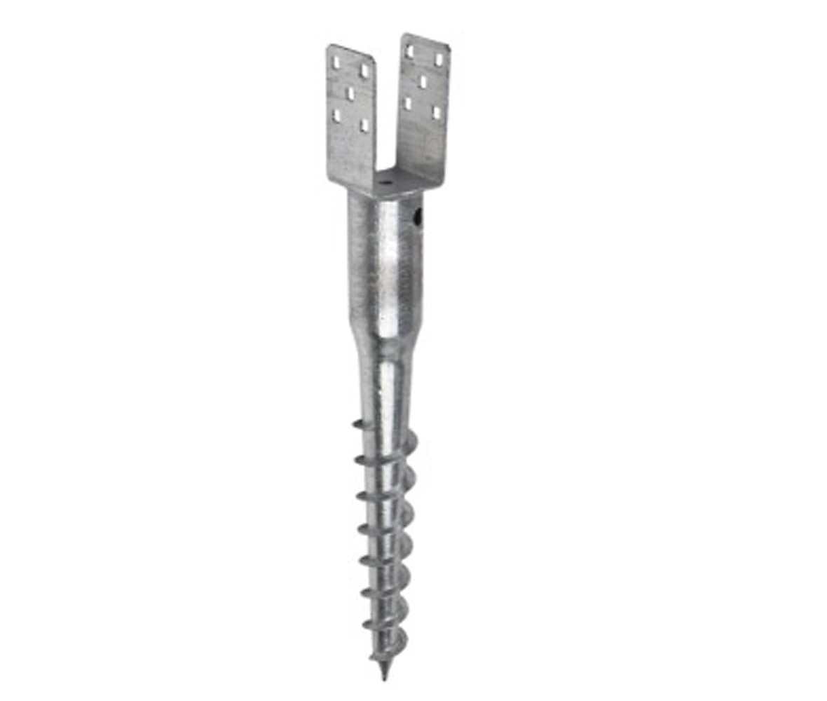

Oddly this is a building where these little screw piles might be appropriate. Ie as no regs. As wrongly assumed earlier. Screw in piles, then timbers spanning them, then joists. There would be a void underneath. For clarity i only mean these, not big time proper piling. At b&q for patios I expect. Prob best get longer stronger ones than these.

That was one of the questions I put. They knew nothing. Such screws are a possibility for a garden room, especially if you want it raised. Also for a temporary building eg a beachfront shack. For an extension it must perform the same way as the house. It needs building regulations, thus an SE. Tell us more. What type of tree and the distance? Is the ground clay or what? It would be interesting though to get more info from these screw suppliers.
@Jadhacha what Are they charging for these screws? I agree with @Nickfromwales unless these are £20 each. I've had a chat with a screw supplier at a construction show. . They didn't appear to know anything so I think were franchisees.
