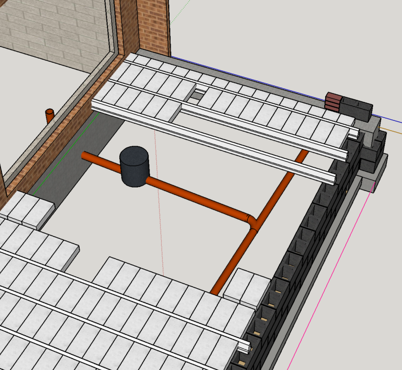

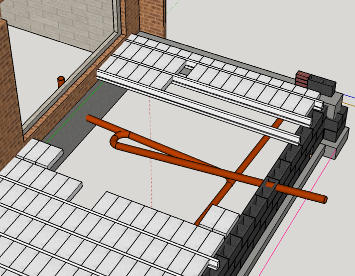

  2. Splendid - spoke to BCO and Rodding point riser in the kitchen is the way to go - thanks all for your input. Onwards to the next obstruction.
  3. this is as is : so could simply remove chamber (black cylinder) and add double sealed inspection hole under kitchen sink or remove chamber and replace with the below - of course with a rodding eye fitted on the external end of the pipe. All 200mm radius bends
  4. In digging out for block and beam for new extension to kitchen just found an 30cm wide ish chamber hidden under the existing paving. It's not on the public sewer. Could I add a rodding point to the incoming 110mm piper under the kitchen sink or do I have to install a new rodding point from outside the new extension ? I'd replace the chamber with a new y connector and connect it to a straight run to a rodding eye outside the extension - but as it's a terraced house it can't just be to the side of the extension instead a 180 degree long radius bend is required. Seems counterproductive - but of course don't have to deal with a kitchen drain clog from within the kitchen. Has never happened in the last 20 years at least. Any thoughts ? Cheers
