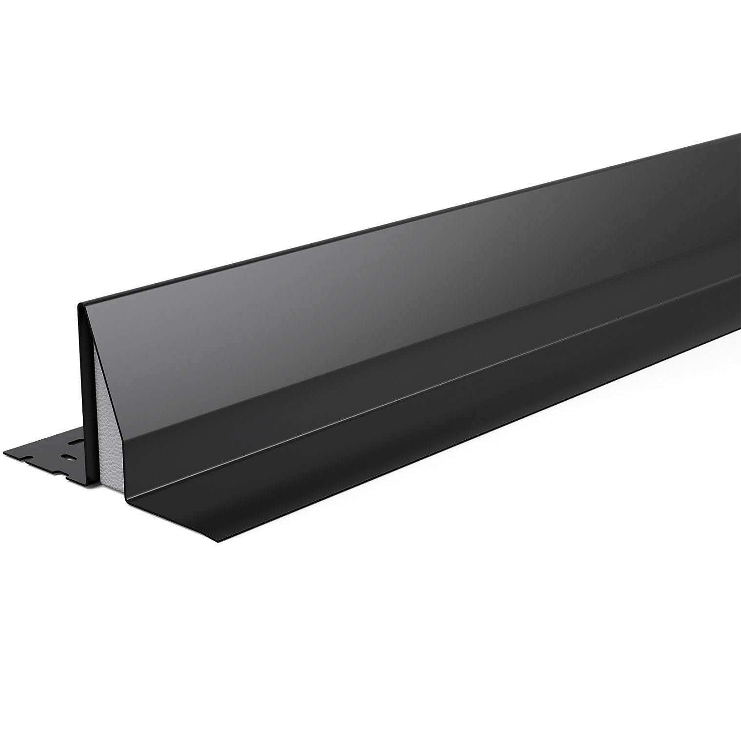

I'd never heard of this despite building 300+ steel buildings, so thanks fof widening my awareness. The website is vague about why it is supposedly so good , and even what the coating is made of. Can one if you tell me briefly? That's for a window sills manufacturer to decide isn't it? It might depend on the folds and how much the coating stretches.

ouch. i confess that i didnt know this happened. At least the structure wont fail, just the facade. I'd expect somerhing like this image, pehaps without the insulation. I thought this was standard. You might find yours as a plate about 10mm to 20mm behind the mortar face. Or have one brick gently removed for inspection behind it. Repointing. The cracks may close a little when the ground becomes damp again, esp on clay. So don't fill the cracks until springtime. Do you know what the ground is? Clay, sand whatever How far are any hedges or trees from the front right corner? -
