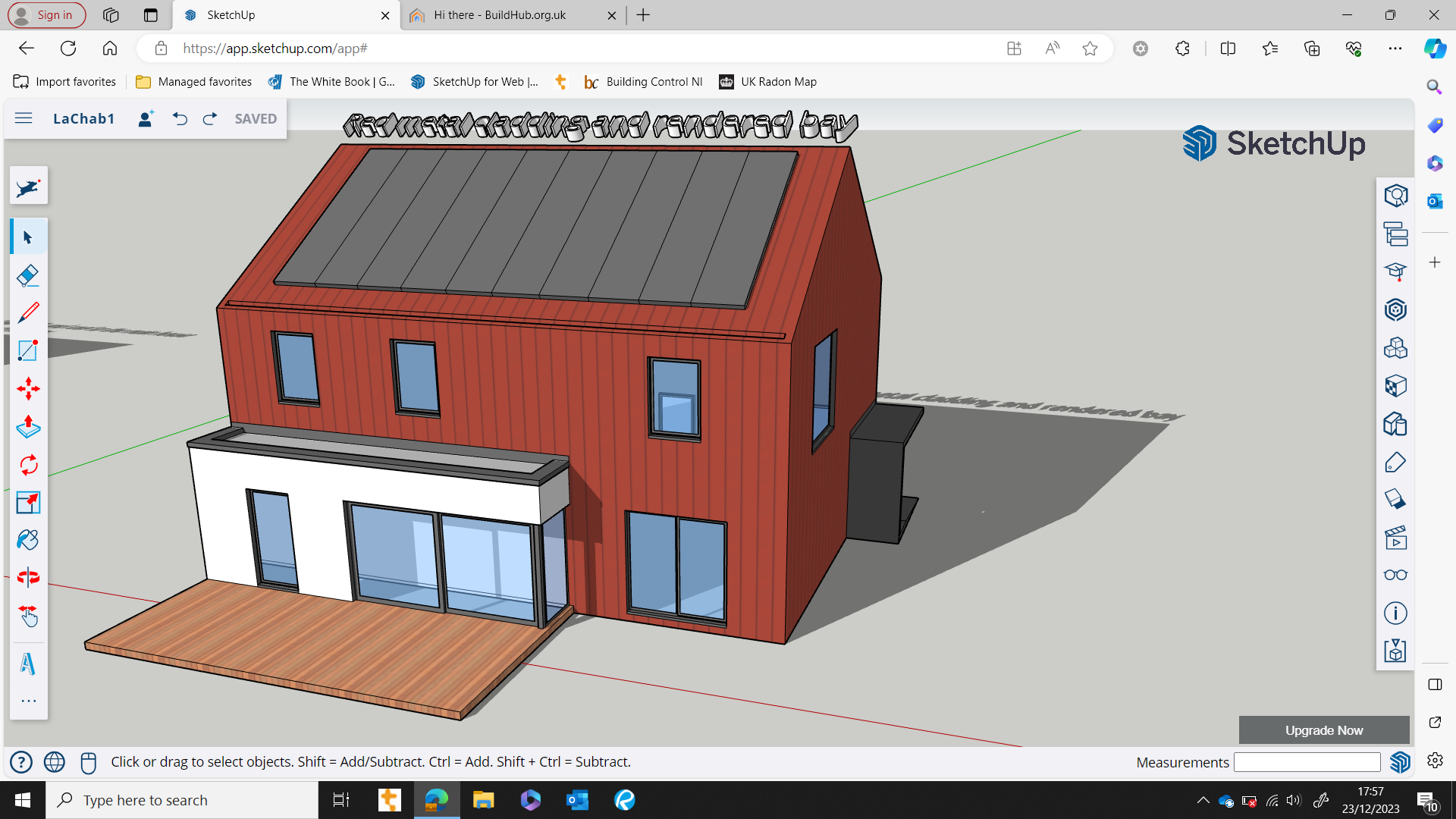

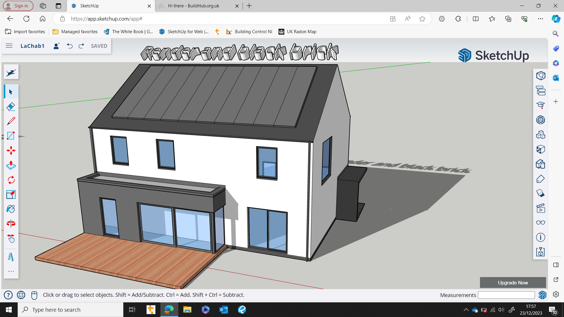

  3. Put the master suite across the back of the house and move bedroom 2 to the front of the house. The two rear gables are that close to being equal that they look odd. Equal them up. The porch is a wee bit twee as well.
  4. The front and rear elevations look like two different houses. And what’s the craic with the funny angled kitchen/dining and covered patio?

  16. Make the kitchen dining and living a single volume. Put the bathroom in the middle of the bedrooms - saves a hike from bedroom 1. Relocate the stairs and have the second floor above the bedrooms only.
  17. My plan has a particular massing to reduce the overall impact of a square house.
  18. If you want I will design it for you. Just let me know.
