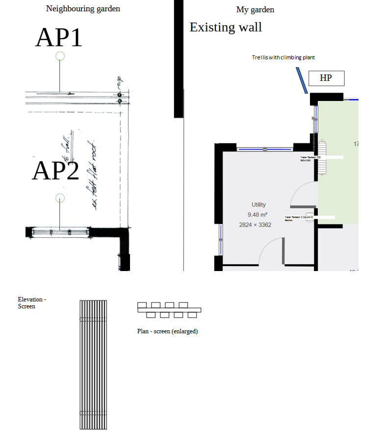

Screening design for heat pump - comments invited
ReedRichards replied to JamesPa's topic in Air Source Heat Pumps (ASHP)

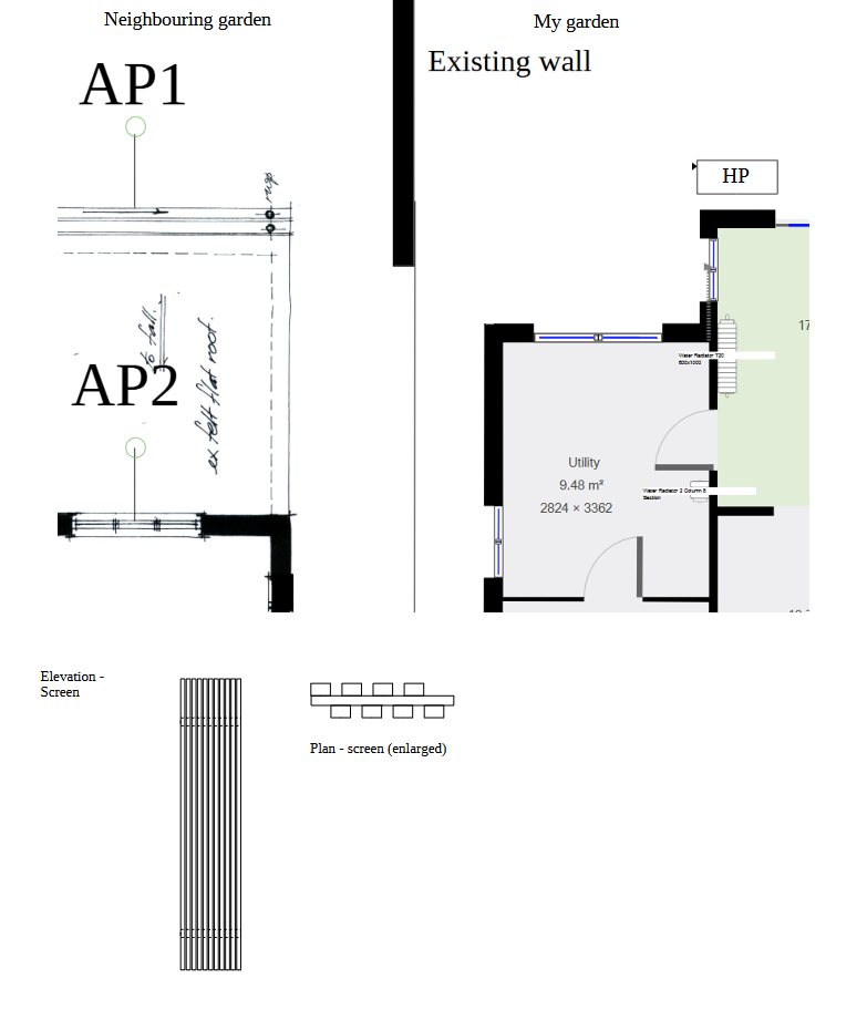

Use trellis with attractive climbing plant grown up it. Planted in it's own container if it cannot be planted in the ground: Blocks view of heat pump from AP2. Deflects some noise and muffles it when plant is in leaf. Blocks 10 cm projection of heat pump beyond end of wall. Provides attractive plant to view from Utility window. Cheaper option than complicated sound screen. -
Yes, but it doesn't get overlooked by two windows, one of which looks out onto the garden. And it doesn't place the heat pump in a little sound-broadcasting enclosure. -
Isn't it going to obstruct the door? Why not move it up and to the right (on the plan view). Or is that a bay window shown on the side elevation? -
Not necessarily! Your system will have a design temperature, actually two - one for the UFH and one for the radiators, which will almost certainly be a higher temperature. If your radiators were sized so that they need to run at 50 C when it's -2 C outside and the calculation for this design was correct then that is what you need to do or the radiator-heated floor will be too cold. Of course, if your radiators had been sized so that they could run at 45 C when it's -2 C outside then should have given you a heating system with a better COP but maybe you didn't have room for radiators that large?
