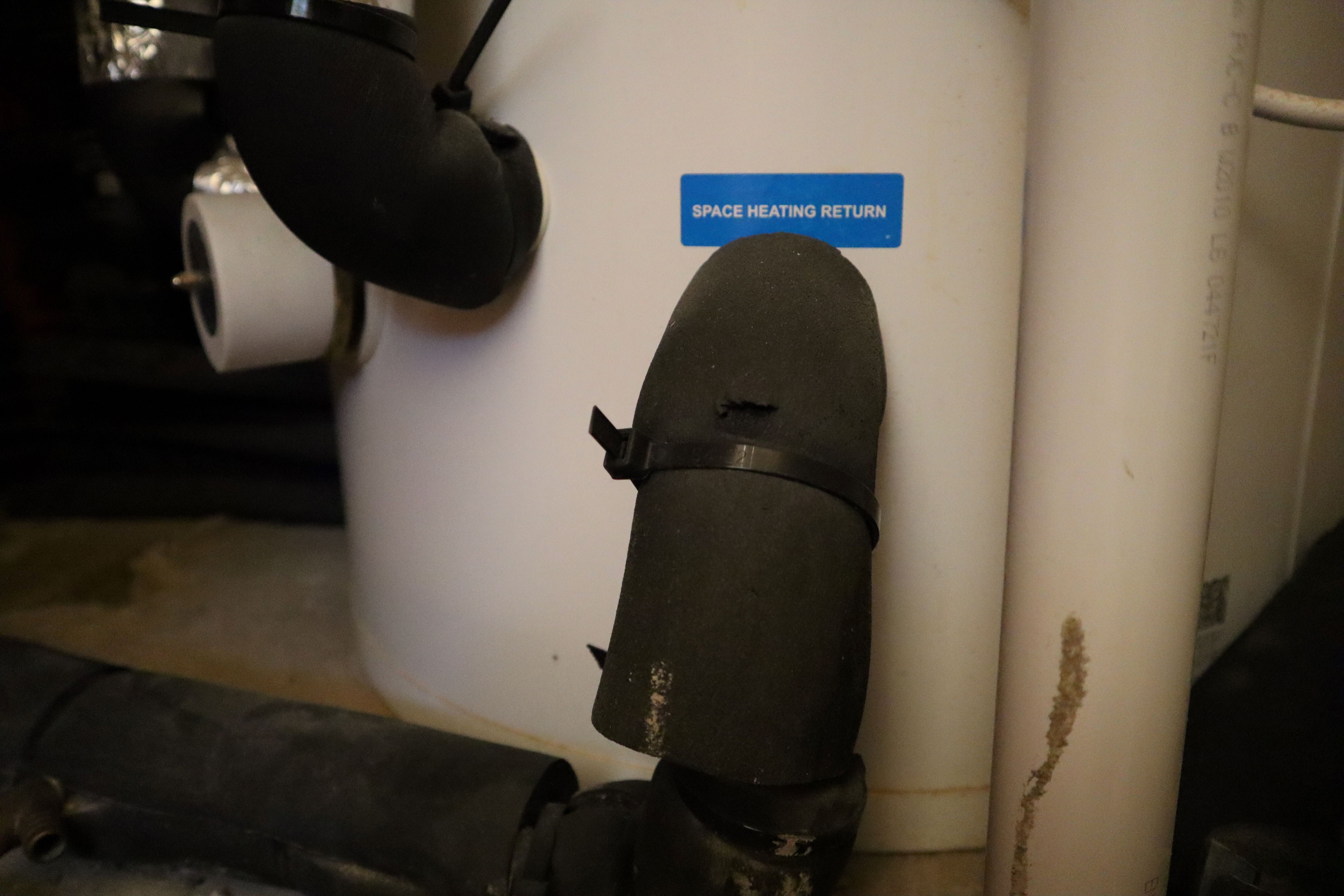

  2. Maybe we are talking at cross-purposes? I was referring specifically to Caleffi's 3-port buffer tank configuration in my last two posts. Also, my buffer tank is integrated with, and sits directly below, the DHW tank. It's short and squat, which I imagine are the worst dimensions to avoid stratification. Here is a picture. That's the heating flow on the left and return on the right. The input/output ports to/from the heat pump are round the corner at the same heights. I don't think this corresponds at all to the buffer tank configuration you have in mind.

  10. Mine doesn't. The manual states that a minimum water volume of 50 l is required and suggests alternatives of a volumiser, a low-loss header or a buffer tank (a 4-port buffer is illustrated). if you have a 4-port buffer then the input water to the heat pump has come straight out of the buffer. And either the water gets completely mixed in the buffer or a probe is only measuring the temperature of that part of the buffer in which it is positioned. Sorry about the confusion over the temperature data I reported. One thing I am thinking is that weather compensation alters the target temperature of the water leaving the heat pump. But perhaps superior weather compensation would reduce the target temperature differential across the heat pump or alternatively reduce the pump speed as the outside temperature increases.

  14. Here you are, @JamesPa. I have a 4-port buffer integrated with and underneath my hot water cylinder. My LG therma V 12 kW heat pump is set to do Weather Compensation but a Drayton Wiser thierd party controller overrides the LG one. I have two zones, one for most of the house and one for the 3 smallish bathrooms. The heat pump reports its output and input flow temperatures. I have personally insulated the pipes between the heat pump and the buffer using Kingspan phenolic insulation and that appears to be effective. It also makes measuring the temperature actually at the buffer inputs and outputs rather difficult, will you accept the heat pump temperature data? This only updates about every 30 seconds so I think some of the details about what happens are lost. At the moment it is warm out and my heat pump operates in 20-minute cycles. At the start of each cycle the inlet and outlet temperatures are typically around 35 C. When the room thermostat calls for heat the internal heating pump circulates water from the buffer for a approximately two minutes. The external pump then comes on. This runs for another two minutes before the compressor turns one during which time the inlet and outlet temperatures fall by a few degrees as the cooler water from the heating system reaches the heat pump. In the next stage the outlet temperature starts to increase, initially on its own. The outlet temperature lags about 5 degrees behind. This morning it got to 40 degrees out 34 in and the main zone cut out as warm enough. This left the smaller bathrooms zone which is required to be warmer at this time of day. This got to 45 in 40 out before the heat pump cut out even though the thermostat was still calling for heat and the pump was circulating water around that zone. The maximum power drawn was about 3.5 kW for a 12 kW heat pump. In principle the maximum output temperature should be 41 C at 5 C outside. A few minutes later and both zones now back on, both pumps running but compressor still off. Flow temperatures have dropped to 36, 36. now 37, 33 as compressor comes back on, then 37, 32, then 37, 33 main zone off, then 39, 35, then 40, 36 , then 41, 37, then 42, 38, then 43, 39, then 43, 40, then 44, 40 and compressor off. maximum power about 2.5 kW. Internal pump on bathrooms zone runs for a couple of minutes longer. Now no call for heat although the bathroom thermostat is 1 degree short of its target temperature (main zone at target). The second cycle, which I recorded completely, ran from 07:25 to 07:45. So at the moment the heat pump has the difficult task of maintaining the temperature in most of the house whilst trying to warm up three smallish bathrooms. But this is the real world.
