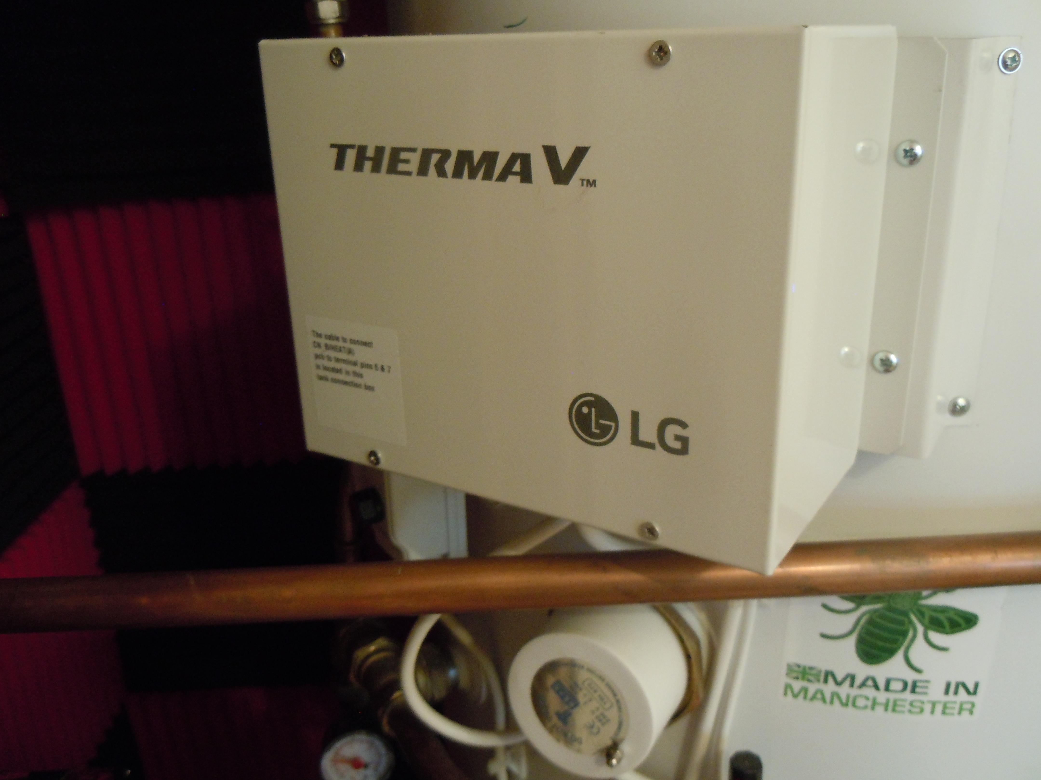

  2. On the outside of my hot water cylinder is a large box (see picture). I don't know if everybody gets one of these but it's function is to allow the LG controller to turn on the immersion heater (that is just below it) which heats (or can heat) the DHW. AFAIK this is used solely to raise the temperature of the water to 60 C for the legionella cycle. To use the Willis heater as well would be belt and braces, surely? And if you could use just the Willis heater then that big box would be redundant. What you can't quite see in the picture is that I have two wires going to my immersion heater. They are both on the same circuit but one goes via the box and one goes via a switch that I can operate independently. I just wondered if that was the norm. I had to do a bit of persuasion to get it done that way and I was chatting to someone who "lost" their immersion heater switch when their new cylinder was installed.

  5. Question: Can you operate your immersion heater independently of the heat pump? I had some teething troubles with my heat pump when it was first installed and the error code on the controller meant that I lost all control. I wanted hot water but found that the switch for my immersion heater had been wired in series with the internal switch so I had to do some emergency rewiring (then get the electrician back to fix this). Now I am reading of another instance of someone in the same situation. Surely it should be standard practice to ensure that the immersion heater can be used independently?

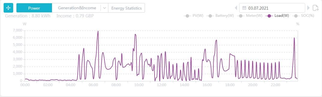

  6. Just FYI, this is my entire house electricity consumption for 7th March. The highest peaks are mostly heating the hot water but could be cooking.

  8. @ProDave, May I ask what relay you actually used (make and model)? I seem to remember seeing something inside the big box on the side to which the thermostat is wired that looked a bit like a relay (a large component inside a transparent box). At the time I was looking to see how I could correct an error by the installing electrician who had wired the immersion heater in series with my own time switch instead of in parallel. This was when I had the CH14 error and found I could not even use the immersion heater when the heat pump was not wanting to play ball. That is corrected now.
