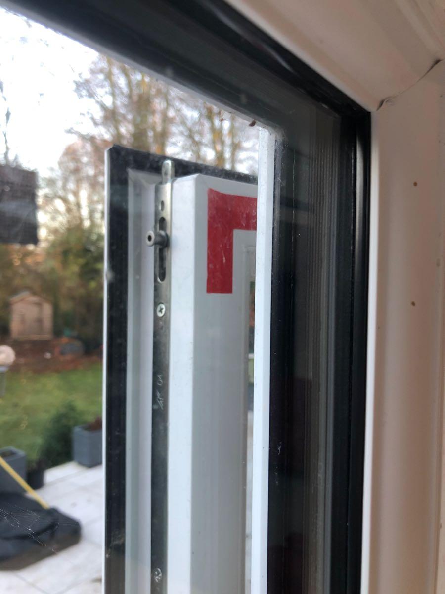

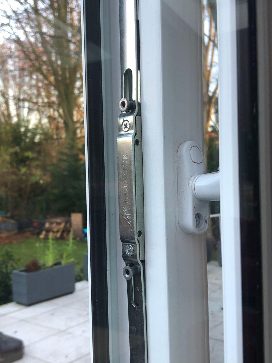

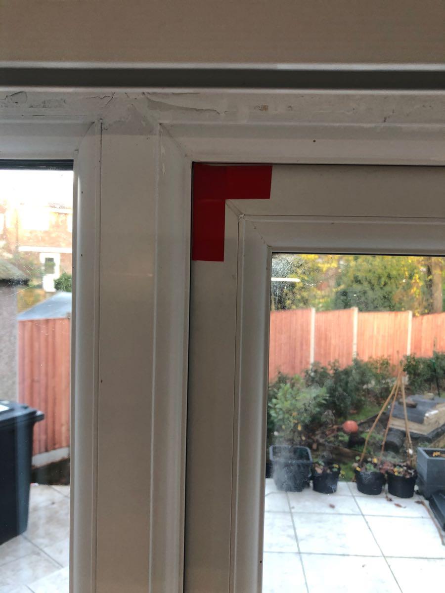

Double opener? Is just a standard side hinge casement. There is a cam at the bottom but that is free as the window clearly moves a bit when you push it. It does open out onto the big lean to extension roof so I do have some access but not doing it now in a frost... and the fascia/eaves bit is very low to the window.

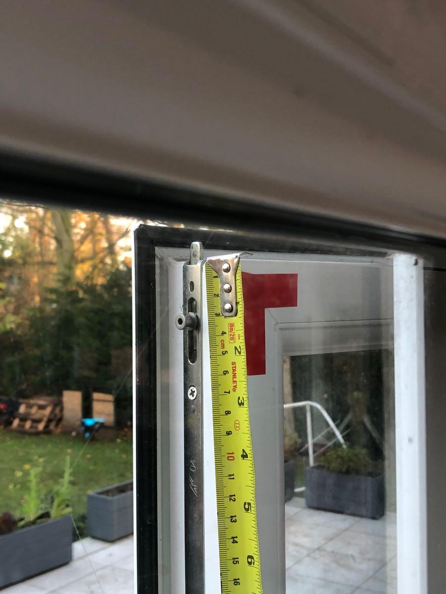

I’ve fiddled without luck so far. I should try to take the seal out and persevere, it’s the bends and dimensions that’s the problem. A loop of wire pushed down over the cam from outside and pulled from inside looks the best bet ?
Did I say first floor? ? Is this locksmith territory? Not sure it’s a window fitter job.

I have a casement window that is stuck closed. It’s a first floor escape window ? Handle turns and the base is free but the top is still locked. I youtube’d how to free it and saw how you could slip something between the frame and casement to pull the latch down. Didn’t work and when I inspected a similar window (I’m guessing they are the same) could see the little latch was far higher and further back than in the YouTube examples and I will not be able to release it myself with “an Allen key”. Nor do the geometry of the “UPVC latch tools” available look promising. The roller cam is approx 25mm back from the face. Is there a better tool option? I need something thin, stiff, right- angled and a minimum of 30mm long in both directions to fit in the available space and also have enough meat to pull on whilst not slipping off.
