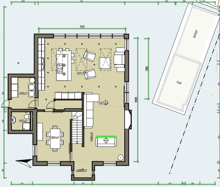

Location of steels and insulation
Tetrarch replied to Tetrarch's topic in House Extensions & Conservatories
Thank you for all the replies. The rear is a new build single storey extension 3.5m x 8m with a 6.5m Vistaline slide-and-stack Door that hangs from above and weighs 35kg per sq.m (so 475kg is total) - we'd ideally likely stack this to the right so that is a lot of weight on that outer corner I'm waiting on a few extra drawings and I'll share when they arrive that will show the rear elevation and the new planned roof Regards Tet -
I'm not sure if this belongs here or in the insulation section. My architect has prepared my BC drawings: I would like: The rear horizontal beam (outlined in red) to be closer to the rear facade The right rear corner to be smaller in cross-section The internal cross beam supports (circled in green) to not intrude into the room. I can live with the right if required, the left is a real problem with the kitchen units. Notes: The grey wall on the left is solid brick and on the right a cavity wall (from a 1970's extension) My architect has replied to all of these with "possible condensation through the steel because insufficient steel cover". Do I have any choices here that I might suggest to my architect? Regards Tet

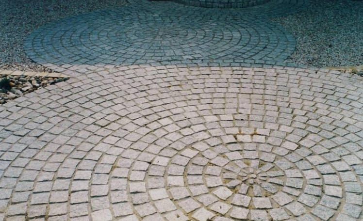

rounded stones to delineate garden space on driveway
Tetrarch replied to johnhenstock83's topic in Driveways
You could use 100mm granite setts that are very easy to lay in an arc down to small radii Regards Tet -
