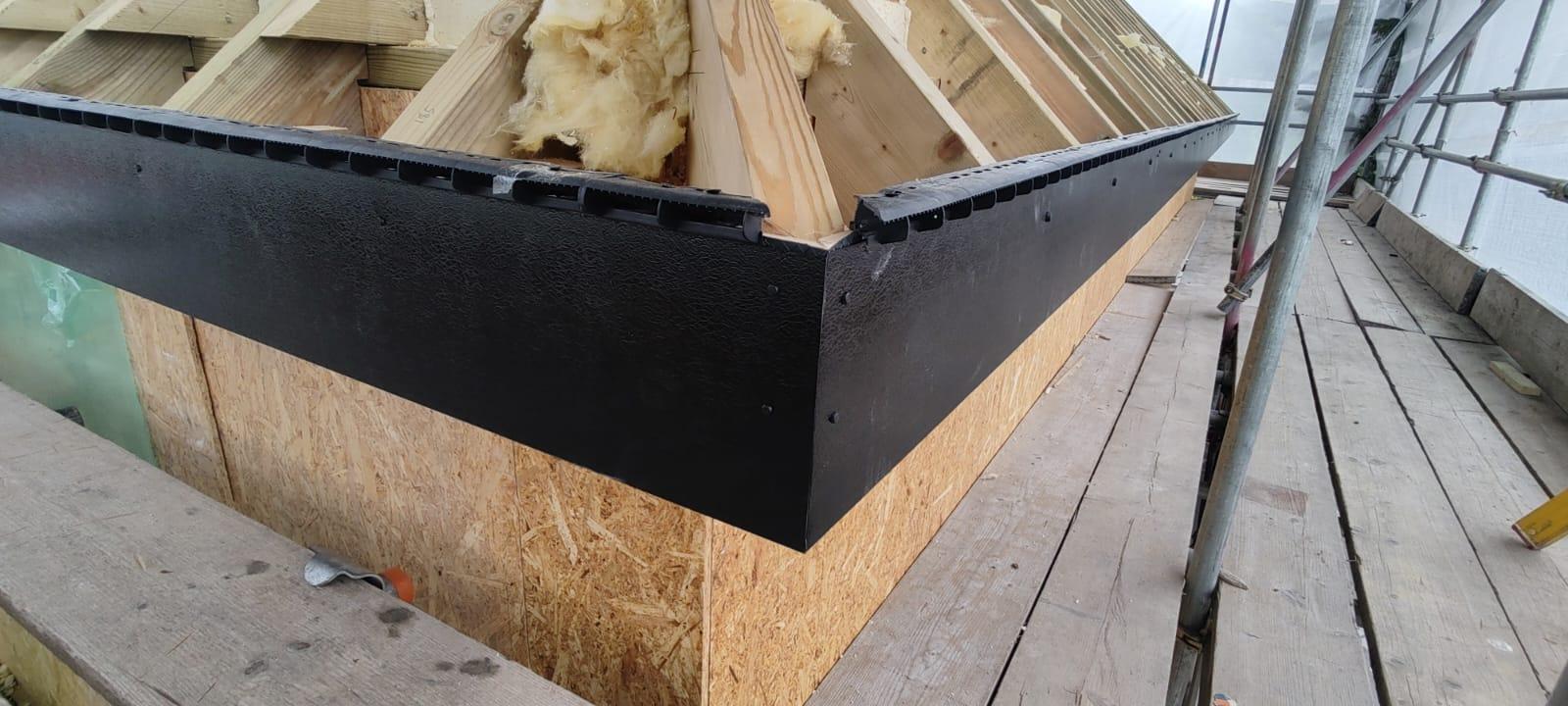

  12. I'm just having my house re-roofed as part of its refurb and I've gone for slates - I have literally just ordered my (black) stainless steel clips - they are not cheap - I just paid £385 for 3,000 To answer your nails question, my roofer offered me the choice of stainless clips or copper nails. Copper heads (apparently) deform more and form a tighter, flatter seal that any other nail, thus the tile above is not pushed up by any protrusion from the nails themselves WRT to facia, mine is a new roof and I don't want ANY maintenance. With this in mind my research led me to powder-coated aluminium, specifically the Alumasc Skyine range. This seemed to price up at around £85 for a 3m profiled fascia and a similar amount for a soffit. For a 36m roof this would have worked out around £2,000. I showed my roofer the Skyline range and particularly the corner detail that I admired. My roofer then told me that he knew someone who formed aluminium roofing sheets and then he disappeared into deepest Kent The next day he turned up with a Foffit - a single piece aluminium extrusion that has fixed beautifully to my new plywood wooden framework Regards Tet
