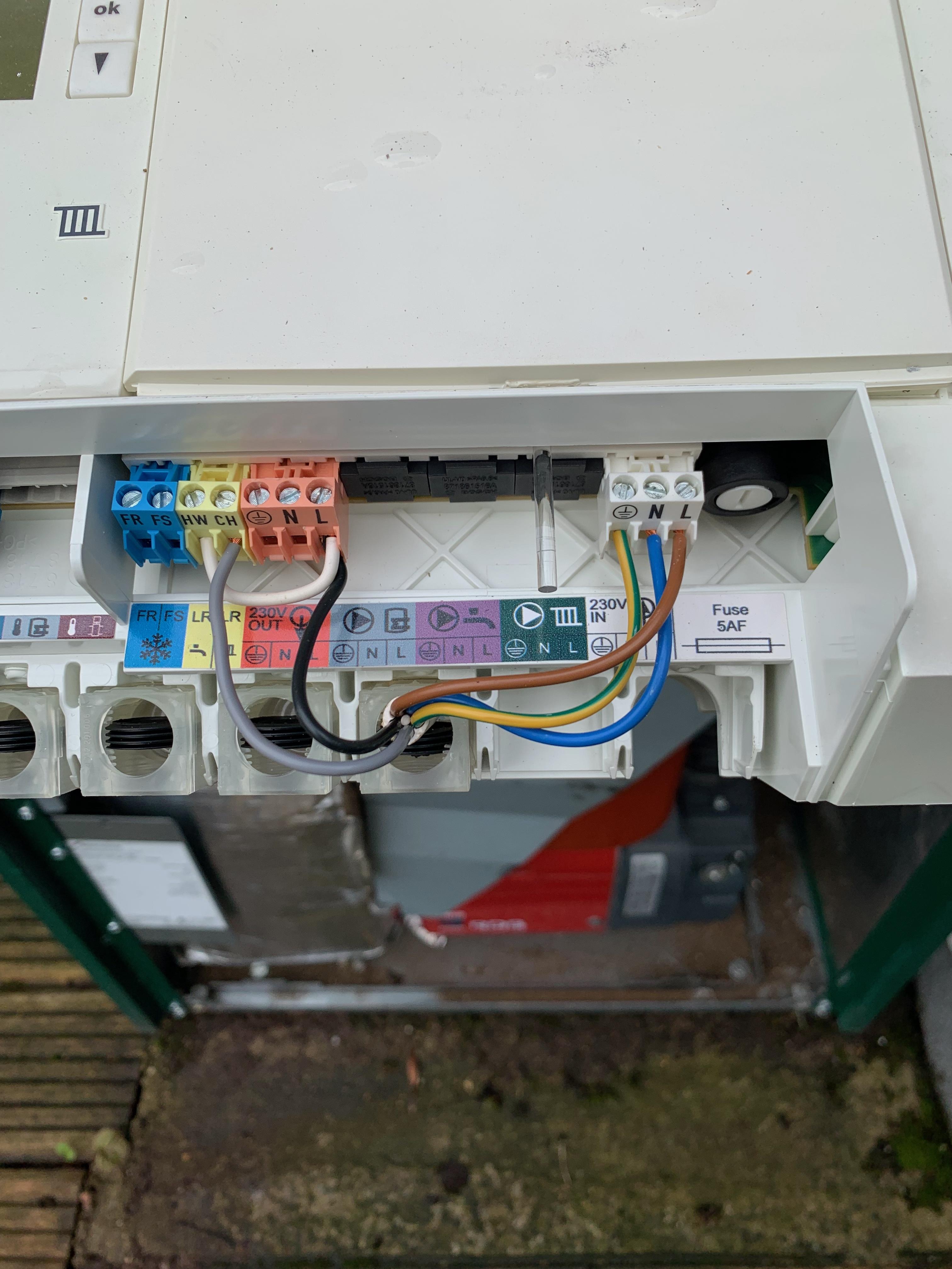

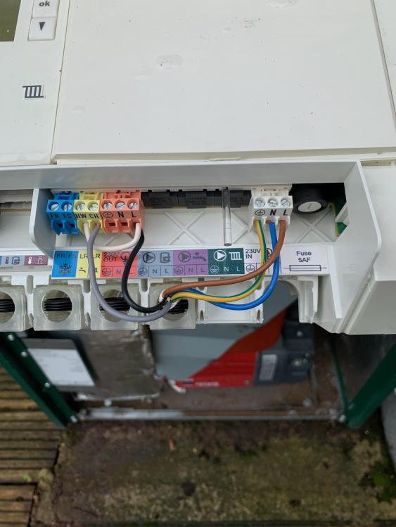

@RHayes Today I took the cover off the control panel on the boiler to investigate to where the 5 core cable connected to, Am I correct in thinking I need a 5 core heat resistant flex, as I'll be connecting live, earth and neutral (as per the image) to my S Plan, and then the black will be in the same connection at the boiler as the image but go to 1 on my S Plan. Then the grey will be in the same connection on the boiler and 10 on my S Plan. And both should be sleeved with brown at both ends. I will then still have to have a jumper in the same connectors as per the image.

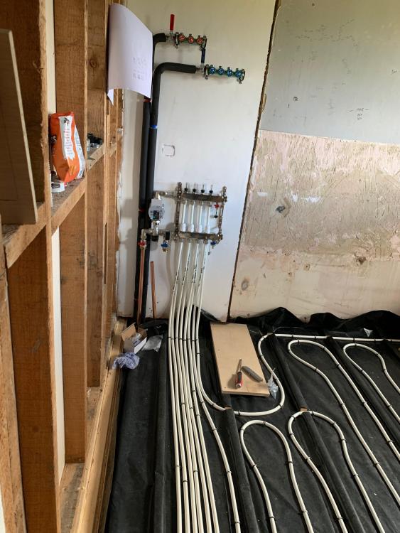

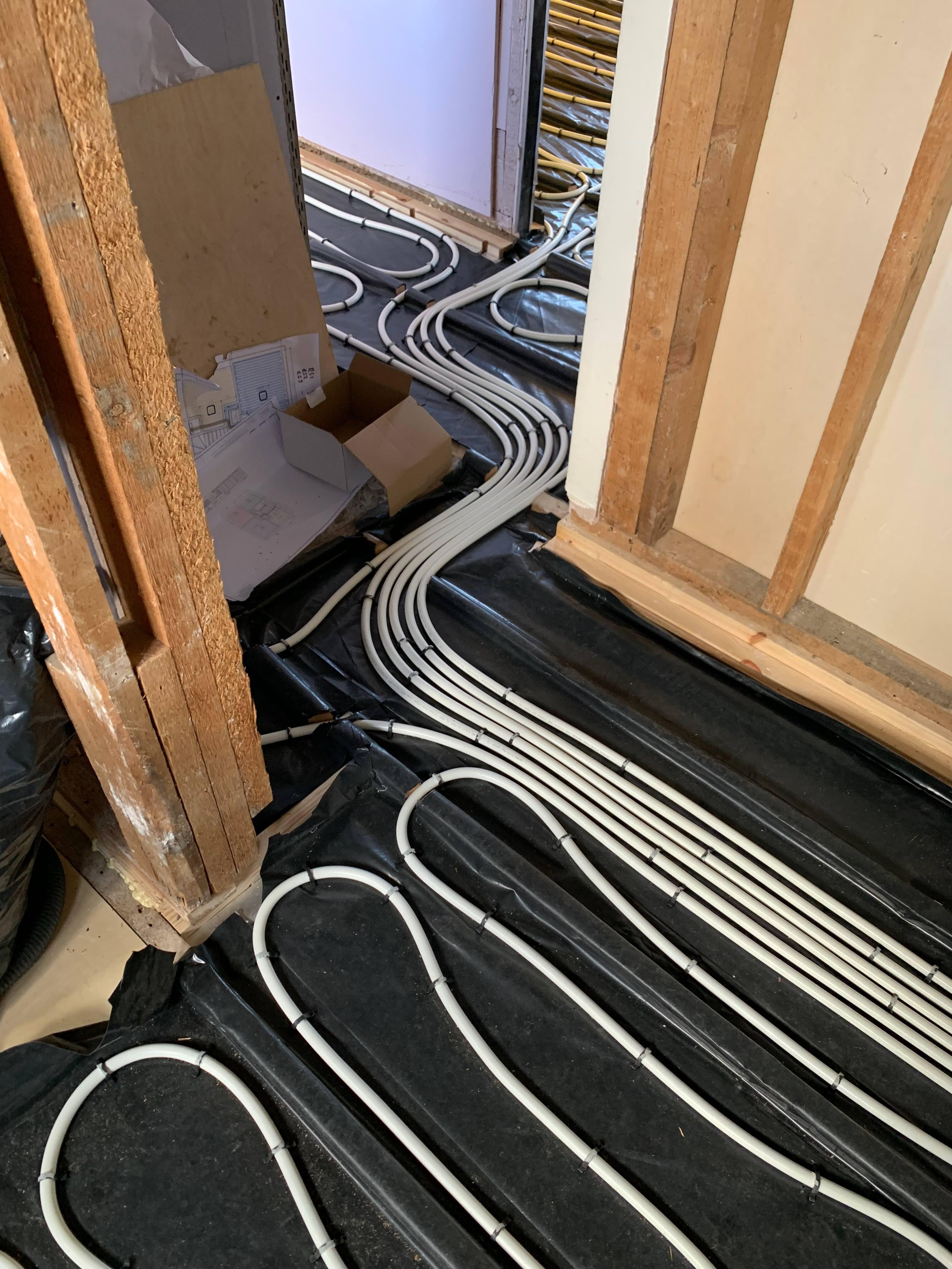

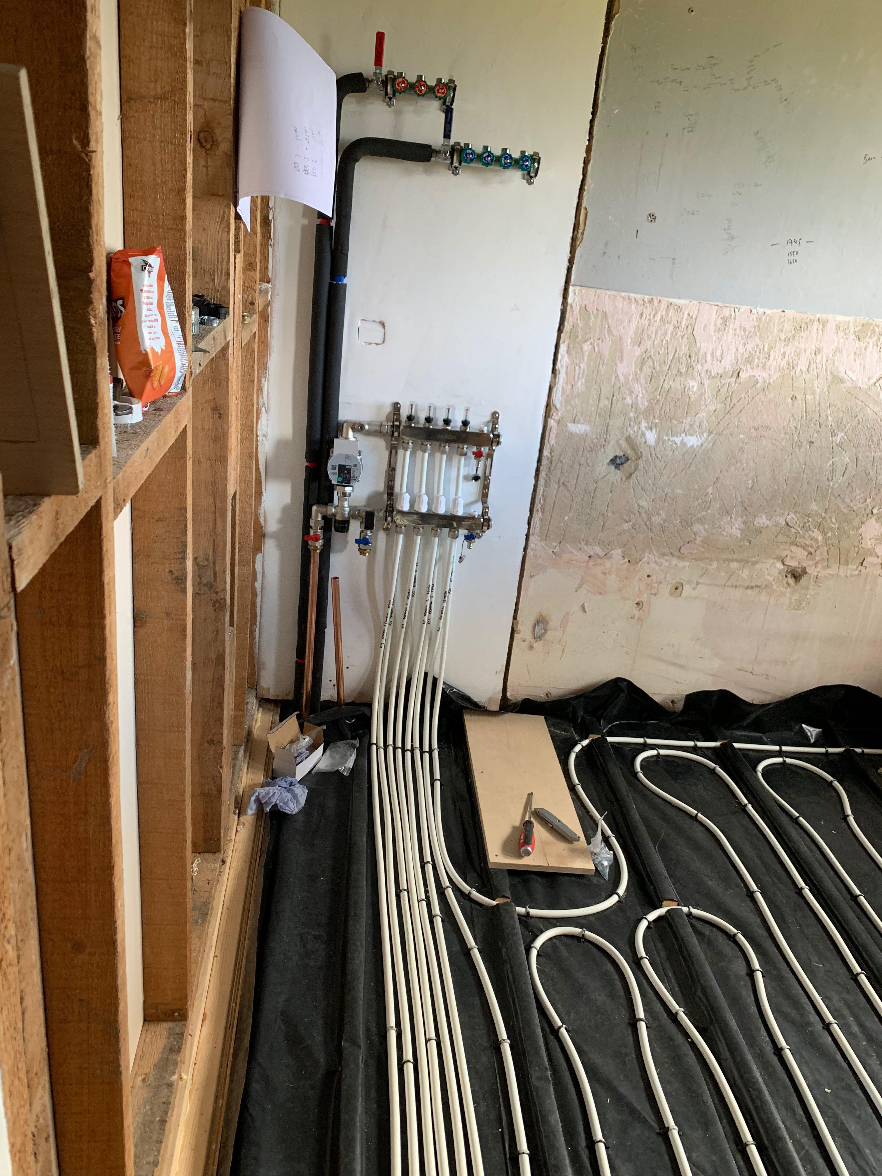

Tbh that was my thoughts at the beginning however I stuck to the Wunda plan, which doesn't show any pipe runs in that first void for 2 reasons. Firstly to avoid a notch as the pipes naturally fall from the manifold into that second run, and secondly I was concerned (having never installed wet UFH before) about the bend radius being sharper to get out of the bathroom and round the corner. Was I thinking too safe? I've got some 25mm insulation for another part of the renovation from which I can cut a rip to pop into that first run instead of the pug mix.
Hi Nick, Its only a 4 port manifold and there's 3 pairs of flow and return that are together for around 3m. Space is tight otherwise I would've split them up a bit, and I couldn't use a run between the adjacent joist as I was concerned about the bend radius. I've attached a couple of pictures which might help explain what I mean.
So today I finished laying my UFH pipework according to the Wunda design. Went near enough exactly as per their design except in a few circumstances where it was not possible to install the pipework. However paranoia is setting in with regards to the flow and returns that are bunched together leaving the manifold to go to their relevant zones. Is there a specific spacing that should be adhered to? First time installing UFH (well first time installing wet UFH), and I did have on my mind the bend radius (not wanting to kink the pipe) and wanted to keep notches to a minimum and utilise as many existing if possible (of which there were a few). I have had a search and read through some existing threads, however these seem to be more aimed at screeded applications where the spacings isn't also affected by components such as joists.
