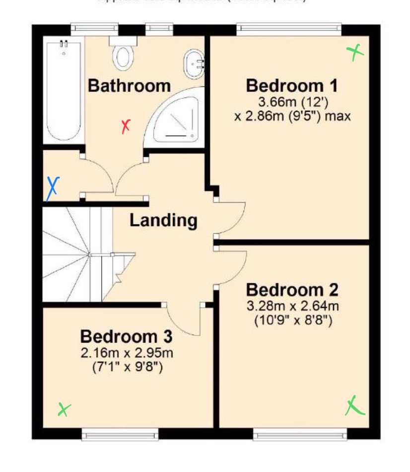

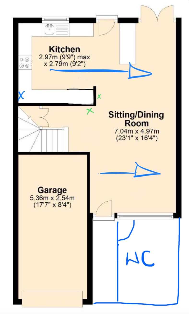

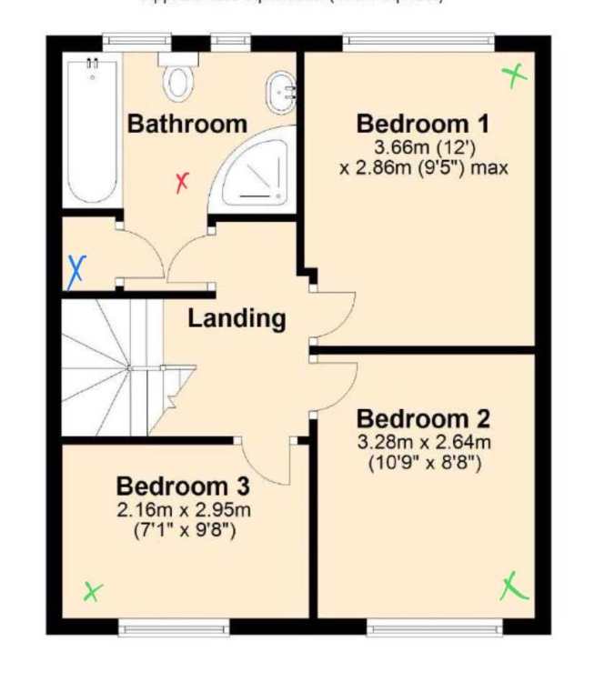

  4. Thanks for all the replies. I've fired off the floorpans to a few companies and will see what they come back with. If the supply vents could come out of the wall I could run a duct beneath the ceiling (above the wall units), from the blue x on the ground floor and in the direction of the joists. Attached an image to make it clearer. Green x would be the supply vents. As for an extract vent by the sink (reply by @Marko), I possibly could get a vent beneath ceiling and above the wall units/extractor, then come up into the ceiling and over to the sink, but would depend on the height needed within the ceiling void for the extract vent. Don't think I'll be able to get a extract vent to the WC on the GF so maybe just go for a standalone unit in there.

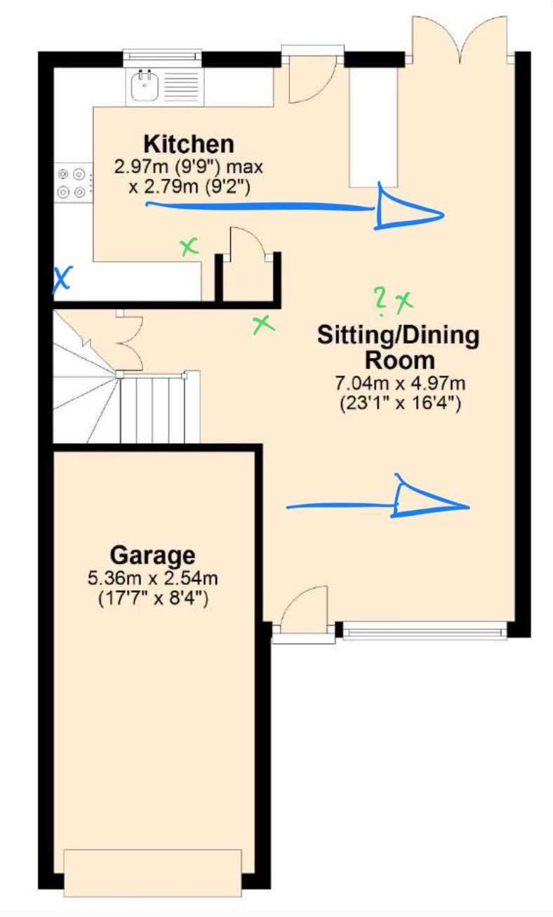

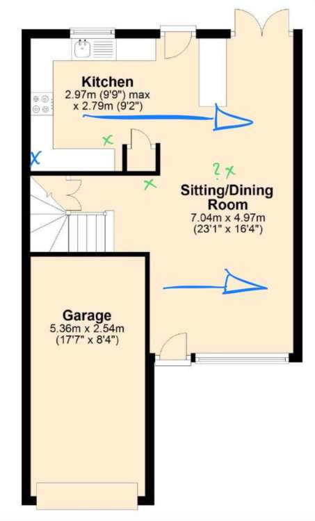

  7. Apologies I should have been clearer. in ground floor, floor plan; blue ‘x’ is a small opening from ground floor through to the loft. It’s open at present as it’s where my flow and return for first floor UFH go up, along with h/w. blue arrows are direction of joists. green ‘x’ is location where a grille could definitely go. green ‘x?’ is a possibility. on first floor plan; blue ‘x’ is the location of the gap from loft to ground floor. red ‘x’ is where the bathroom grille would have to go. This is due to bathroom ceiling is solid surface and grooves for extractor already routered in. green ‘x’ is where definite grilles could go, with no restrictions on duct size as that would be in loft.
  8. Can anyone help with a design for MVHR in my home? I've attached a floor plan of both floors with 'x' where ducting could be fed to. Size of ducting for the first floor, can be what's suited as not restriction to size in the loft space, however on the ground floor I'm restricted to a max height of 75-100mm due to UFH already being installed between the first floor joists. Location of the main unit could go in the loft against an external wall for venting in/out through there instead of the roof. Thanks

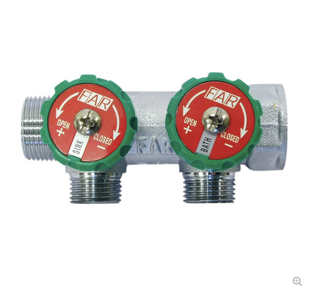

  13. With regards to the connection onto the CU I've got blank spaces so no issues with having a dedicated circuit. In fact the current oil combi is on its own circuit so I assume sparkie will just replace that. @JohnMo My initial plan is from the cold feed into the house to tee off to the a manifold (for the fridge/hot water tap and heating circuit via the filling loop) and to the water softener. Then out of the softener it goes to another manifold which will go to the cylinder and to the bathroom. Already got these manifolds in the bathroom as a means to have isolation as all the pipework is behind tiles. Done it all in plastic to not have any joins. Sound ok?
  14. I couldn't believe it, but at the same time thought fair play. If you can get the work at that rate why not. Yes. The consumer unit is under the stairs (where the cylinder/UFH manifold/ASHP controls will be) so the new circuit will be run from there. I have had a heat loss survey completed by said installer. More so got this done to see if my own one (using heat engineer app) matched up and confirmed with the installer for a 5kW Arotherm Plus. Can anyone confirm whether these water distribution manifolds would be ok to use?
