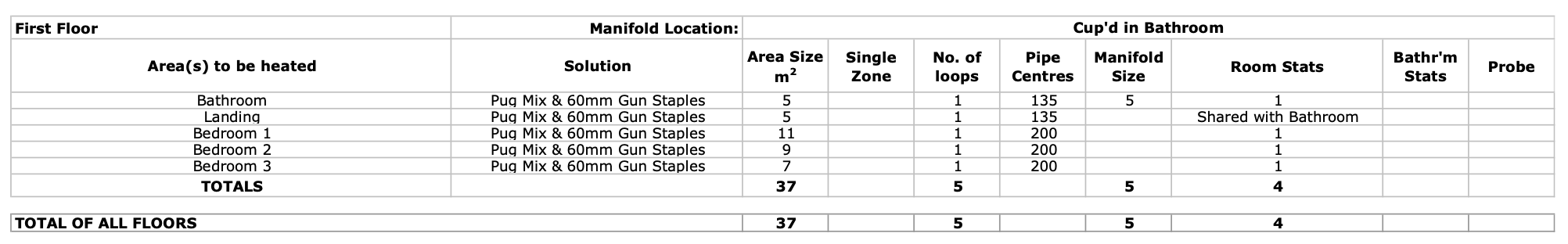

Everything posted by vala

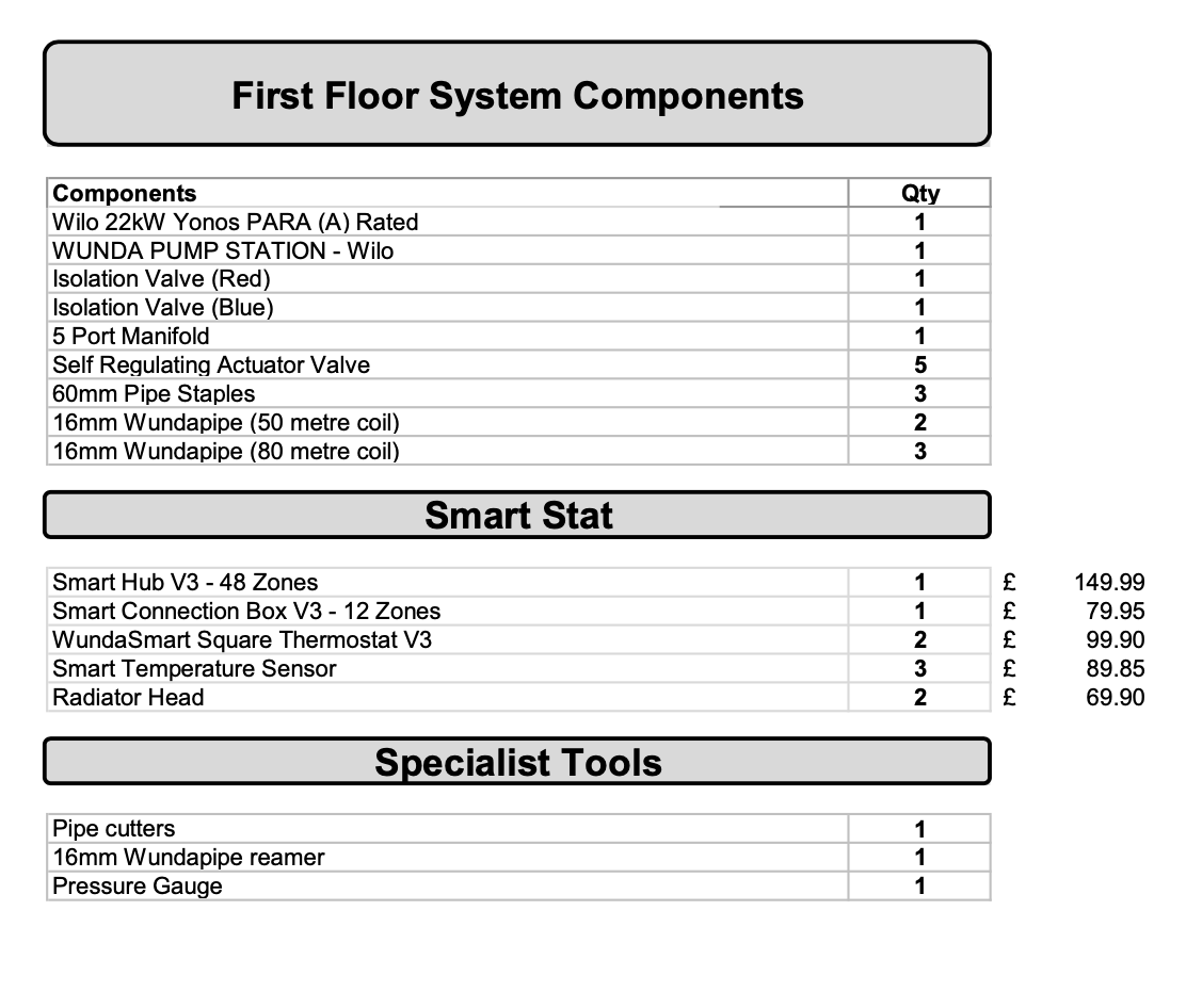

  3. The reason why its now a pug mix system is due to the irregularities in the spacings for the joists. This eliminated the chance to use their boards with grooves and also their spreader plate options as they noted it would be very time consuming adjusting the sizes all the time. It's a semi detached property and this is for the first floor. Once we get round to completing works on the ground floor another manifold will go in for that.
  4. Tbh I've had smart stats for the last 5 years and just seemed the option to choose. Didn't really think much into not having them. Also I was surprised at the cost as I expected it to be much much more. I had a set up quoted with Warmup and that came to over £3k, hence being surprised. Wunda have stated a minimum of 50mm insulation board but if we have space to go thicker then do so. So I'm aiming for 80mm boards which I'll sit on ply which in turn is held up by battens.
  5. Just checked the other document they've sent and pipe spacings are between 135mm and 200mm I'll send them a message and see what can be done to bring the pipe spacings down. Aside from the pipe spacings does everything else seem ok? I will do a check online and see if I can get any of the components at a cheaper price but tbh at present its £1385.81 and I was quite surprised at just this!
