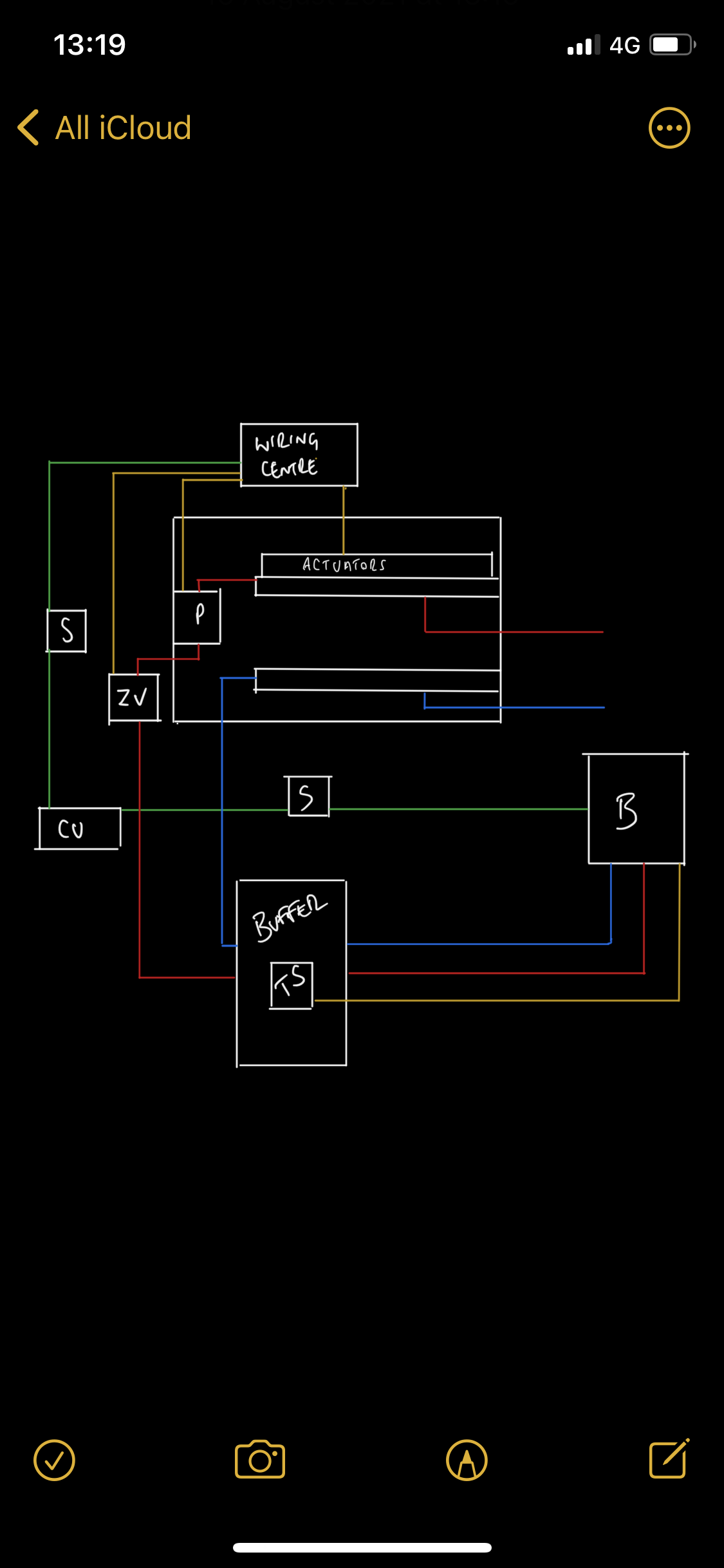

  1. Thank you both for all this extra information. having no zone valve at the manifold will definitely simplify things for me and will make 1 less cable to get through to where the downstairs UFH/buffer and s plan wiring centre will be. i'm going to draw up a schematic for my system with regards to the S plan and I'll post that up. Hopefully it'll be correct or require little amendments! I'm definitely understanding more and more with regards to this so thank you all!

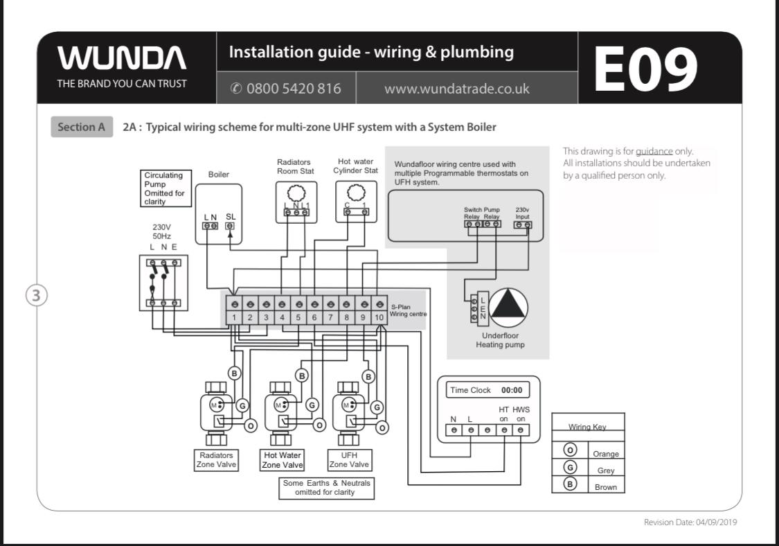

  2. I'm just going off the wiring diagram from them and trying to adapt it to suit my project. On that it includes zone valves. also next year when the ground floor UFH goes in, then the zone valves will be needed to ensure the flow only goes round which ever circuit is calling for heat? Its also never been mentioned in any of the previous posts to not have them hence why I continued with having them.

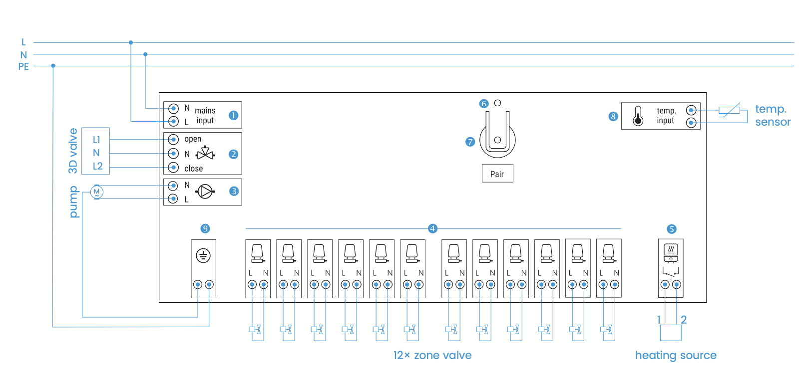

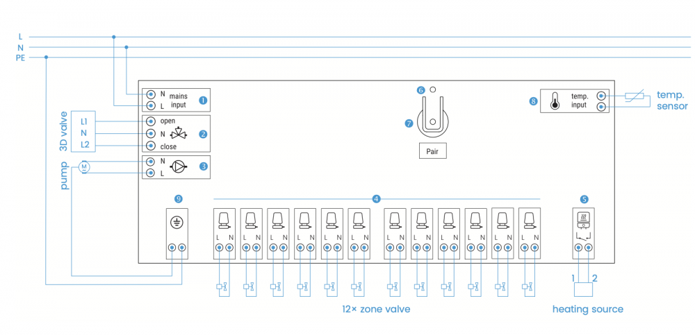

  3. According to the Wunda page the heating source is also for the boiler/zone valve. I'm assuming this is where the need for a S plan wiring centre comes into play. I could run a pair of cables from here to 1 and 10 on the S plan so its the same as the grey and orange as the zone valve? And then a pair of cables from the S plan (from 1 and 10) goes to the buffer stat? So this way I connect the zone valve, buffer stat and boiler together?
  4. @RHayes thank you for this. I'm trying to get it noted down in the order of 1-10 and noting what will go to where. Getting a bit lost as the Wunda wiring diagram I have for the smart connection box doesn't have a switch relay, so although I can put the live into 1, I only have a neutral and an earth left (for 2 and 3). This is the diagram for the Wunda wiring centre I'll be getting? I have a feeling maybe the folder of wiring diagrams for different systems they supply may well be for there non smart wiring centres?? With regards to the thermostats the smart ones that Wunda supply are all wireless. There's a 'HubSwitch' which connects to my router in my AV cupboard which will over wifi pair with the smart connection box. I do feel I'm getting closer to understanding all this, just am a bit concerned with the amount of cabling I'll have to feed down various conduits etc, as if there's to be just 1 S plan wiring centre I'll have to install this downstairs where the ground floor UFH manifold etc will be. So I'm hoping the zone valve cabling can be extended. Or that I could have a S plan wiring centre for each of the manifolds.

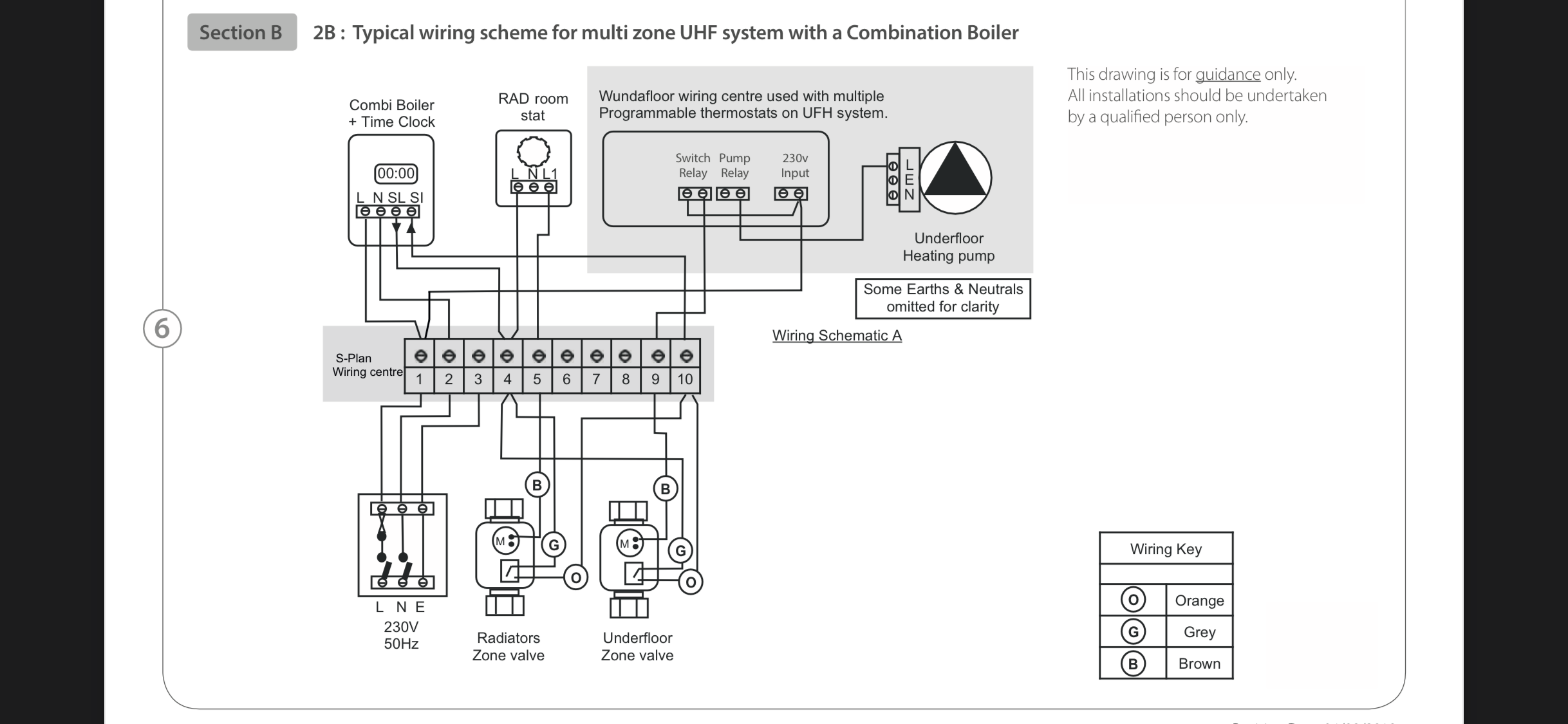

  5. I was under the impression when I come to install the ground floor UFH, this would have its on S plan wiring centre along with its own Wunda wiring centre etc??? not wanting to contradict your diagram as its extremely helpful however I came across this page from Wunda whilst looking more at the diagram I previously posted, it shows the common and 1 (call for heat?) going into numbers 6 and 10. is this what you've suggested just amended to suit the combi boiler wiring diagram I posted up, as I don't have any timers etc for HW?

  7. This is exactly what I was concerned about after speaking to my electrician yesterday. in the summer months the buffer will continue to heat, and cool down even though there's no demand from the UFH. So going off the wiring diagram off Wunda which most matches my set up Does this mean the 3 core from the boiler still goes into the s plan wiring centre and then the cylinder stat from the buffer vessel also goes into the boiler? and from Wunda's wiring diagram I can omit the rad stat. so when there's a call for heat from the UFH, the draw will be from the buffer vessel (via the zone valve opening and the circulating pump on the manifold also being live), and only if there's a call for heat AND the buffer vessel stat is low will the boiler kick in?
