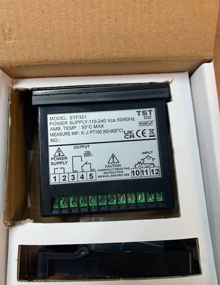

@RHayes @OldSpot So I've checked on the heat load in kW for the UFH at present (just upstairs) and its coming out at 7kW. Downstairs at present comes out at 8-9kW. Boiler is an oil combi boiler rated at 12-18kW. It was present when we moved into the house and I wasn't made aware of any changes to the boiler so assume its still factory set in the middle at 15kW. I actually received another email from Thermosense showing the connections on the back of these programmers. Looks like they'd also require power off the S Plan wiring centre. If I was to use these what would A1 and A2 on your diagram refer to? On the programmer I can make out, normally open, closed and normally closed. Connections 10, 11, 12 I can't make out what they are. They also noted the hysteresis on these is adjustable up to 50º from the set point. @OldSpot The latching relay you've done a drawing for...are they the type that look like RCBO's for a consumer unit? They're the only ones I can find when searching for them.

@OldSpot @RHayes So Thermosense have got back in touch and recommend 2 mineral insulated thermocouple sensors and 2 programmable thermostat's. They have sent me the instructions for the thermostats STP321-STP322 Instruction Manual.pdf Can anyone with better knowledge on this type of install advise on how this all wires up? At present the call for heat from the UFH manifold is to the thermostat on the buffer however I'm struggling to make sense how this pair of cables now becomes 4 and all works together to allow the boiler to only fire when under a certain temperature and not exceed another. Thanks

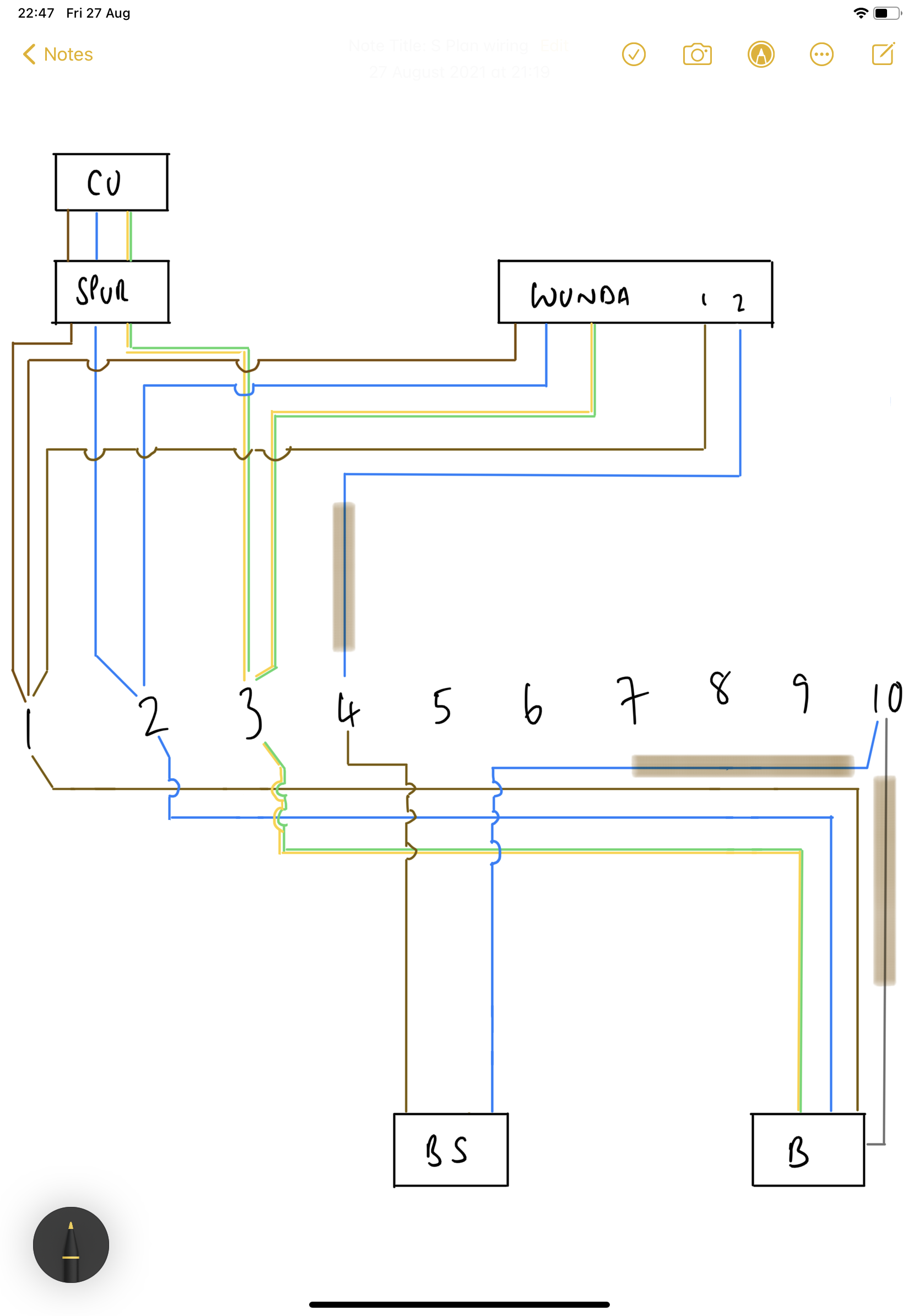

@RHayes Thank you so much for this! It now makes sense to me with regards to the switching sequence. Seeing it on the drawing has made it all make sense. I'll definitely omit the zone valves now I'm understand how these come into play in other set ups. And yes the pump on the boiler will circulate to the buffer, then the Wilo pumps on the manifold can draw from the buffer and circulate around the zones calling for heat. You are 100% correct with the blue from the buffer stat being a switched live. Reason I did it in blue was to mimic the colours in the cable I'll be using to make it easier for me to start making sense and seeing practically how it will all go together.. And yes indeed, if its live I'll definitely be using brown sleeving, as I have had to do for all the 2 way lighting I've installed. I have attached the amended wiring diagram to show the correction and omitted the zone valve. Also shaded brown over other lives for the sleeving. I believe this now to be correct? Today whilst stripping out the bathroom, I came across the 5 core cable from the boiler which went into the Tado extension hub. So there's another cable connected which hasn't been allowed for on the drawing. I'll pull the control unit out from the boiler over the weekend, and see where this goes to. Hopefully can make sense of it and fit it into the S Plan wiring I've drawn up.
Also is it possible to not have a zone valve at all in this system? Even bearing in mind when there will be 2 manifolds?

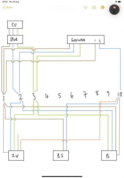

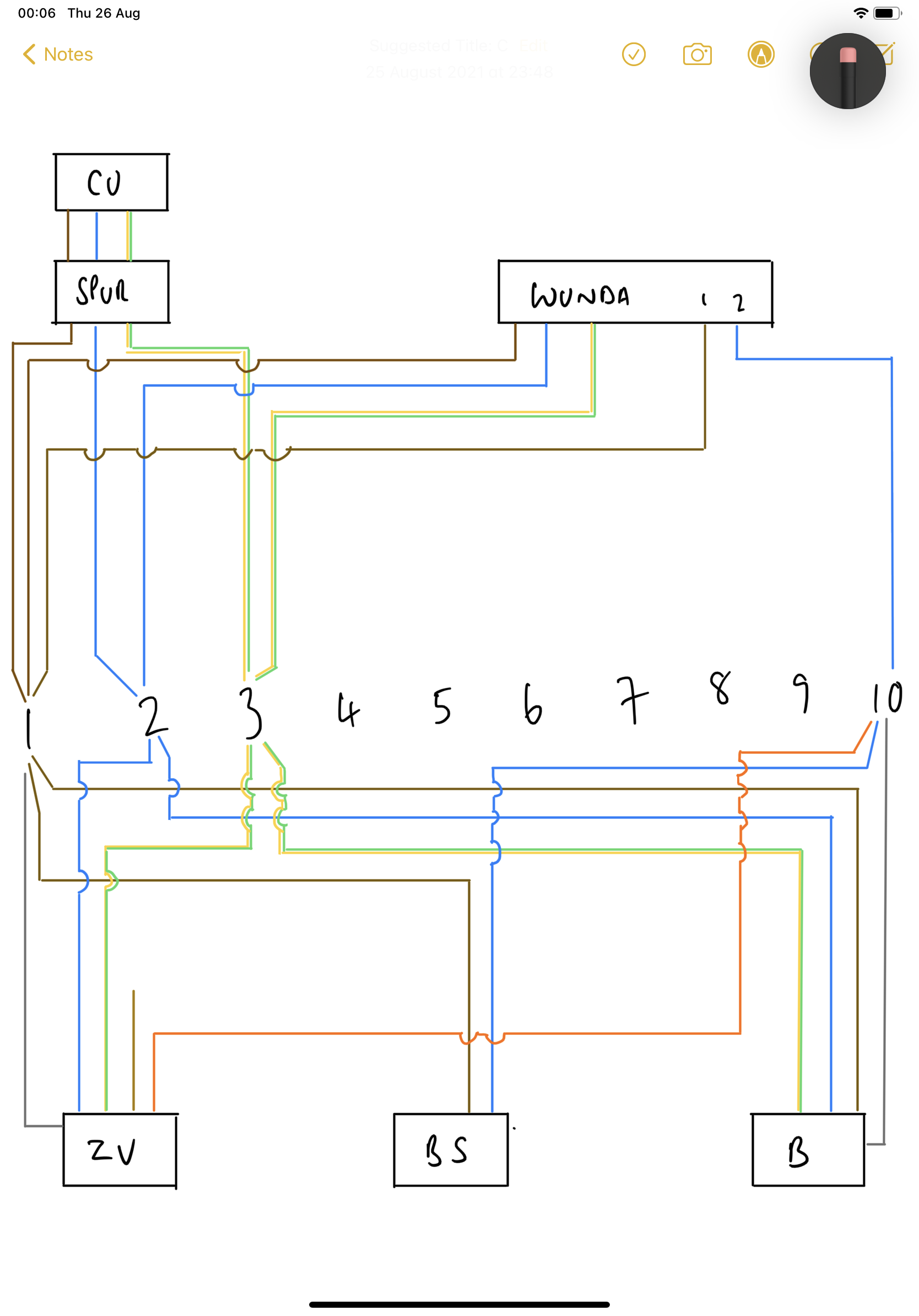

So I've drawn up this schematic for my S Plan wiring centre and I hope most of it is correct. I'm lost as to where the brown cable from the zone valve (which is to go between the buffer and the boiler) goes so hoping someones can advise. I did think 4, but can't work out what else should be there. I'm did think it should be a switch live but I have this in 10. So definitely lost there. I've looked through the MI for the boiler and all I can make out is a T&E for power, but unsure what else is going from it to the wiring centre. I've put in a SL in my diagram as I can make that out, but unsure if there should be another. I'm starting the rip out for the bathroom and floorboards on the first floor this Friday so I'll be sure to see what other cables there are going to it. Also I've got hold of the buffer stat instructions from Newark Cylinders and according to that its a 2 core cable (COM and 1, which I believe to be 'call for heat'). So here it is, if anyone can help then that would be much appreciated. Hi all,
Thank you both for all this extra information. having no zone valve at the manifold will definitely simplify things for me and will make 1 less cable to get through to where the downstairs UFH/buffer and s plan wiring centre will be. i'm going to draw up a schematic for my system with regards to the S plan and I'll post that up. Hopefully it'll be correct or require little amendments! I'm definitely understanding more and more with regards to this so thank you all!
I'm just going off the wiring diagram from them and trying to adapt it to suit my project. On that it includes zone valves. also next year when the ground floor UFH goes in, then the zone valves will be needed to ensure the flow only goes round which ever circuit is calling for heat? Its also never been mentioned in any of the previous posts to not have them hence why I continued with having them.
