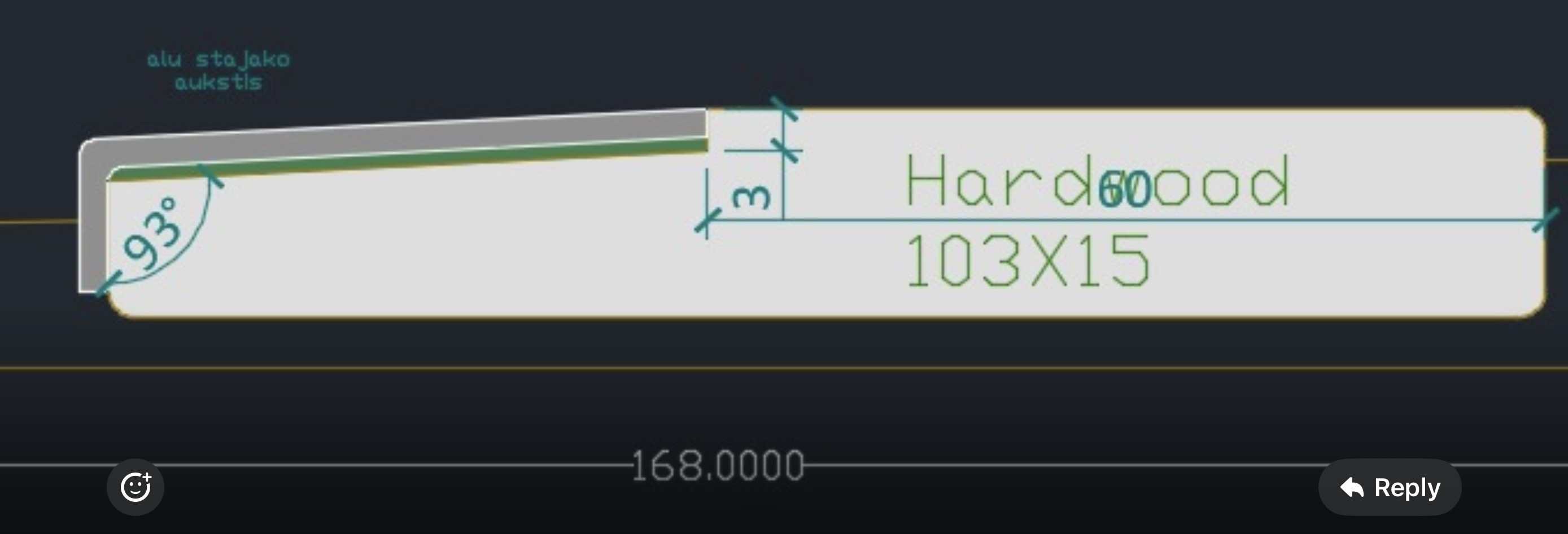

They are fine, 3mm is substantial enough but I personally prefer them having something solid underneath and non slip. All they will do is put that down and then sit the door on top. Make sure they seal along the length before sitting door on top to stop water penetrating further back. -

It’s effectively a tray as the threshold doesn’t tend to go all the way out, thresholds are generally the depth of the door frame. something mire substantial would be a 20/30 height timber and wrapped in aluminium. Something like this but you either sit the door on top ir recess the timber to make it as flush as possible. The aluminium can wrap underneath and back if required. Usually you have to have this made. You can ask them to make it for you. -

Are you meaning like a tray that sits under the door to prevent water going further back under the threshold of the door, or standard threshold/extended threshold that projects further out? Is it an entrance/side door, lift and slide, French door (inward/outward)? -
