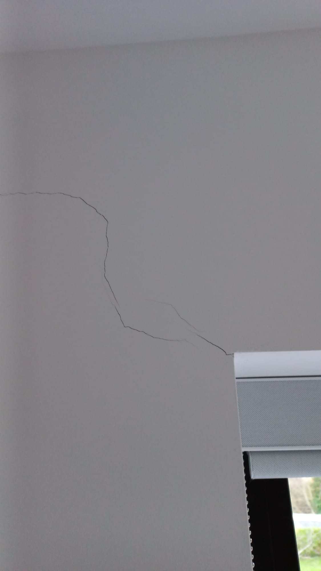

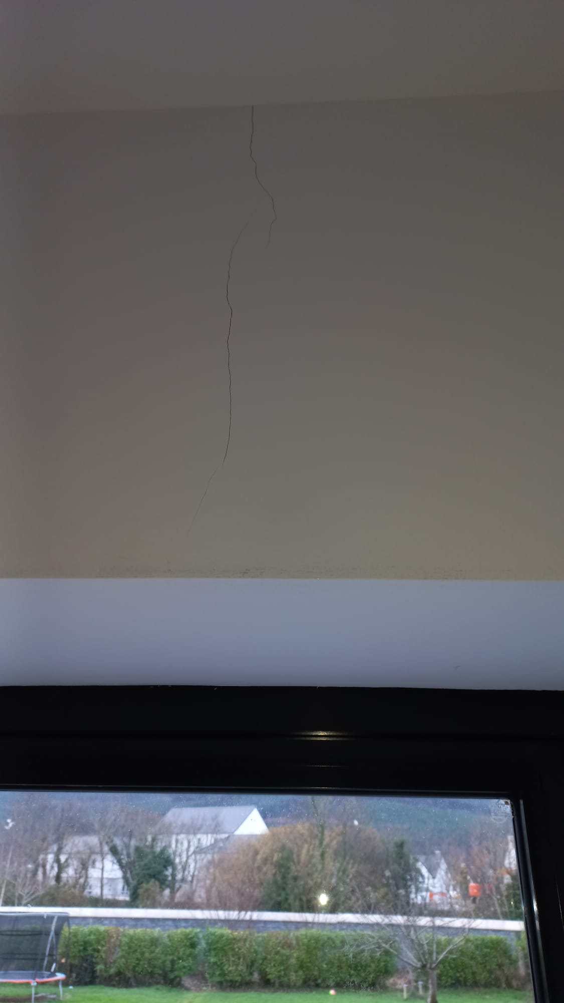

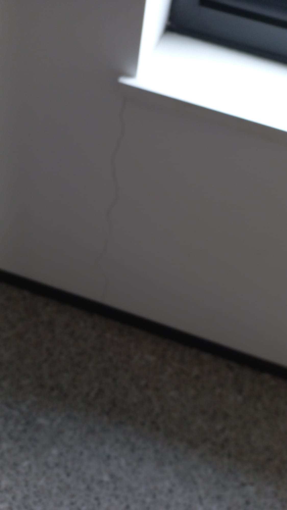

Hi all, a bit of a steer, please I had a block cavity house built by a contractor who did everything up to, plastering (ie excluding kitchen, painting and other latter jobs) and I'm in since June. Generally all is good, thankfully, but I do have a lot of minor cracks that mainly appear around windows and doors, strecting out to floor or ceiling. I have it on good advice that there are minor, basically drying out and settlement cracks - so I am not worried - and to drop back after 12/18 months to fill and paint them. My question - is that up to me to do, the builder or the painter (thats me anyhow)? Thanks, James

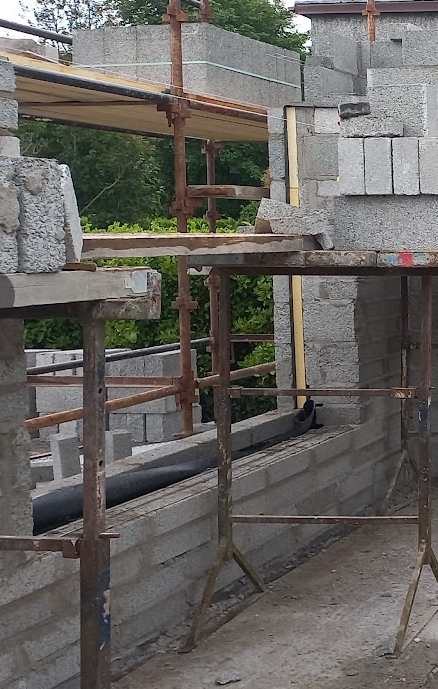

@ADLIan Just passed this to my architect, as I was concerned that my insulated upstands were not insulated at the top. She didnt understand the reasoning (this edge of the insulation is facing up/cold) - do you have any references or further comment you can give. TIA

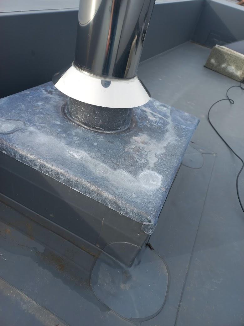

Mmh, the flue guy installed this using lead flashing and loosely packed insulation wool, but there is condensation falling from bottom of lead. Anyone got a good understanding of how the detail should be (warm roof, insulated box) - I'm guessing solid insulation with vapour control, maybe? Also, that collar is siliconed - is that OK? Im a tiny bit nervous that the lead does not stretch down far enough. Ooh, I have to stop looking!!- 25 replies
@Andehh see pics above, and this one which was taken for unrelated issue (unprotected timbers) but shows head stepped dpc
Ive spent a bit of time studying these today 1 - I noticed that there are weep hole covers missing, could that be the source? 2 - I see cills run under frame from outside to inside, could water be getting blown back through? 3 - Mastic is good, but not perfect everywhere (could this be the cause, or is this really essential to weather proofing)
I'll look for pics, but it looked right. Step dpc in head, and strip of dpc from inner leaf down outer leg of frames Edit: see 1 pic up. Unfortunately I don't have much better pic
There is a 50mm runoff on patio, does that deal with issue soakaway would deal with? No render stop. The patch you see is a problem with paint, as it rained before it dried
Oh dear, Im worried - please put my mind at ease I have a 'regular' block and s&c render house, with a flat roof in the final stages of build. I finally had the windows sealed (rubber between frame and glass and the mastic between the s&c and frame) a few days ago. Todays rain has shown a problem on 14 of the 18 door/window openings - a wet patch at the bottom of the inner reveal (always on one side, just) - see pic. (There is S&C behind the cladding). I have noticed this previously, but the builder felt it was because the rubber on the windows was missing - obvs, Ill speak with him in the morning. What is most likely to be going on?
