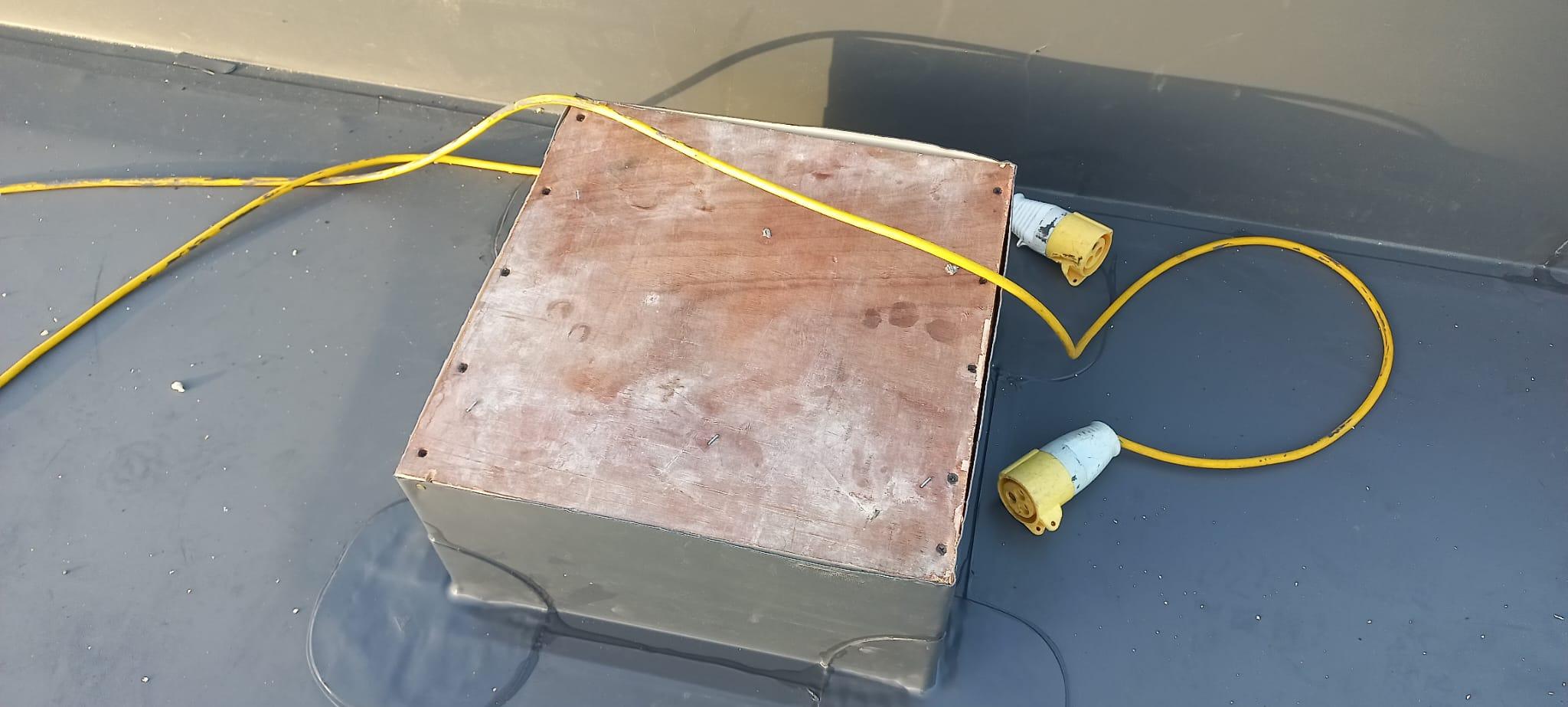

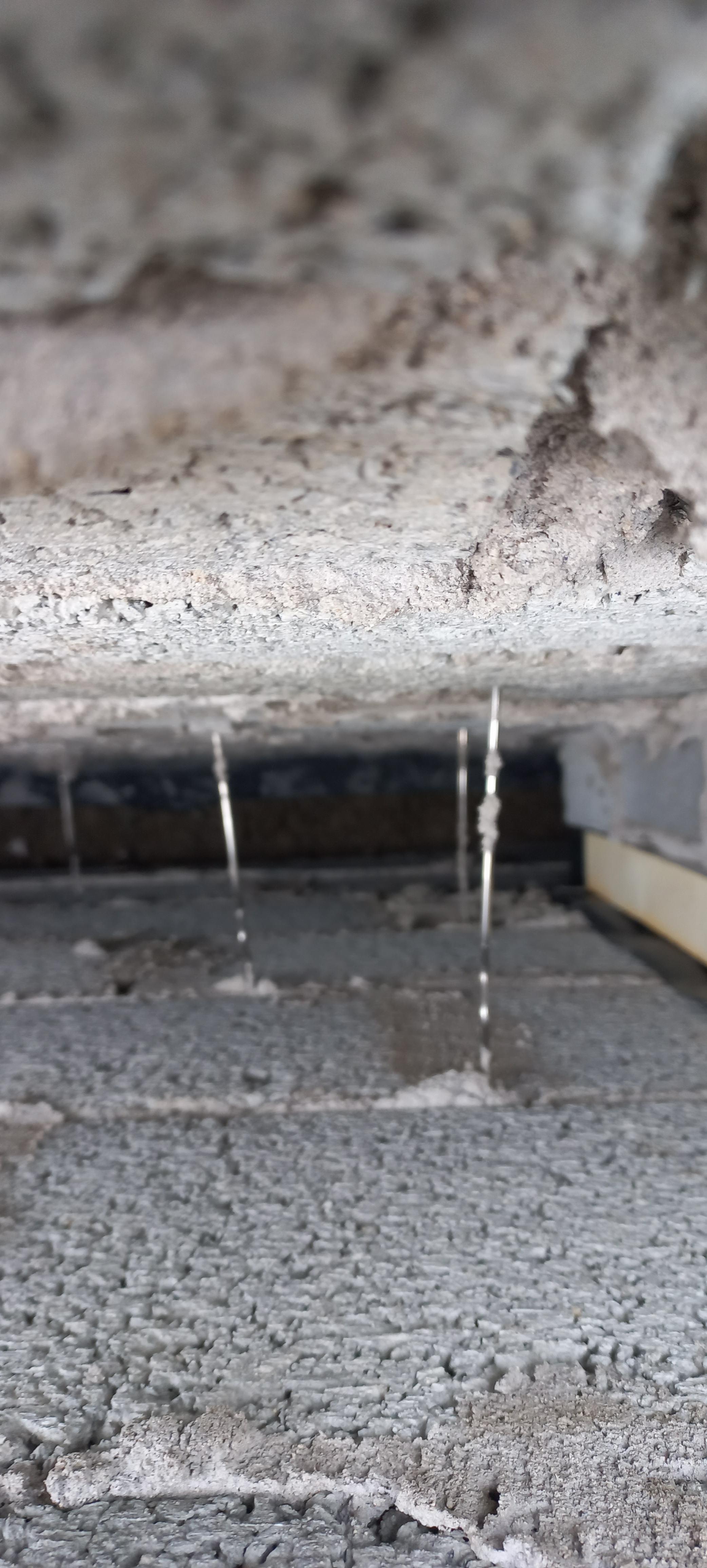

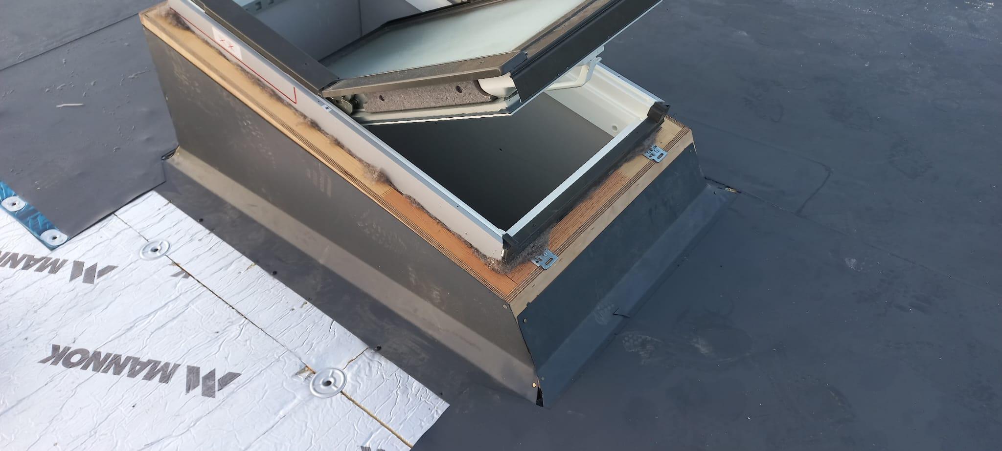

Hi All Im having a bit of a time with the Trocal install guys, most of which we have resolved, but there is one or two things outstanding. I dont have time to explain our dealings yesterday, as Im pressed for time before they come in today - but I will in due course, under the heading of things to watch out for!! - the roof is ply deck with VCL, 140mm insulation and Sikaplan S 1.5 membrane - I have a 400x400 box, which risies 150mm (i think) above insulation for the stove flue, which will be flashed. Are the upstands supposed to be insulated? - Similar question regarding the rooflight, which has some insulation as part of the kit, mainly inside or within the structure of the kit - insulate the upstands on the outside? - Are the cracks between the insulation supposed to be foamed - Im especialy thinking of where the boards meet from opposite sides of the apex? I cannot find the official Sika/Trocal details for this membrane (Sikaplan S 1.5) - anyone got a link? Thanks - Im expecting them in shortly/today... TIA, Jimbo

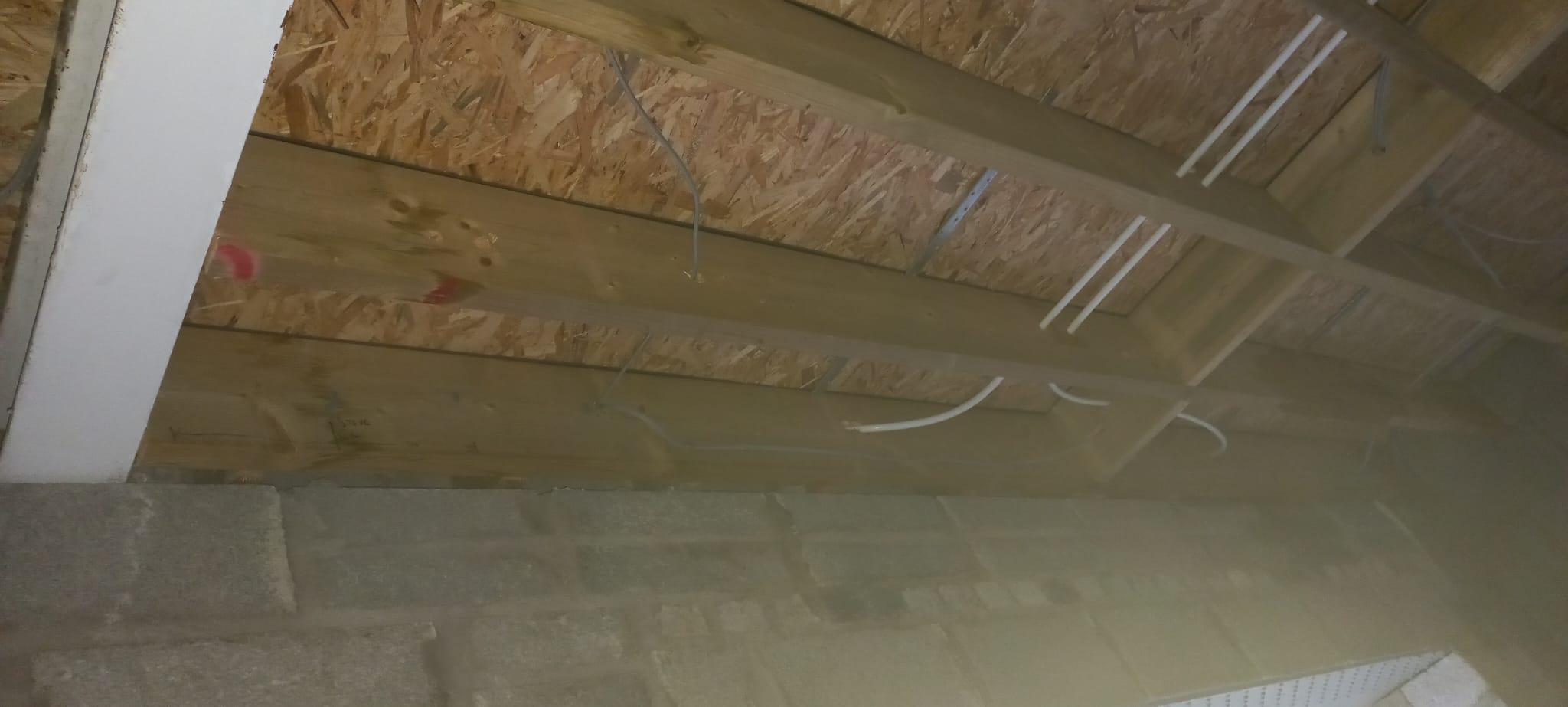

Yes, had a chat, for the benefit of others that may find it useful, in my own words - span is 4.5m - 600mm to be removed from one end - 1.6m to be spliced in, to give a min of 1m overlap - 4 x 12mm bolts staggered off centres, and double faces toothed plates/washers between Also, as it happens, an easier solution may be available, based on @Mr Punter comment - 12mm fibre board, mounted to on 25mm fibreboard spacer to give 25mm ventillation behind - to reduce the required clrearance by 50%, ie from 60mm to 30mm (but subject to the stove guy agreeing that I got this right) - so 125mm flue, with 175mm outer diameter plus 2x30mm - giving a total required space of 235mm - which should all fit between the 285mm joist space (and a bit to spare) Thanks all for your comments, tips and advice- 25 replies

Hi all. I seem to have snookered myself, but maybe (hopefully) there is a way around it... I have a stove planned for my living room, with a flue going straight up through the ceiling into the bedroom wardrobe space above, and on through the roof. Installer had planned on using Dinak DW or T600 flue, but... - 125mm flue outer diameter is 175mm - Receommended clearance between flue and combustibles (joists), 60mm - Space between joists (in first floor), 285mm So that suggests that my joists are 10mm too close for this to be compliant? - Can I solve this problem with a heat shield on one side (I think a heat shield needs 25mm circulation, but what are they and how thick are they?) - Any other flue system/brand that may squeeze in here? Related - is that 60mm clearance a manufacturer recommendation or a regulation? (The roof joists are wider spaced, so this problem just exists at first floor level) Thanks, James

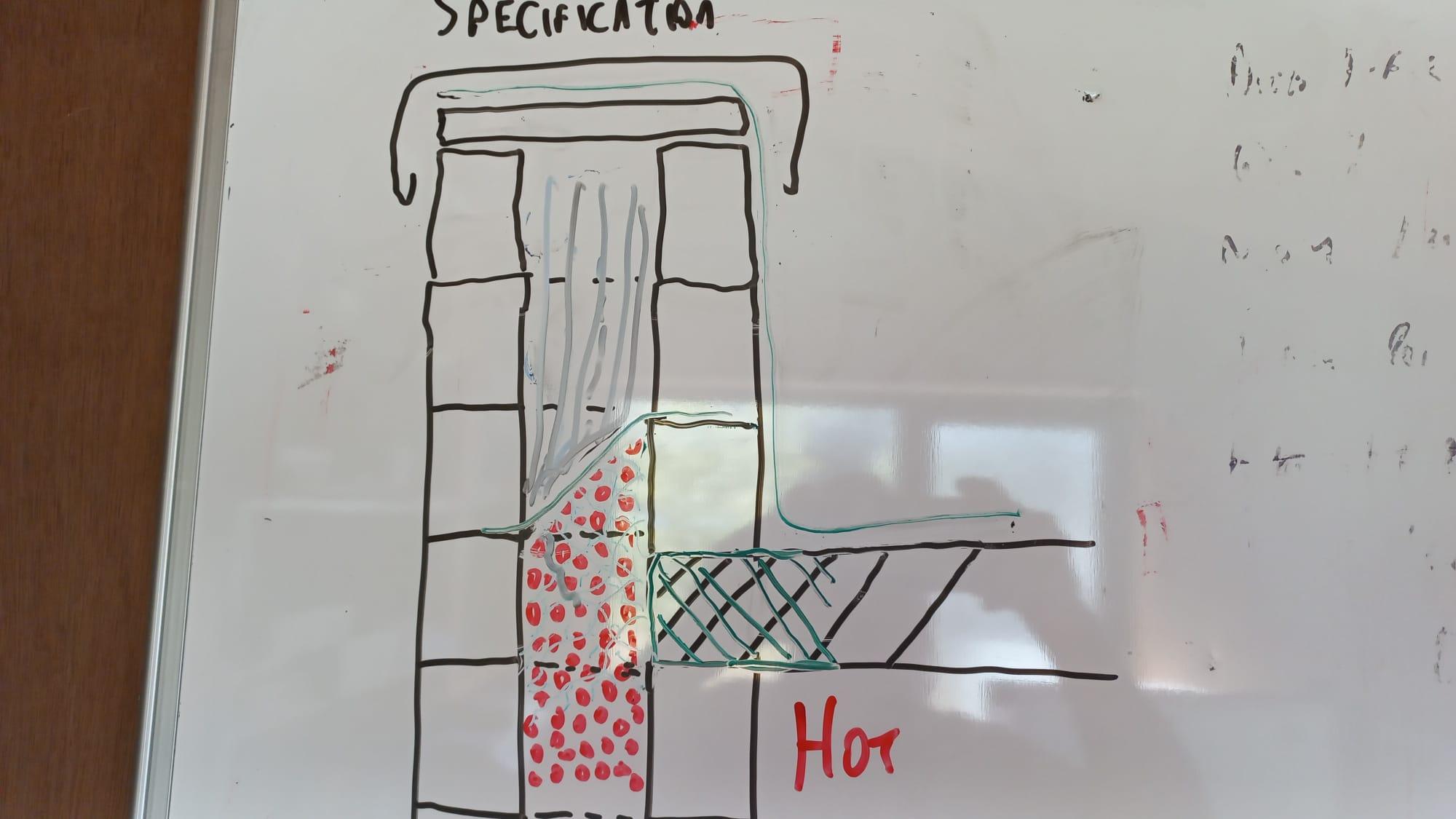

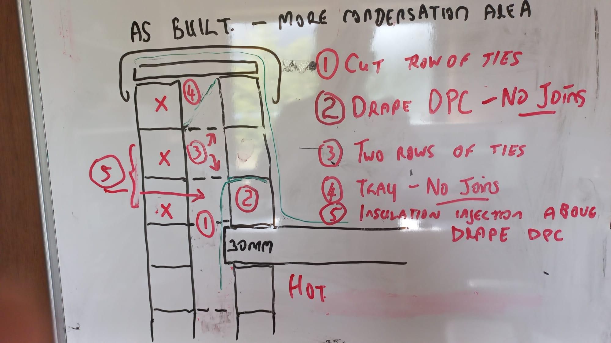

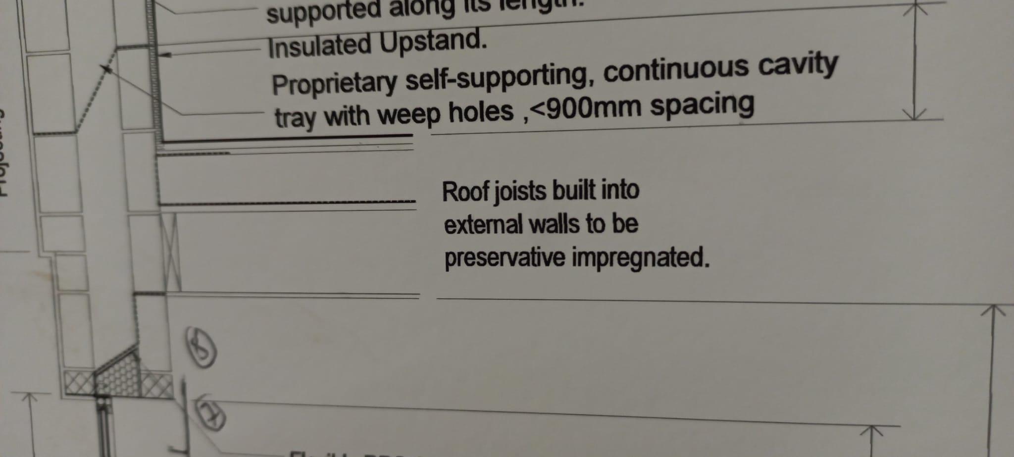

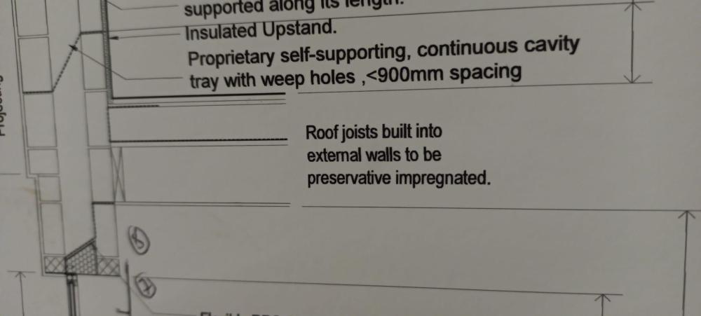

I just nipped up for a closer look & there are another couple of issues that veer slightly from spec, which are of no consequence, except they add to the condensation exposure of the end of the joist. (1) all joists project into the cavity by between 10 and 30 mm, and (2) the cavity tray is two courses (440mm) higher than it should, increasing the condensation area above the joist. Two sketches attached - the specification, and the as (nearly built) and my proposed mitigation - essentially to drape a DPC over the end of the joists (the blocks with the Xs are not yet built)- thoughts?

Can I approximate your thinking - it is probably OK? @Bonner and @saveasteading

Yes, that is my understanding. I suppose that the dpc just above helps with keeping weather wet away. On the other hand, I think it is a condensate point so the route/trickle out is a thing that will be used

Yes, the cavity is filled with bead. That reference is out of shot

Hi Self Builders A bit of a problem, that I'd like your thoughts on, please. Im building a flat/parpaet roof house with , which calls for preservative impregnation where the roof timbers enters the external walls (of cavity block walls). The builder placed the timbers today, and built blocks between the timbers and one row on top, but without the preservative, nor did he wrap them in DPC - there are 2 more rows of blocks to go to take it to the top of the parapet. Is this a serious omission, do I get a rework? Is there some other mitigations, other than a rebuild that I could ask for, that would suffice? Clearly, if it must be done, I'll ask for the preservative and rebuild - but I want to be reasonable, if there is another sufficient answer.

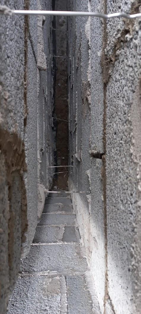

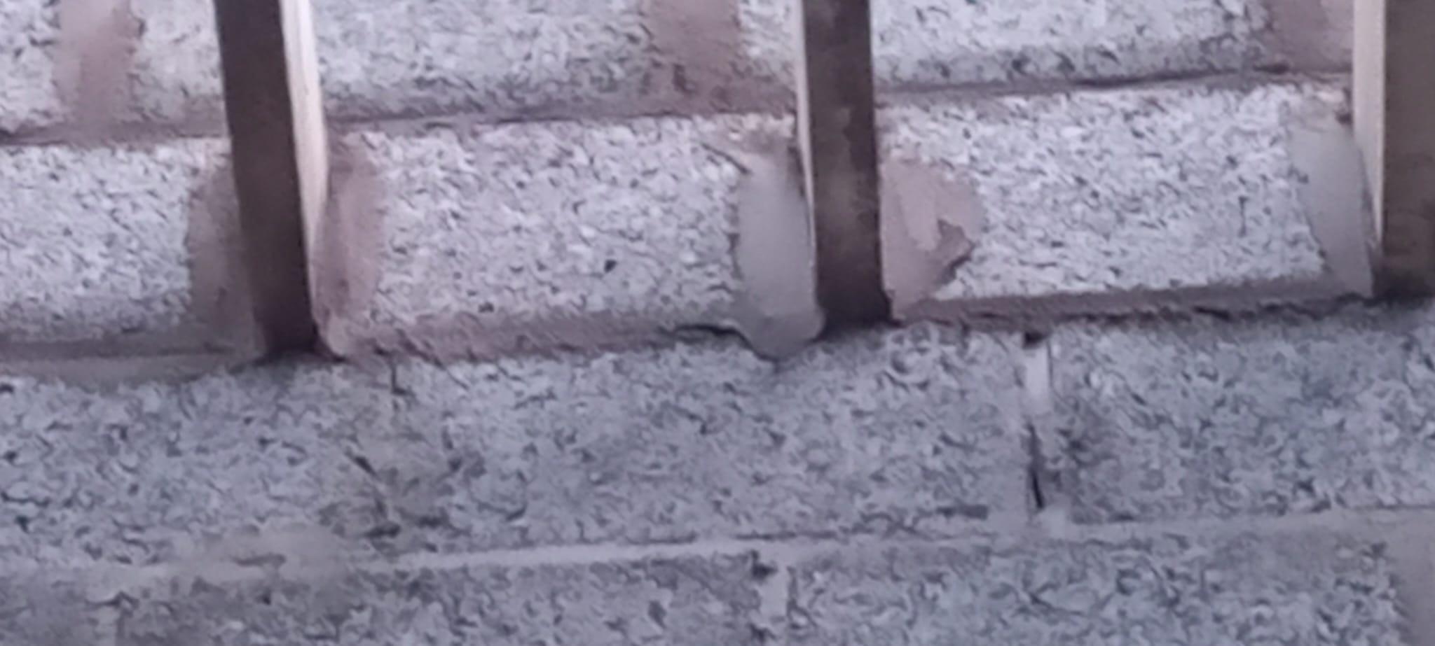

Hi all, a steer, please? I have had a chat with my builder, as I felt the cavity & ties were not clean enough. - He agreed that the ties should be cleaner, and was agreeable. - He felt that because there is a 150mm (min, but 175mm mostly) drop in the DPC from inner leaf to outer leaf, that it is OK to have a small amount. I told him that I had sent pictures to the (sick, but doing some work) architect for her view, and he said that she will say they should be clean, but that is simply not practical. Obviously, I pay her to keep standard up, but am mindful that the builder may have a point, on practicability - thoughts? To make my question more direct - is 25mm of droppings in a 150/175mm DPC OK, or do I need to insist on a clean? Likewise, I could just rock in, and demand my "rights", but I feel there is good value in keeping an amenable builder happy!
