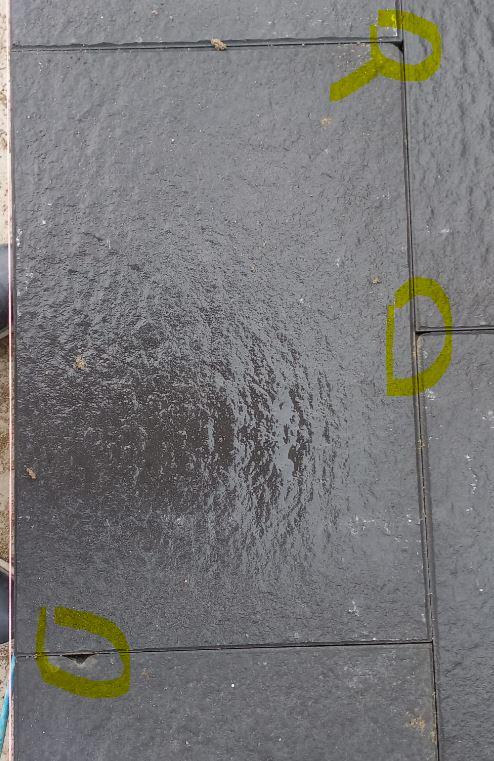

Apparently, this damage is a result of a known problem on the production line conveyor belt, where each tile gets a knock - and it is now fixed!! They swear that it's of no consequence if face isn't damaged, and are happy to replace face damages - i dont honestly know, but wonder if usage and frost will cause further chipping. About 30% have been laid, but remainder not needed until 2 weeks. I'm finding it hard to decide if I should go with their offer, or tell them to replace all the unlaid batch? I'd like to roll on, but can't be a "saft gab" either!

Yes, I agree as I see the damage in the bales. I think the builder is lacking by laying them too - should be set aside.
Most of the damage in the bales is on the back side of the flag - maybe could be slightly more accepting here. Am I right to expect builder to only use perfectly faced tiles, every single time, or should I be saying same of all damaged backs?

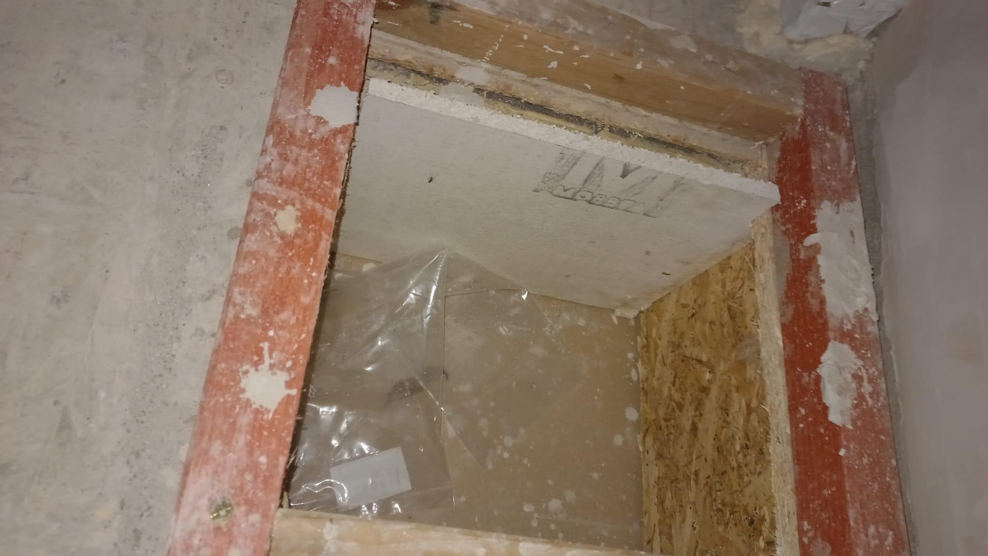

Picture of as-built, which has had approval from the stove installer - see detail ablve, summarised as follows - heat shield with 25mm ventillation behind on one joist to reduce required clearance to combustion from 60mm to 30mm - collar above, made from wood at allowed regular 60mm clearance (heat shield comes into this space, but stops 25mm short of top, to allow ventillation as normal Thanks everyone for your assistance - jobz a gud un!- 25 replies

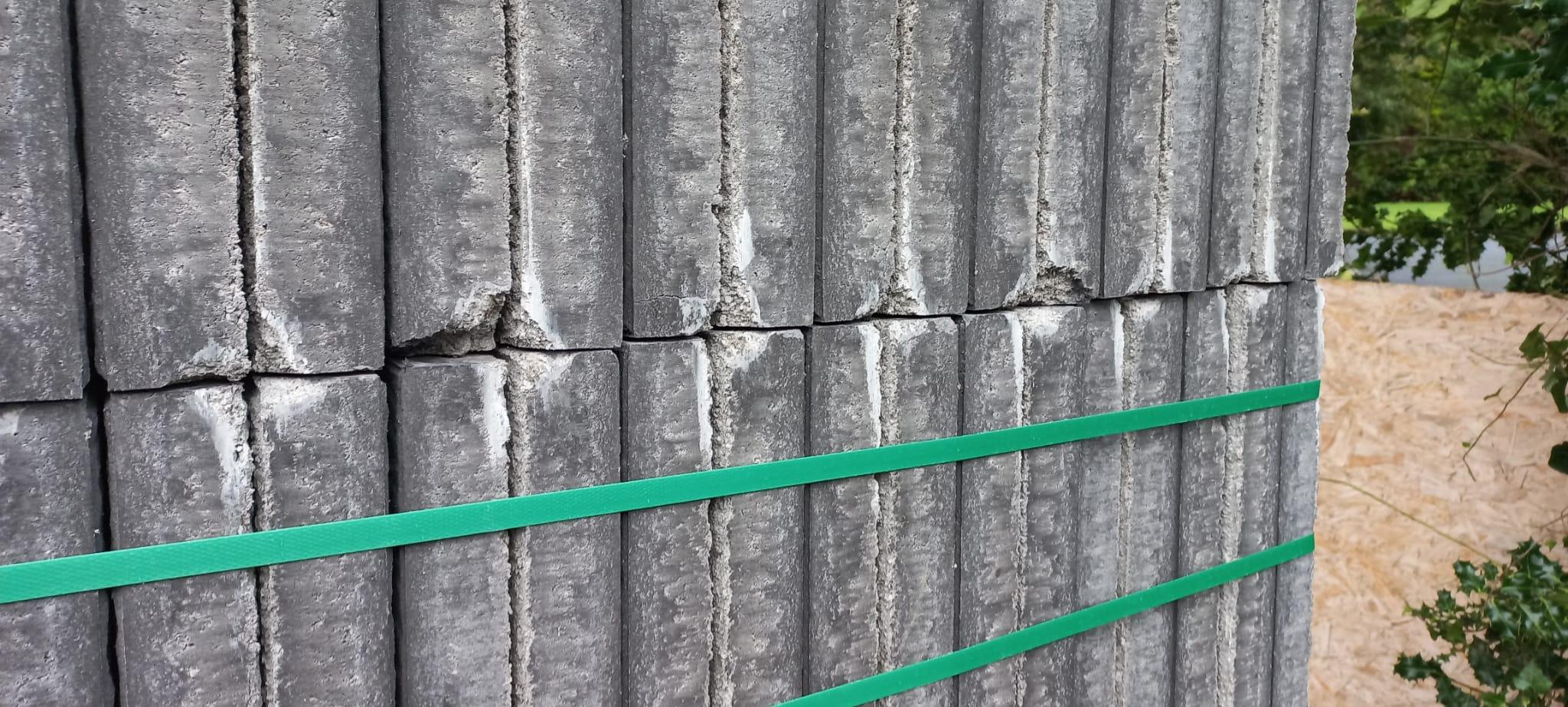

Hi all, my gut is that this is simply not acceptable, but I need your thoughts before I speak to the builder, please. So many of the delivered flags are chipped - is this an acceptable consequence of transportation? Thanks, James

This is what I'm doing, but with a 300x300 frame above, made from 50x50 batten on top - so as to comply with ventillation. Will need approval of stove installation guy who is on holidays till Wednesday. Will post with pics, if we clear the compliance hurddle- 25 replies

@saveasteading sorry, just noticed this. Fire board.- 25 replies

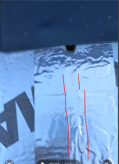

Also, this is where the 140mm boards meets at the apex, with a v shape gap - should this be filled before taping? Seems like a condensation hotspot to me!
