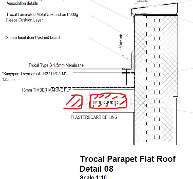

@ADLIan Is condensation the concern (presumably between the wool & board above)? @Dave Jones @Mr Punter thanks

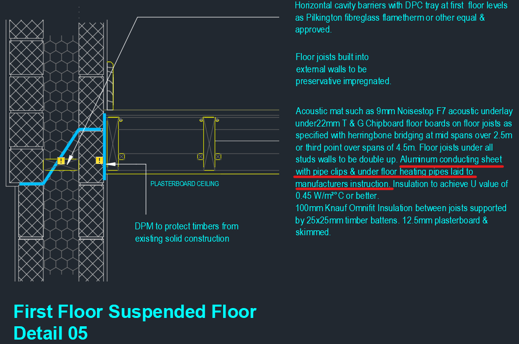

Morning folks - studying my architects drawings, and I came across this - anyone know what the aluminium sheet does (architect is ill presently, so I cannot ask her)? TIA, James
Yep, obvious when you have been told - thank you.
