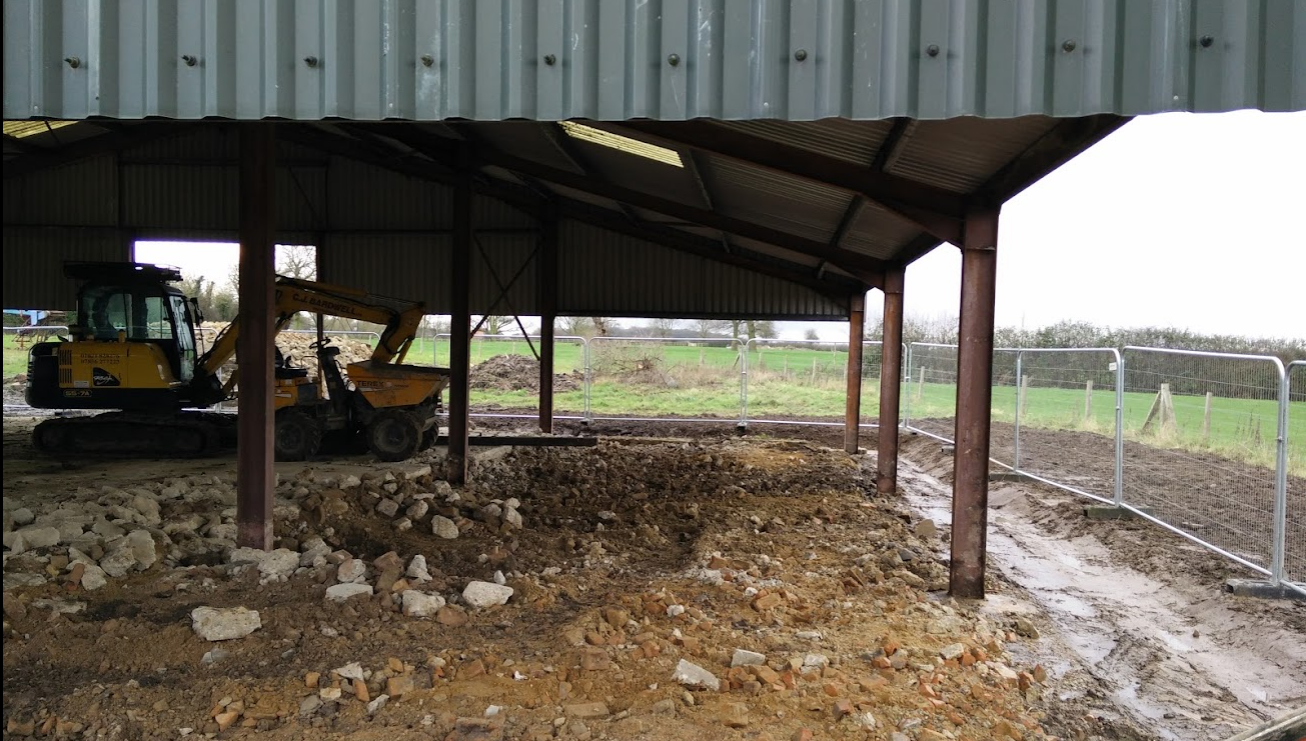

We pulled up around 500m² of agricultural slab in just over a week with a 5T excavator, pecker and a 1T dumper. We were slowed down by a reinforced perimeter ring-beam that had 30 - 40mm rebar in it and had to cut the rebar into manageable lengths. Ours was also a cowshed, so had a significant rake on the slab for slurry drainage. We'd have lost a lot of height to have mass infilled over the top and then insulated. The 5T machine broke it up quickly. I did other channels through hard-standing areas with a 1T, and that was hard going.
