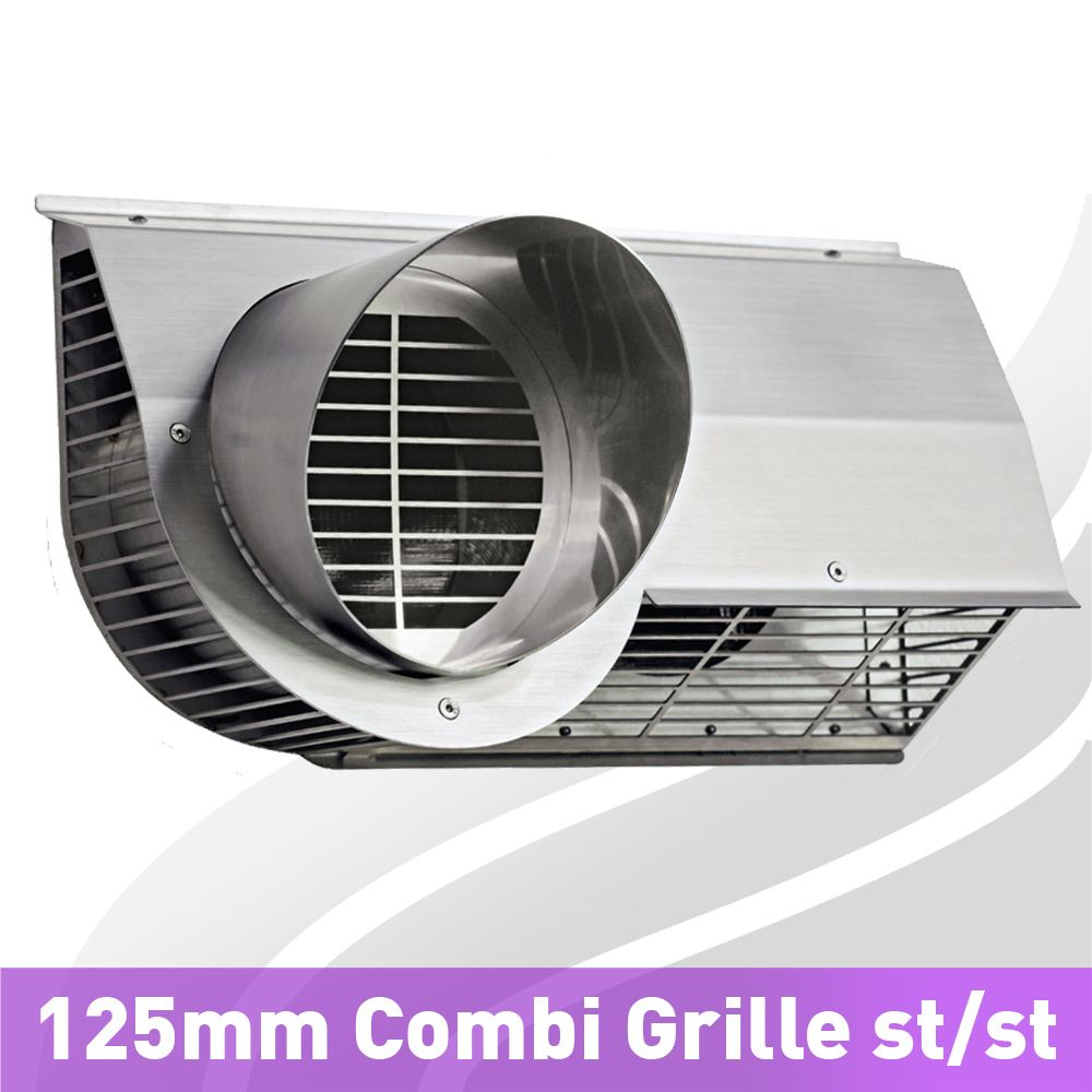

A ran for a year at minimum speed and never saw any mixing going on by monitoring temperature. Out flow is rejected horizontally outwards, inwards flow comes from below and the sides, so out flow has a hard job making it's way back in. -
New self build design, heat and architect
JohnMo replied to Jack757's topic in New House & Self Build Design
You can get from 125mm to 200mm so should cover all domestic properties. https://www.paulheatrecovery.co.uk/product-category/mvhr-ducting/terminals-external/ Two MVHR units was just simple. Our house is 25m long and to save too many long duct runs I picked up two Titon units from eBay for peanuts. I also used coanda supply nozzles to reduce and simply duct runs/length and used 90mm duct to make double runs limited. -

Not required if you use a combined/directional inlet outlet. One of our two MVHR units is in the middle of the house, the two ducts effectively go in void above built-in wardrobes to the outside wall. Our manifolds are in the same void. But it only feeds two bedrooms and extracts from two bathrooms. -
