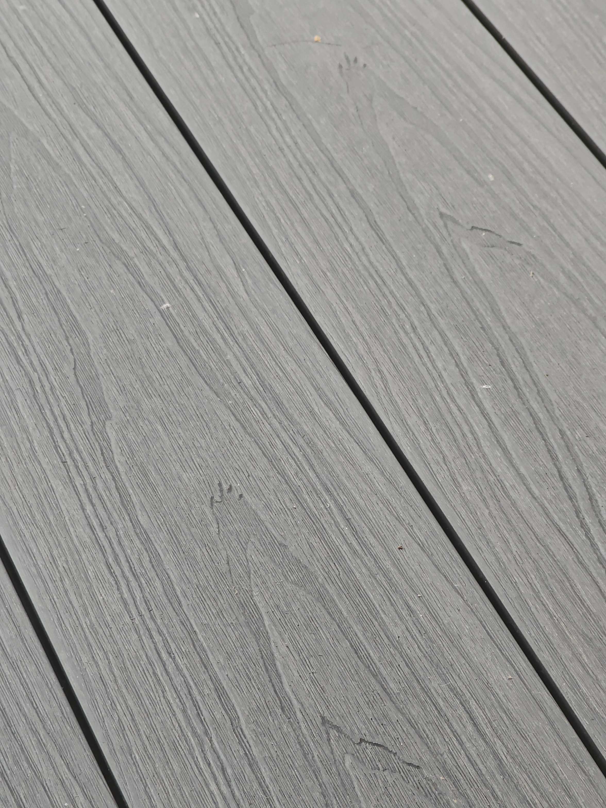

Recommendations for Composite Decking
JohnMo replied to steveoelliott's topic in Landscaping, Decking & Patios
Mine is plastic and bamboo composite. -
All true, we also have to wash a few times a year. -
We used Ultra Decking - the premium boards, zero issues, good prices and delivery to anywhere. Ours have been down for about 3 years. As with all composite boards support is important. The photos you attached look a rubbish quality board. -
