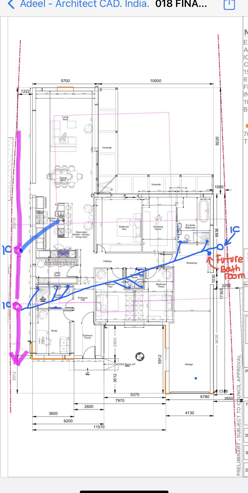

Thanks for responses. I actually share the concerns given but if I was to do a separate run for each wc for example to the main foul drainage run I then don't have the ability to rod through from the higher level which concerns me. But what I have drawn seems a lot of items on one run hence my query. Hopefully we have a drainage expert in here that might respond.
Hi. I’m looking for some advice please or comments on my under slab drainage layout. Have search the web but couldn’t find any design layouts that were helpful. I’m starting my build in about 6 weeks - a single storey (bungalow) with insulated concrete raft slab (with UFH) and ICF Nudura walls. So I need to get this right so my SE can put it on his structural General Arrangement plan drawing and my ground worker / concrete gang are coordinated. I’ve marked up on the attached layout my main sewer (in purple) and suggested under slab drainage in blue. The garage and workshop might be converted to a 4th bedroom with en-suite in the future. so I’m not sure if having 3 bathrooms and potentially a 4th on one 110mm diameter run is ok and would comply with bldg regs. I did add another inspection chamber at the end of the run to aid access for cleaning etc. SVP’s are these needed? Auto air vents behind wall hung WC’s would this suffice? Any comments please. thx Steve
