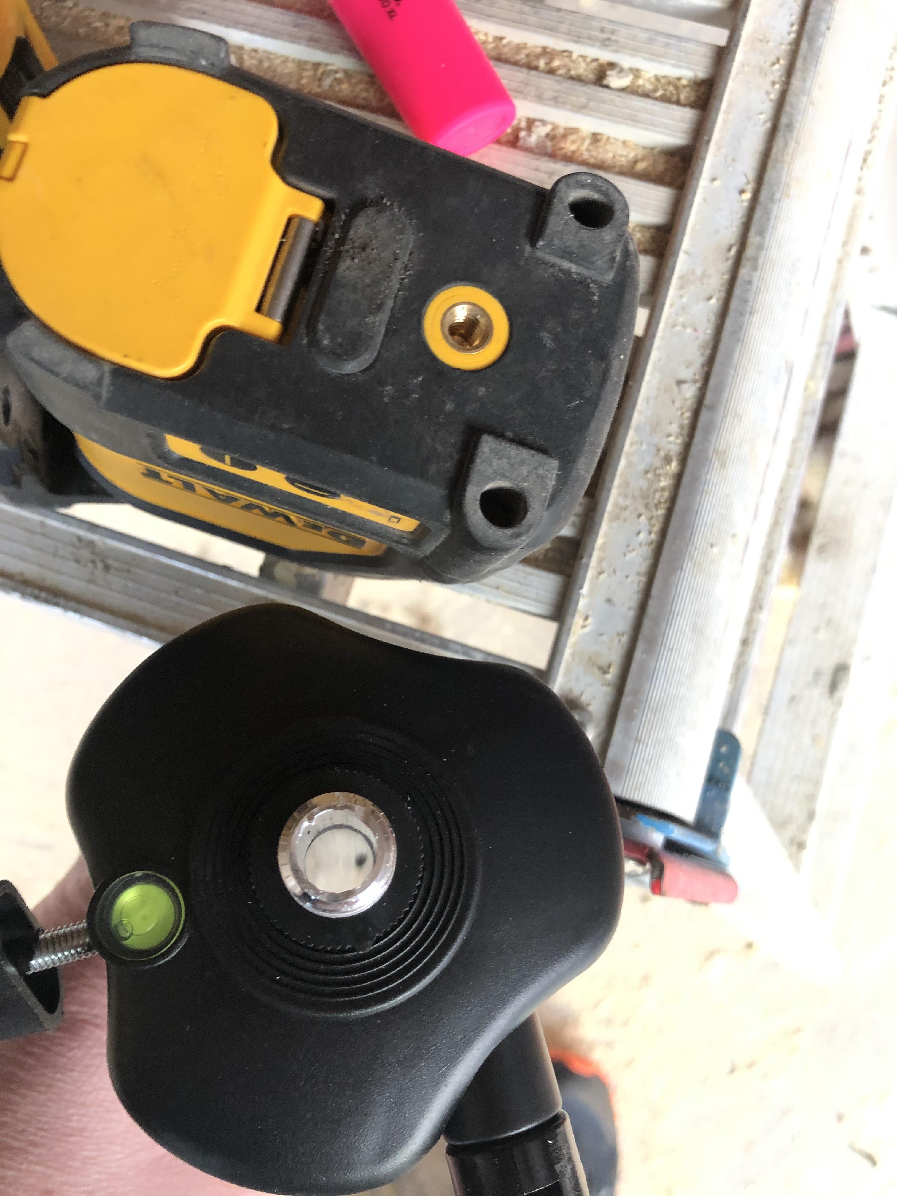

  1. Well it almost fitted! Screws into dewalt laser no issue. But on tripod stand it's too loose (must be just 1 or 2 mm out ). So erm; what should I order now - half way there! ?

  13. Yeah I think that would do the trick . Almost cost the same as the tripod ! Much appreciated though ?
  14. I bought a cheap tripod off eBay with a ‘standard’ fitting . Needless to say it doesn’t fit my dewalt laser . spec of tripod is 5/8 inch connector I think dewalt laser thread is 0.25” Can anyone point me in the direction of a thread connector type thing to connect these two ?
