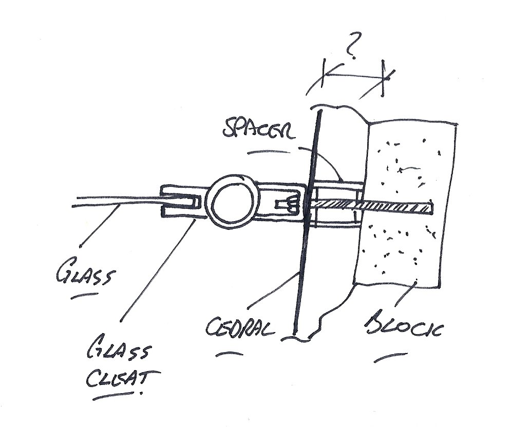

Sounds good. If fixing to the wall I think you would want any wall fixings, through the Cedral, to be in line with the glass fixing cleats? Could probably figure a U shaped cleat and get in there with a ratchet spanner. On plan something like this:
Happy to spend someone else's money help! I thought it might be local 'ish. Their previous work does look good I think. If you were looking to limit stresses from the handrail affecting the deck you could consider still having raised pads but with a subtle weathering cowl in st/st on the base of the standard.

I've had some peripheral experience with escape stair handrails on site done in stainless tube. They tend to make it in situ and dress / buff the welds on site.
Any good? Place near Plymouth: http://100percentstainless.co.uk/portfolio/fixed-faced-balustrade/#sidewidgetarea On the assumption you're going to have to buy from somewhere they might advise on the design if you bought the bits off them. I'm leaning towards 4 point fixing to the wall, raised fibreglass pads around the perimeter (with hindsight eh? ) and keeping it all "inboard" rather than face fix just for aesthetics. What's the section at the balcony perimeter? EDIT: Page 2 of the gallery on that link shows some cranked brackets. In a maritime environment Gr316 / A4 stainless is a must. Also you want to make sure they pickle the TIG welds or they can rust. If DIY'ing you might find a welder on the mig welding forum that'd be up for it. http://www.mig-welding.co.uk/forum/ I specifically searched "stainless handrail" under Projects/Architectural. Love the water twist detail: http://www.mig-welding.co.uk/forum/search/4693608/?q=Stainless+handrail&o=date
